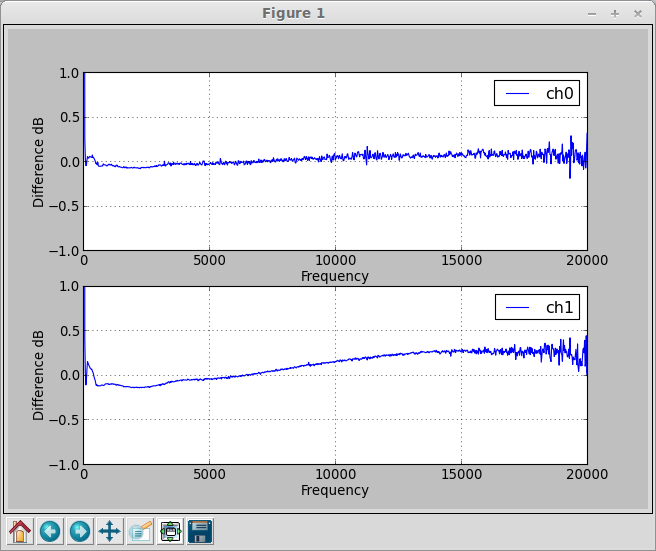

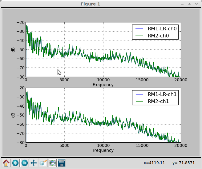

Let's take 256K samples out of the file (around the part that I used for ABX testing) and plot the spectrums.
They look similar, but calculating the difference between file (second plot) shows one channel matches almost perfectly, while the other one has more treble by about 0.25dB. The file with more treble is the one which seems to have more "ambience" or "sound stage" in ABX.
The fact that one channel matches indicates clock drift is not an issue here. So, one of the amps (or both) could have a frequency response flatness problem in one channel but not the other. This could also come from the measurement chain since channels were originally in the wrong order...
