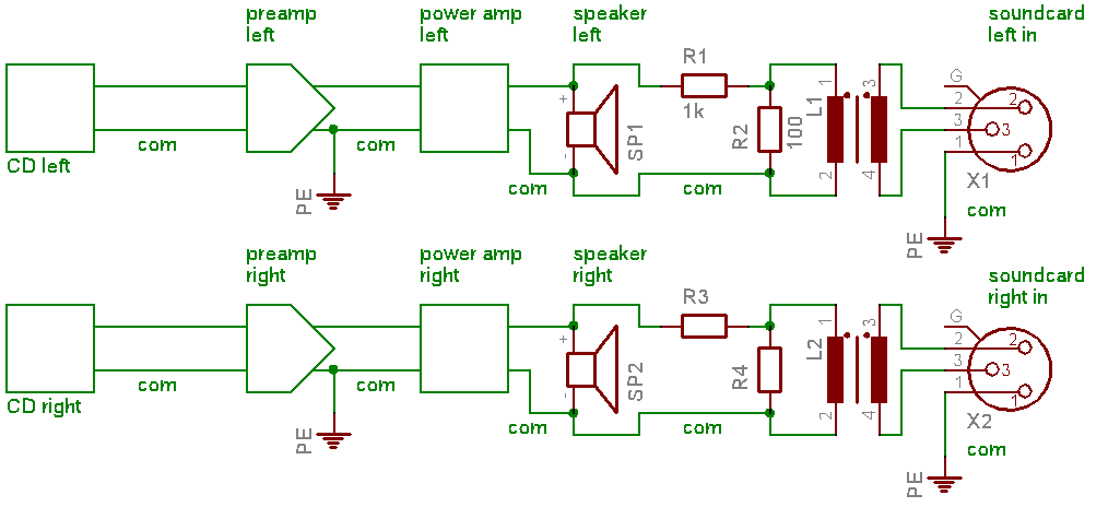

Hi Karl, I will try it very soon. It is a great idea, lot of fun. I played my file with maximum RMS output level of about 3Vrms. I wil post a test schematic.

This is the test schematic.
That is far more sophisticated than the simple divider chain and commoned grounds of my set up.

😀 I hear the noise on mine. That has to be the Dell A/D soundcard doing that because yours is audibly "silent" on playback via speakers. It seems to resolve better image wise than when I listened earlier, maybe that is just me.
