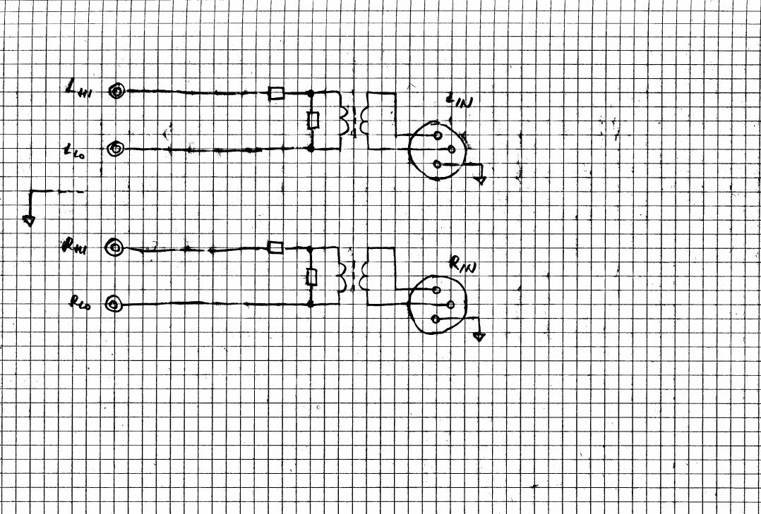

I have tried the same thing as Karl. Please feel free to download the resulting sound file
https://www.dropbox.com/s/7az52pby3ih7ul4/complete_audio_chain.wav
and I would appreciate your thoughts on "sound".
My idea is like this:
Thanks. Yes, that looks very workable and would resolve common grounding issues.
