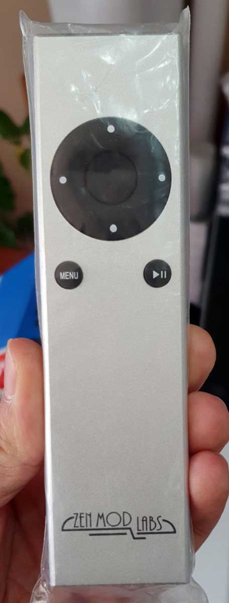

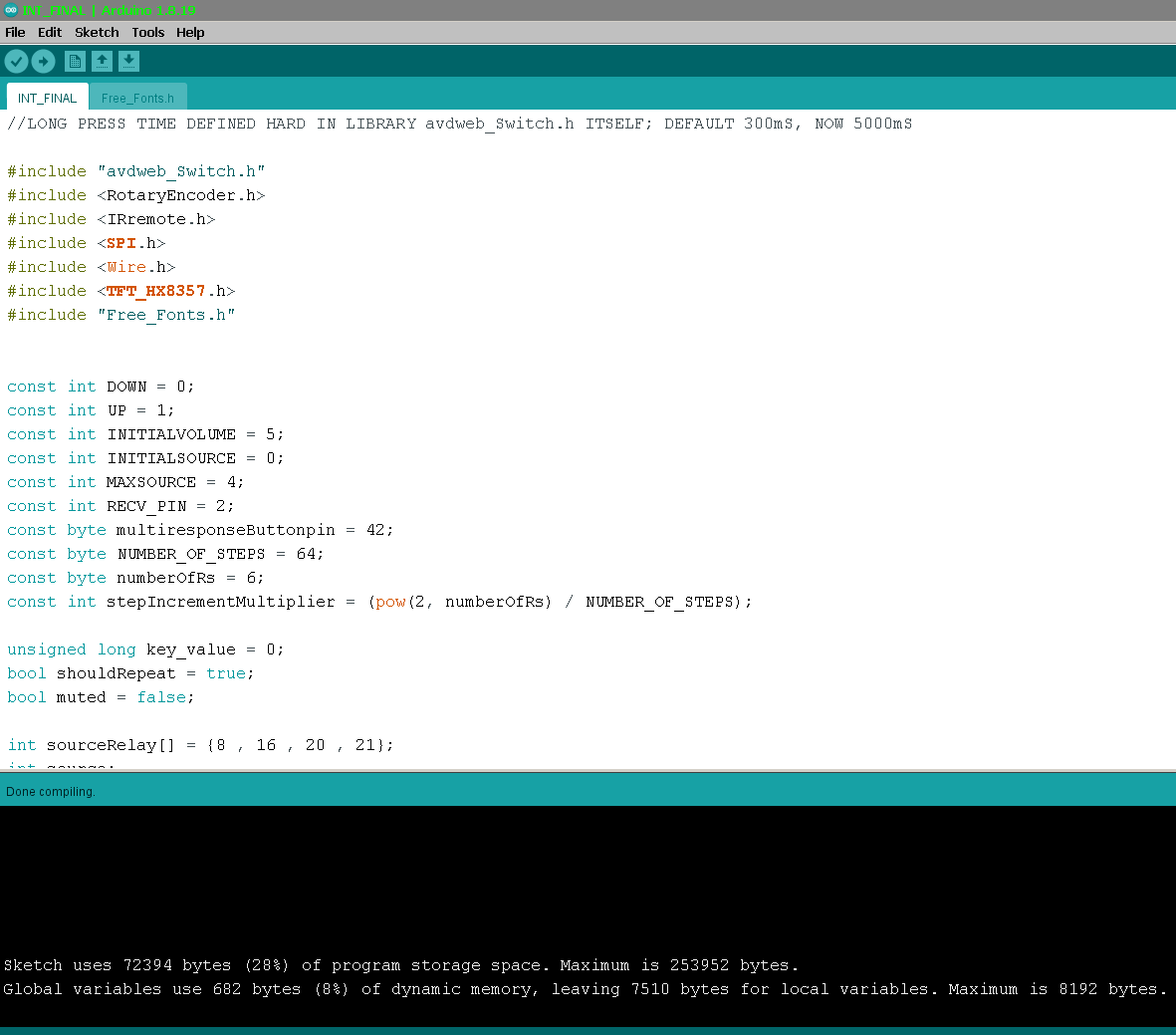

Basically - same as Iron Pumpkin Logic Module - 3.5'' TFT, Encoder, fancy Aluminum billet Remote
Arrangement - controlling 4 inputs, 64 step attenuator (2^6 matrix, resistors switched with relays), Stand-by (thus both Power On and Power Off), Mute and both separate and automatic un-Mute
Power On sequence:
-powering main PSU, screen backllight, Greetings
-main screen,enabling both inputs and attenuator relays
-un-muting
Necessary change to TFT module - rerouting backlight LED neg to low-side switch controlled with code ( no such function in TFT module, as made)
Remote having all mentioned commands (input change incremental with center key)
Encoder controlling volume, short click incremental change of inputs, long press Power function
Easy peasy, few nights needed for, basically, supplementing Iron Pumpkin Code, but changes are substantial
As always 95% of work made by Mighty ZM, while crucial 5% is tnx to my Buddy Denis Balog (Vinko @ Baby DiyA)
I'm too old for this programming Drek, however it is simple, I'm simply not native in it

Too bad. I can’t use that remote, since it looks just like my Apple TV remote. I always knew you liked Apple, even though until now it had been your darkest most well hidden secret
edit: impressive. Want and need it. Price for AVC kit changed?
