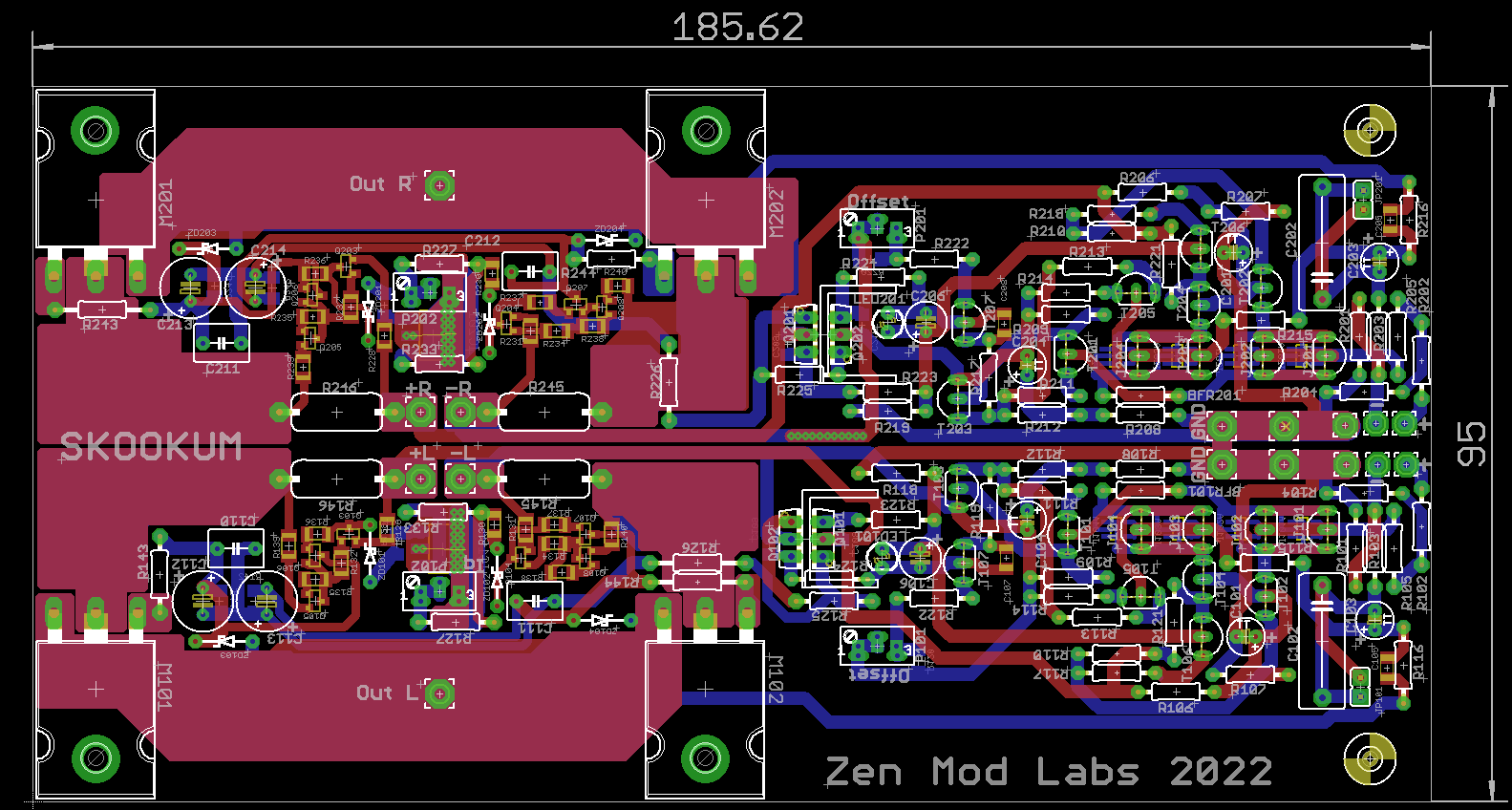

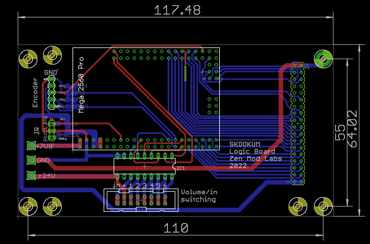

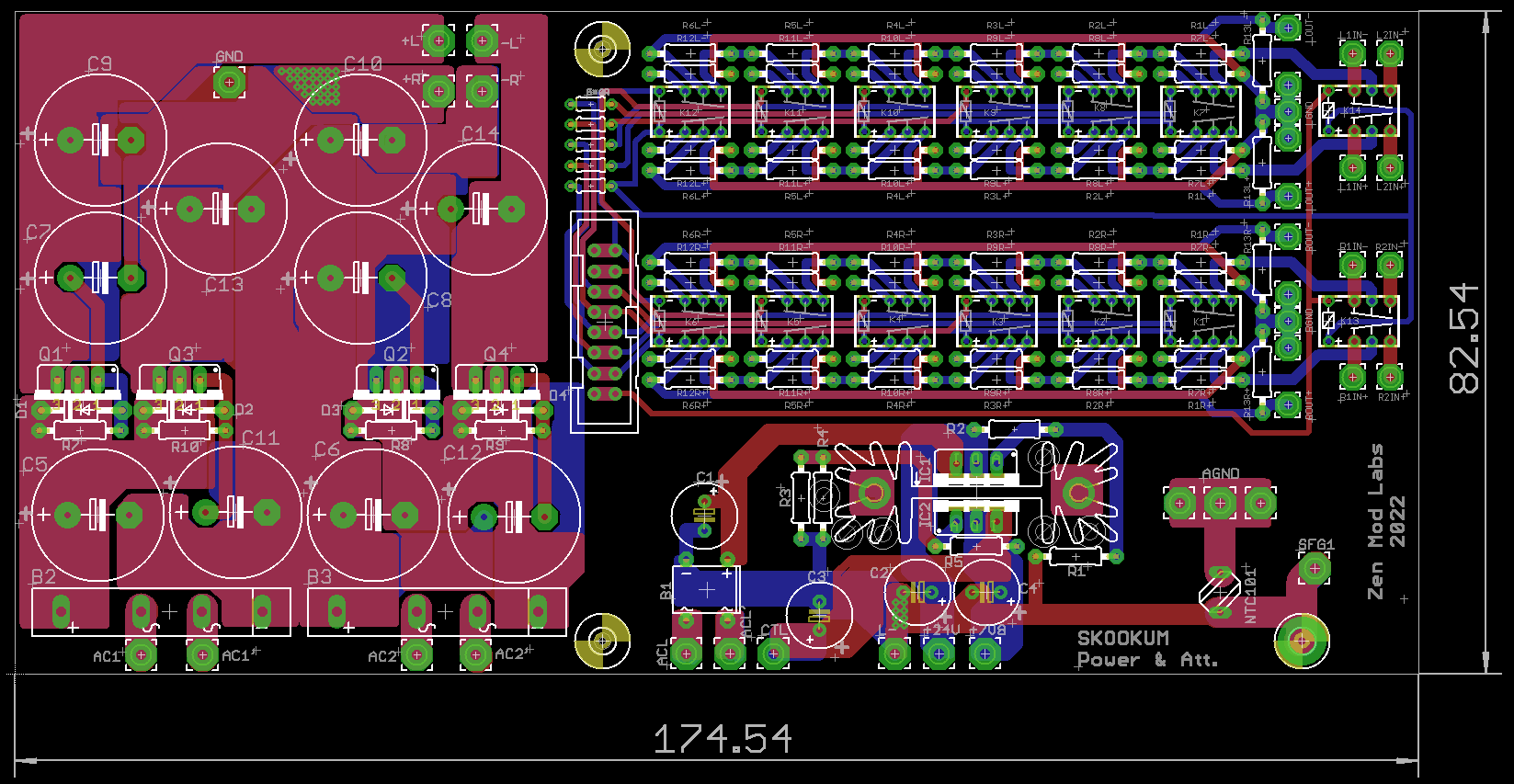

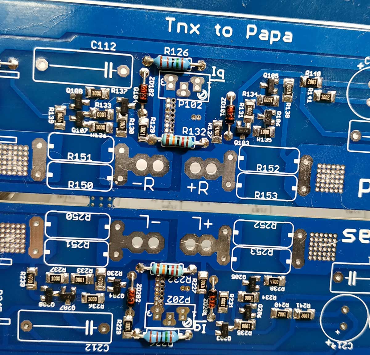

can amp, Plethora of Pinjatas minimized - under 20Vdc rails, Iq in range of 300mA
both Bal and SE, 2 inputs
sum 20W-ish of heat, common PSU with darlington cap multis for each channel, integrated 64 step attenuator, TFT, encoder, remote
intended to be situated in 200*200*100 case, one side heatsink
everyone and his uncle is making can amp, why not Mighty ZM?
:clown:
:clown:
HA!
No, I don’t mean Handy Accessory, but Highly Attractive. It’s the right amplifier for the times ahead: low power consumption and heat, enough output power, no preamplifier required, couch-potato friendly (remote), small transformer, small case, small budget and guaranteed BIG sound.

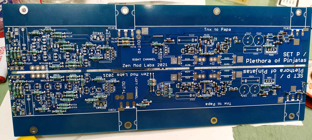

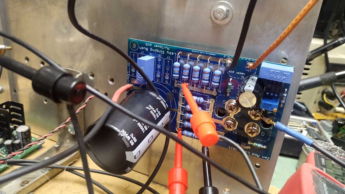

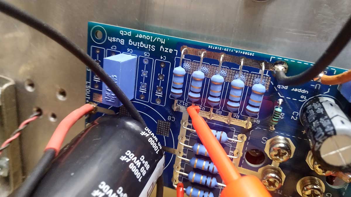

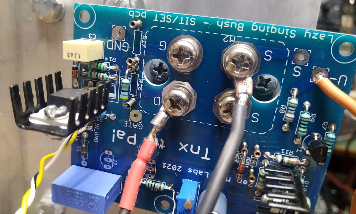

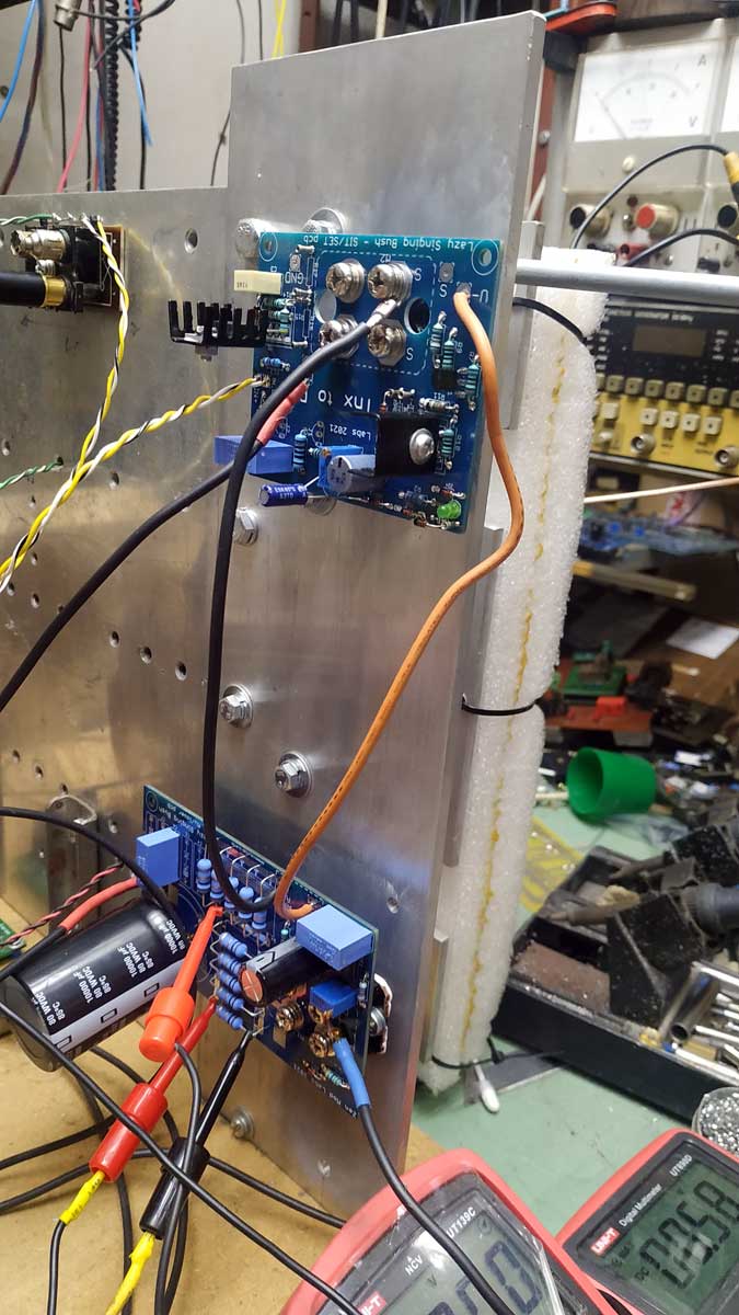

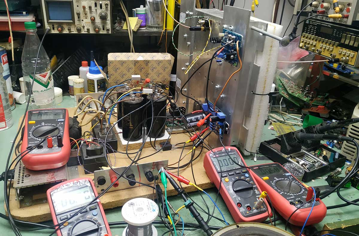

while waiting to receive Warbler and Choked Singing Bush final pcbs, started working on Lazy Brute
You can expect new thread in day or two
pure MOS for starters
what you see - it starts and bias properly, sings on scope
good enough for today .... it's evening, better to leave tricky measurements and changes (MOS-Schade-SIT(s)) , for fresh day
