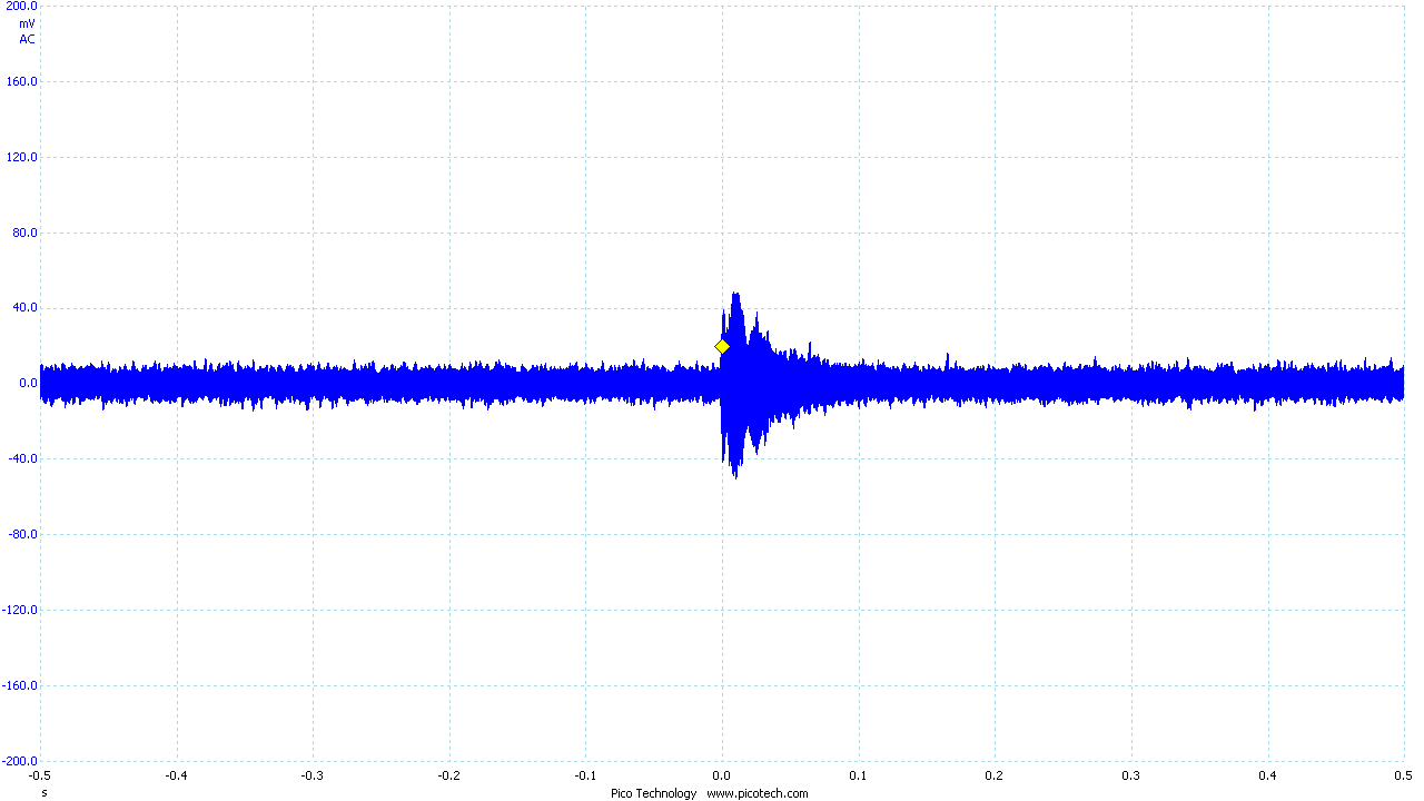

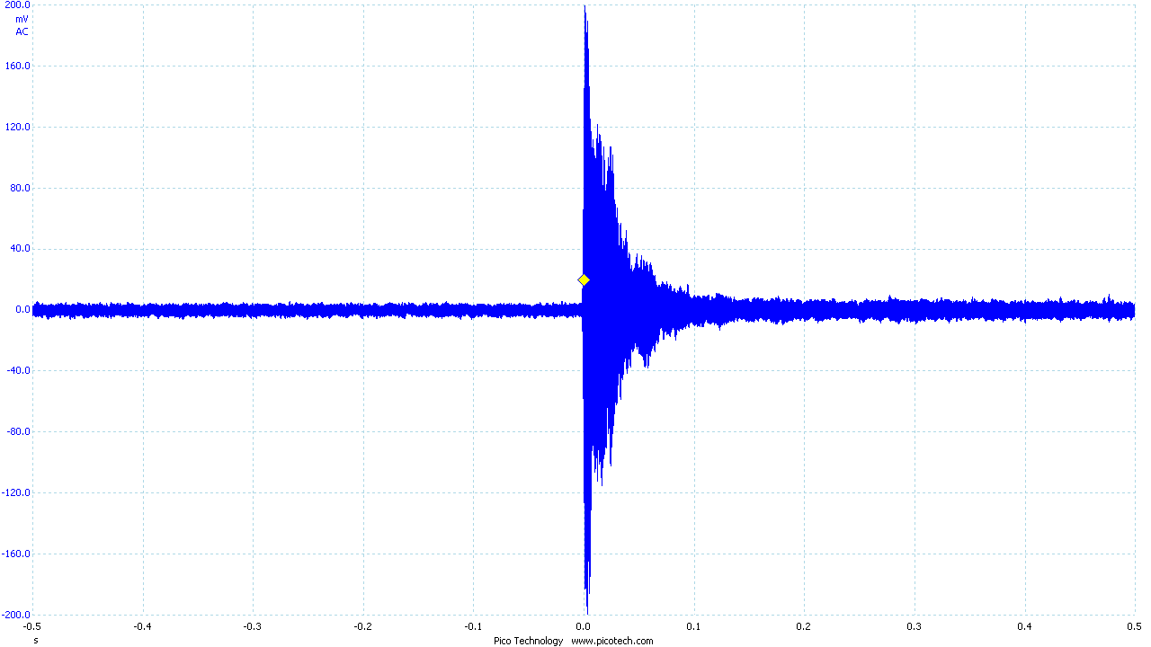

I did a simple test with the 6C45 in my noise measurement setup. I took the test circuit out of the aluminum box (in case the box is making the microphonics worse) and put it on a foam pad on my test bench, so that the bench vibrations would not affect the tube. Then I stood 2 meters away, clapped my hands, and recorded the time domain output on the picoscope.
I did the same test with a Shuguang 12AX7B, and I’ve attached the two scope plots.
The 12AX7 scope plot has a higher background noise level because the 12AX7 test circuit has higher gain, and the 12AX7 itself has about 3dB higher input-referred noise.
The 6C45 scope plot has at least 5 times greater microphonic response, even more when you consider that the 6C45 test circuit has lower gain. And there is a much longer decay time, extending off the right end of the plot. This long decay is the broad 12 – 17 kHz microphonic spectrum I noted in an earlier post.
It is difficult to do this test quantitatively, because there is no such thing as a “standard clap”. But, if anything, I clapped louder for the 12AX7, if only because it was necessary to get a big enough response to trigger the scope.
Scott

Yes, it would be most interesting to know the peak level of the claps. But I agree that there needs to be some good isolation and acoustical insulation. The simple tube dampers are probably far from adequate.
To get an idea of the peak level of the claps, I put my sound level meter on the work table, on the foam pad, and set it for fastest response time (100ms) and “peak hold”. Then I stood 2 meters away and clapped. I got readings in the range of 92 – 94 dB SPL, C-weighted. Claps have a fast rise time, so it’s hard to know if this is really the peak or not, but it gives an idea.
I’m still trying to work out how big a problem this microphonics would be in practice. I may try the 6C45 test circuit connected to my audio system, to see if I can hear the slowly decaying microphonics.

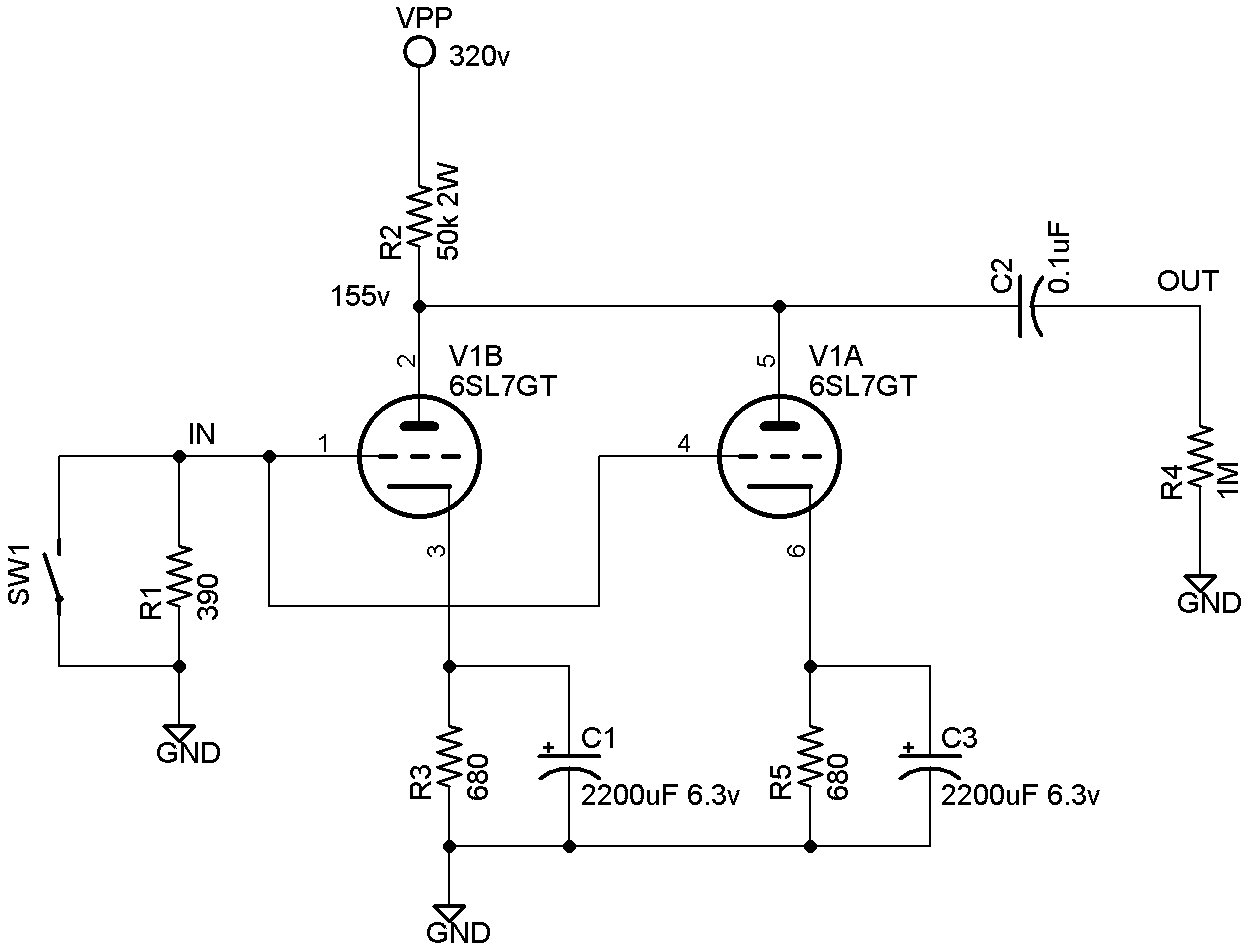

I’ve been wondering how much of the 6C45’s low noise performance is actually due to the close grid-cathode spacing, and how much is due to other features of its design and construction. The relationship:
Close grid-cathode spacing -> High Gm -> Low Shot Noise -> Low overall noise
is well established at RF, but other noise sources become important at audio frequencies, and the importance of high Gm is less certain. Many high Gm tubes I’ve measured don’t show low noise. I’m wondering if the cathode materials, cathode temperature, and cathode geometry might be more important.
The planar (as opposed to radial) geometry of the 6C45 and D3a results in large cathode and anode area relative to the current flow. Many tubes with high emission cathodes don’t have such high cathode area. Another consequence of the planar geometry is two independent anodes that are wired in parallel inside the tube, doubling the effective tube area.
As a comparison to the 6C45, the vintage (~1940) design of the 6H9C / 6SL7GT has very loose grid-cathode spacing (and low Gm) but still provides remarkably low noise.
I updated my list on our “Downloads” page to include measurements on two 6H9C / 6SL7GT wired in parallel. In this parallel configuration, the 6H9C NF improves to 5.8 dB, which is within a dB of the 6C45 performance. I also posted a close-up photo of the 6C45, attempting to show its planar geometry, for those who aren’t familiar with it.
I’ll see if the 6H9C low noise holds up when I measure more samples.
Scott
