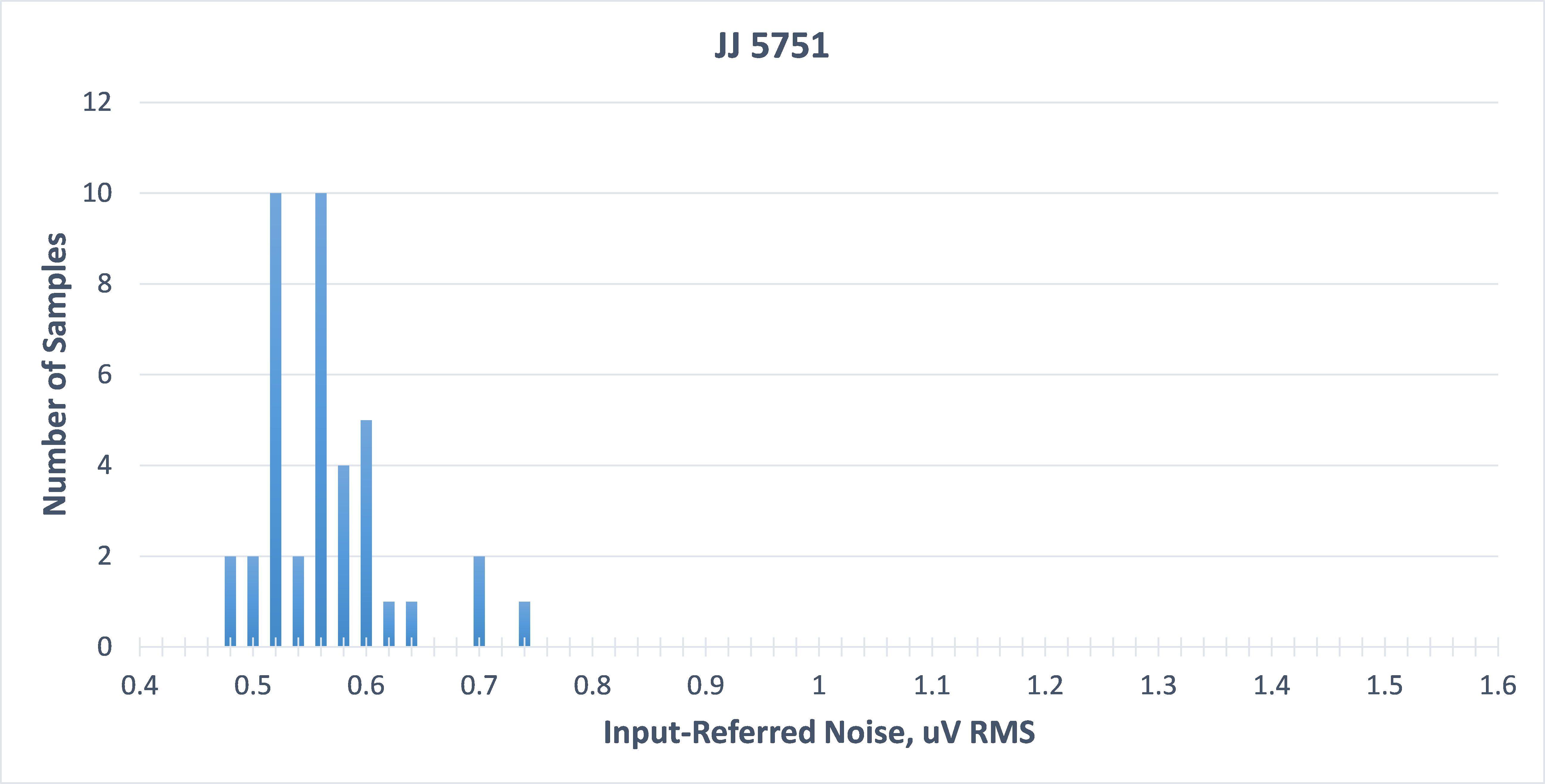

Hi Everyone,
I updated the list of measurements on the downloads page of my website to include measurements on the Russian RU-6H16 (6N16). This is a sub-miniature medium-mu dual triode, suggested and sent to me by Koifarm. Thanks Ronny, and sorry it took so long. The RU-6H16 is respectable performer, especially for a sub-miniature type, but not especially low noise compared to other tubes on the list.
I also included many more measurements of the JJ 5751, which continues to show good noise performance. There were 3 high noise tubes (which I discarded) out of the 12 new ones I measured, which is unfortunately beginning to seem like a typical ratio. I updated the histogram for the 5751, below. The histogram does not include the 3 high noise tubes.
Scott
Downloads – Tavish Design
