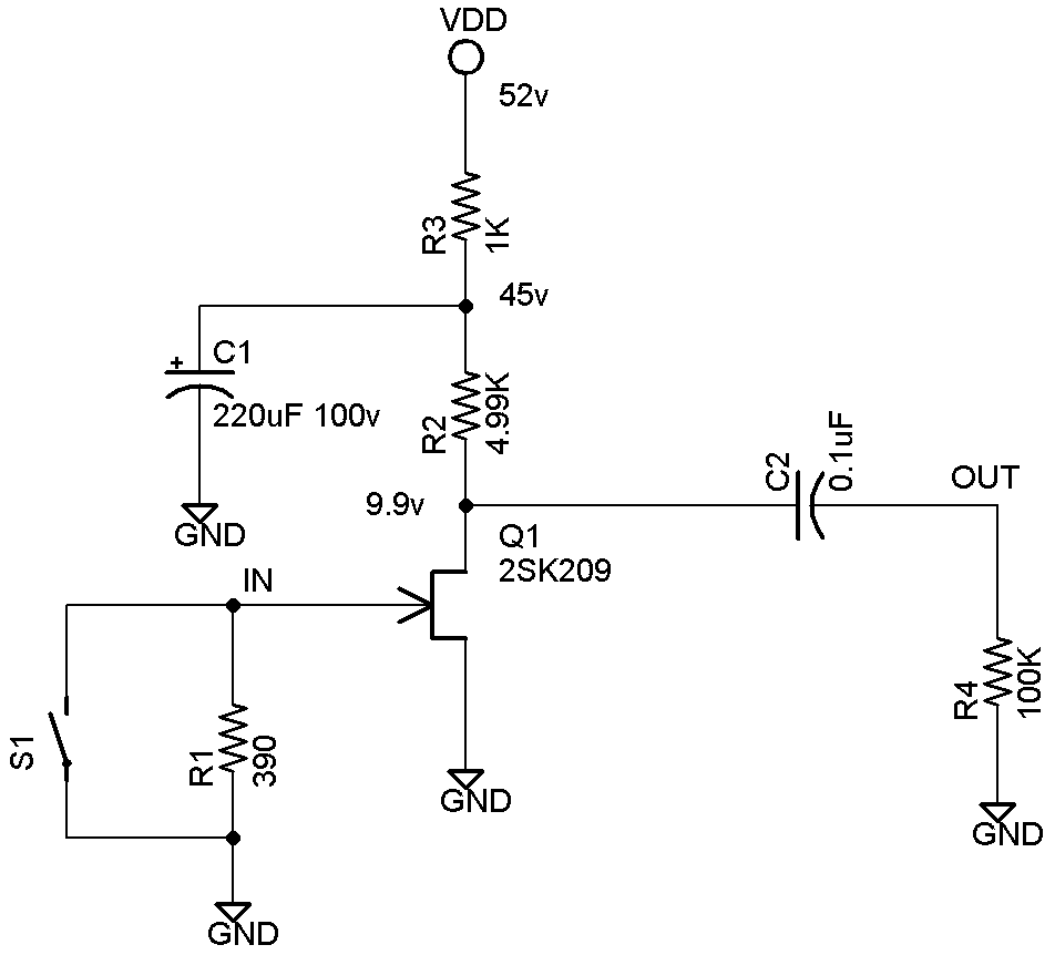

Hi Everyone,
I updated the list of measurements on our website. It now includes measurements on the Toshiba 2SK209 low-noise audio JFET, the RU-6C45PI (suggested by bcarso), and RU-6H6 (suggested and sent to me by Koifarm – thanks!).
The 2SK209 JFET is an interesting comparison to all the tubes, and it also provides a sanity check on my measurements. I’ve attached the test circuit. The 52 volt power supply is provided by six 9-v batteries in series, to avoid any powerline harmonics. The 30 Hz – 8 kHz integrated input-referred noise of the 2SK209 was 0.253 µV RMS with the switch open and 0.142 µV with the switch closed. The 2SK209 NF referred to 390 Ω is ~0.9dB, much lower than any tube measured in this study.
The RU-6H6 is similar to the JJ ECC99 in terms of gain and noise performance.

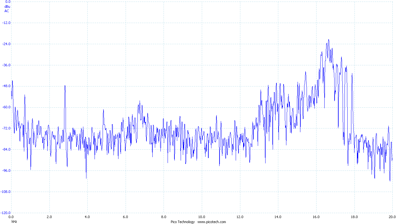

The current production Sovtek RU-6C45PI has similar construction to the NOS Siemens D3a and also displays similar very low NF around 5dB (referred to 390 Ω). My noise data does not agree perfectly with what Brad has posted on this thread, possibly because of my 8kHz measurement BW (vs. Brad’s 20kHz BW). But we both agree that it is a very low noise tube.
The 6C45PI also has similar microphonic behavior to the D3a. Measured in the same way as for the D3a, there is a distinct vibrational mode at 3 kHz and a broad spectrum from 12 – 17 kHz. There are more minor modes at 800 Hz, 4.8 kHz, and 6.8 kHz. The mode at 3 kHz and the other minor modes damp out within a few seconds, but the spectrum from 12 – 17 kHz can persist for 30 seconds or more. Only two Sovtek 6C45PI have been measured, but both showed similar microphonic behavior. The 6C45PI and D3a tubes are much more microphonic than other audio tubes in this study.
Hi SY,
Yes, I did check. It was discussed on this thread back when I first posted measurements on the D3a, and I just re-checked the 6C45. I probed all internal nodes on the test circuits with a 10X RF probe and a 100MHz analog scope, which should detect any RF oscillation up to 150MHz or so. There is no RF output from the circuit, even when touching or tapping the tubes.
The only output from the test circuits (besides the noise) follows after touching or tapping the tubes, and only at audio frequencies (and low ultrasonic).
My test for microphonics is to tap gently with my finger on the aluminum box, wait ~0.3 seconds (basically my reaction time to click the mouse), then capture the spectrum of the microphonics. You can see the spectra for the 6C45 and D3a compared in the summary on the website. I think the sharp peaks around 3kHz may be hi-Q mechanical resonance in the structure. Not sure how else to explain it. Fascinating.
What seems to be unique about the D3a and 6C45 is the persistence of the microphonics. All tubes are microphonic, but the spectra of other tubes in the study faded away much too quickly to capture by this method.

Interesting- I just don't get that sort of level of microphonics from the D3a I have on hand. Except when it was pretending to be a TV transmitter, and yes, it will absolutely be modulated by mechanical resonances as you observed.
I have an idea for a microphonics test that I'll try out as soon as I get the last measurements knocked out for a different project.
I followed -45 ringing on the scope down into the noise level, and it took many seconds. Whatever part of the structure accounts for the resonance, the hyper-close grid-cathode spacing surely exacerbates the effect. Sadly, as noted, the frequency is well within the audio band.
What was also interesting to note was the electrical output from excitations when I changed heater power in "real time".
