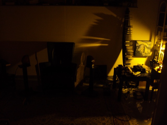

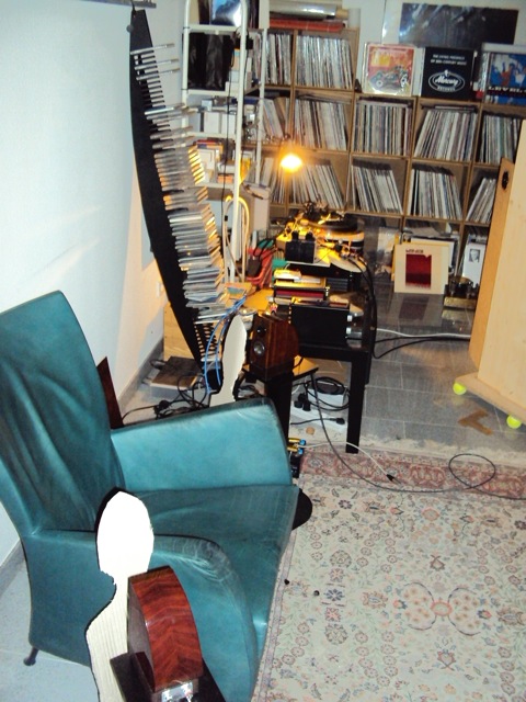

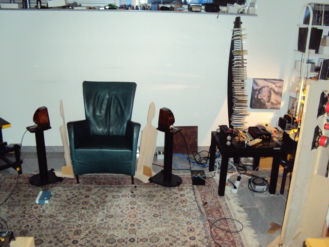

This is how it looks today. I listen to the Watsons only to check out what they spacially do.
I call the shades Ludos. They make the location of the Watsons less obvious and imaging is even better.
Lets see what my son sais tomorrow. Today he said that he could still hear the location of the Watsons although he could hear a projected, focussed image too.

Joachim,
Try pointing the Kiso's towards the main speaker instead towards you. This may remove or reduce the ability to hear them separately.
Ciao T

...or point them to the ceiling.
The bigger problem I see is the chair. How high is the back? It could create very early reflections. A chair with a lower back would be better but it would need to be moved away from the back wall or the problem with very early reflections would remain.
