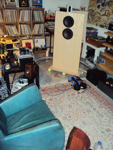

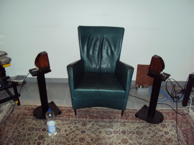

Today i set up my Watsons. I decided on the most simple implementation without delay.
I am using the Kiso Acoustics HB Mini, a gift given to me by Hara San. I set them up on a low stand so that they actually fire against my stomach. I am not using a volume control because they are of much lower sensitivity then my 95dB MPL baffles. The low stand rolls off the highs at the ears so i do not even use a filter over 2khz.
I have not listened much but listening to the Watsons alone is very revealing. There is enormous depth of image, totally free from the Watsons and also surprising width. Focus is very good, much higher then the low sitting speakers, it´s quite a party trick.
Tomorrow i will listen more carefull to a variety of programm material.

Would love to hear how the sound changes when the appropriate delay is introduced. Right now your mains probably act as "reflection generators".
The Watsons are not audible when the main speakers are playing. As i said, they are only in ca. 70cm height and they are tiny. Anyway, i have Beringer equipment that can do that in a minute.

Of course they are not audible or do you normally hear room reflections as a distinct sound separate from the direct sound? That's only going to happen when a reflection is delayed by more than 30-80ms.
In your case the "Watsons" deliver the direct sound and the main speakers act as room reflections. Both sources are melted into one sound perception with additional spaciouness because of the difference in delay and direction. See precedence effect.
