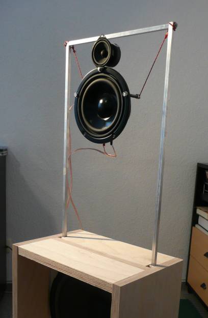

I have moved my dipole speakers nearer to my listening position. Compared to the Watson situation they are at the red positions:
I found that I can have much of the claimed Watson advantages without the added hassle. When I leave the reverberation dominated distance by moving from reclined seating to a forward leaning position, the acoustic scene narrows from 90+° to 60°, sound images get nailed at their position and details abound.

I moved the speakers closer to me. I did not only want to reduce my distance to the speakers, but to increase the distance of the speakers to some walls too. This was quite effective in lowering the "noise floor" of the reflection free zone. Apart from the floor reflection everything in the Energy Time Curve is now at least 18 dB below the impulse peak.

Probably I need to emphazise that these are dipole speakers - with the acoustic scene (AS) way behind the speakers. I would not want the AS starting at the tip of my nose, which could happen with more conventional speakers.

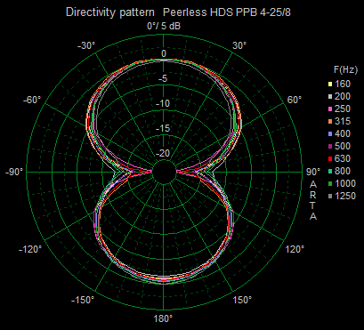

Right, moving the speakers closer.. but doesn't this contradict the dipole concept? I thought they needed quiet a bit of space to allow the dipole radiation fully. Behind the speakers, but also between the listener!
You are right for very low frequencies. Perhaps I have to lower SPL below 50 Hz for 2-3 dB. But above 500 Hz my dipole patterns are fully developed at 0.5 m distance from the driver. This may be different for big planar speakers though.Right, moving the speakers closer.. but doesn't this contradict the dipole concept? I thought they needed quiet a bit of space to allow the dipole radiation fully.

Moving closer to a dipole source, the low frequency should increase relative to the higher frequencies. If you believe you have less bass it is probable a modal effect.

It is much about keeping the direct to reverberant ratio as high as possible, yes. But you want a fair (and controlled) amount of radiation to the front wall - to keep the acoustic scene at a distance. If you can align the dipole nulls with the first reflection points on the side walls, you are almost done.

If the speaker moves closer, the distance between drivers and the baffle width could become an issue. I have tried to mount midrange driver and tweeter very close and to keep the baffle as small as possible. 😉

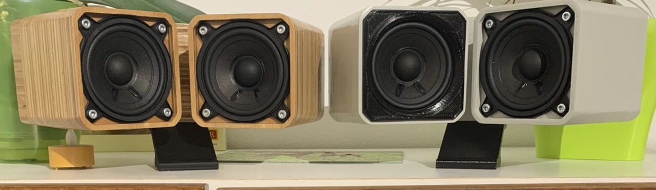

I'm having trouble finding the thread where (I think it was him) Joachim used some small Tymphony/Vifa (TC9?) inexpensive drivers on the tops of plastic pipes near the seating positon as "filler speakers"? Can someone point me to that thread, where it is mentioned which model of drivers were used?
