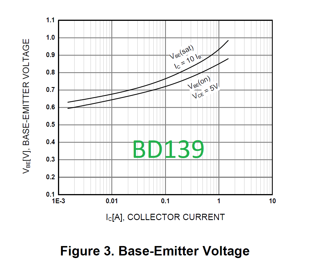

The temperature model of BD139 is probably modeled after Siemans DS which shows a drift of less than 100mv from 25 to100°C instead of 150mv. I tried the low impedance circuit with BD139 ST and BC557B, it did follow perfectly 2mv/°C. Assuming that both drivers are dissipating the same power and cooled identically, then the Vbe transistor can be mounted on one of the drivers without NTC on the other. The temperatur variations of the assisting transistor has no effect.
Agreed, from memory decreasing the emitter R below the stated value, may not be a brilliant idea.Interesting, having built a P3A i feel the urge to experiment, I also notice you reduced the emitter resistors to 0,05ohm from the original 0,33ohm is there a specific reason for that?
When looking at it I also wonder how necessary it is to use a constant current generator, the VBE variations of the output transistors would be very small compared to the total 70V supply voltage, could you just use a 12K resistor instead?

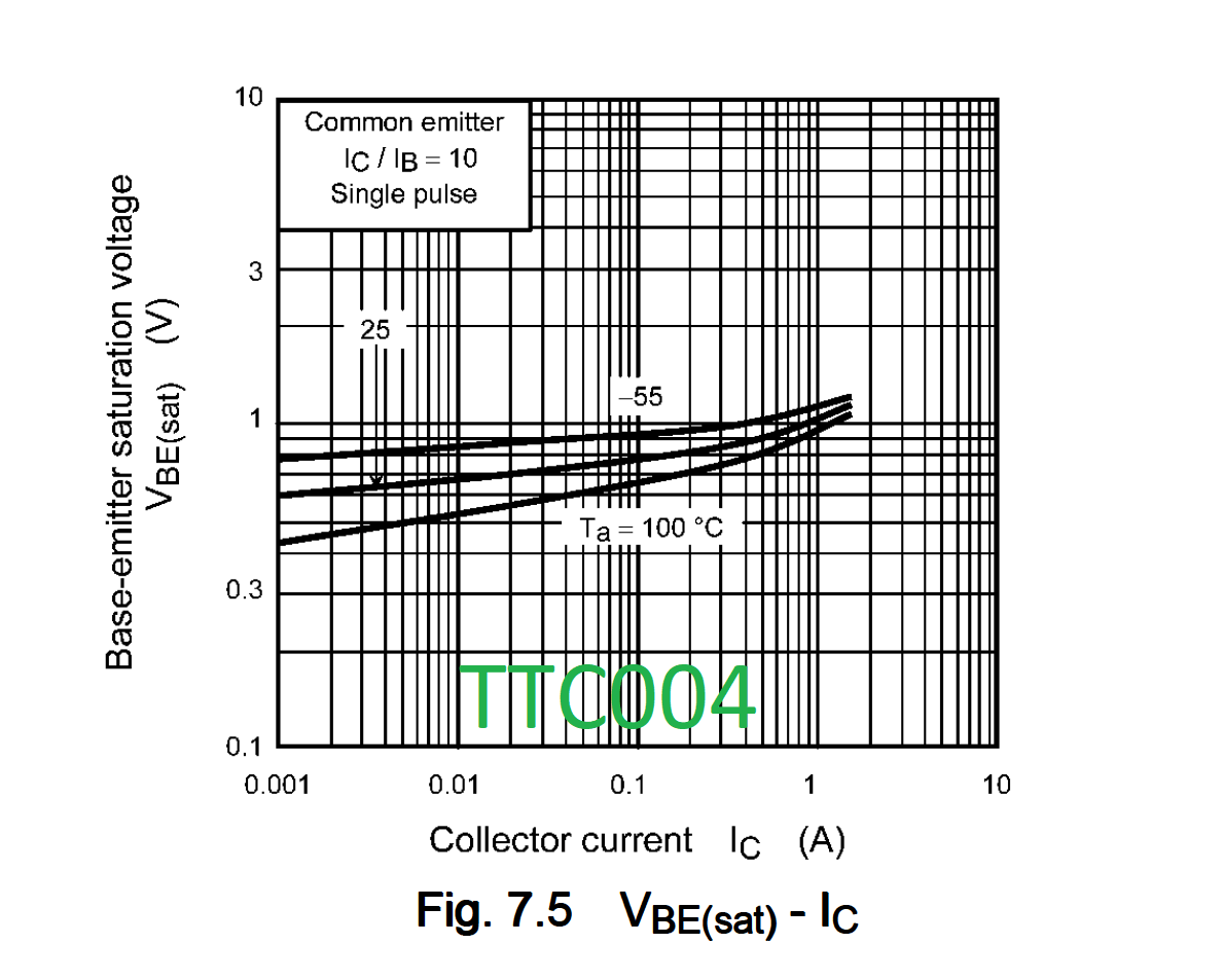

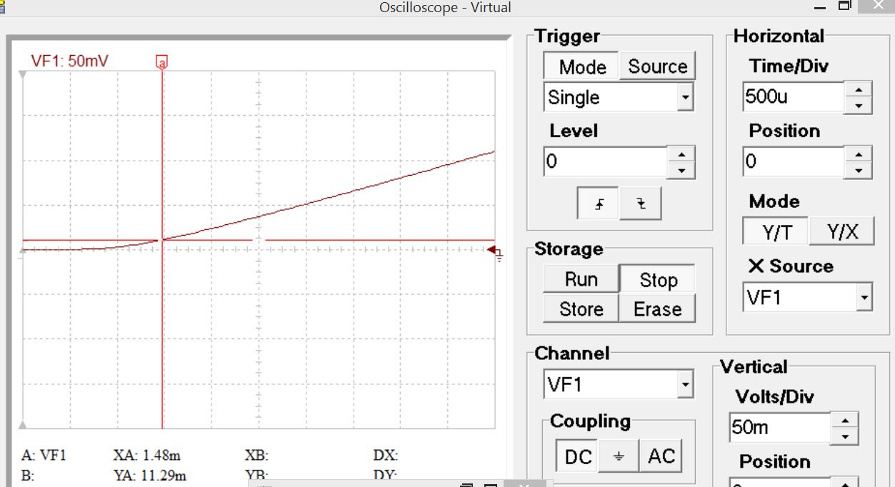

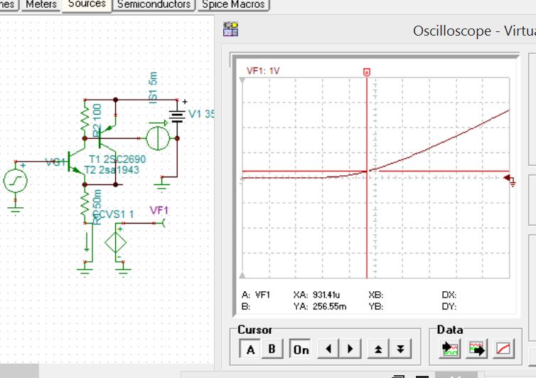

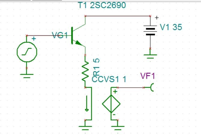

Thank you Minek, thank you very much for the 2SB,2SD models. The KS ones are the same from Onsemi, not good. I will modify the working 2690 version into PNP and adjust the parameters, maybe it work.
The TTA/TTC 004b have strange Ic/Vbe curve that doesn't resemble to square law. In linear scale an exemplary square law curve is that on the DS of C5200, whereas with Ic logarithmic scale, power becomes slope and on 2SB/2SD DS, it is perfect straight line from 1ma to 100ma. It is not the case in BD139/140 DS, figure3 Vbe(on) in pdf bellow.
The linearity of an output transistor in application depends on the linearity of the load which it presents to preceding stages. In your case your outputs are on the line between voltage and current driven by the CFP drivers. If they were only collector driven it would be pure current drive but adding the B-E resistor shifts it toward voltage drive.
Ic/Ib (beta) is a linear relationship and is much more linear than Ic/Vbe in the transistor's optimal range. Therefore driving a base with a collector is usually the most linear arrangement. However when you add a B-E resistor, the the current drawn through this resistor by Vbe becomes a nonlinear load on the driver transistor.
The extent of this nonlinearity depends on where the output transistor is in it's dynamic emitter resistance curve. If the dynamic emitter resistance is very low as in high collector current, then there will be little Vbe swing and so the current swing through the B-E resistor will be small compared to the swing of Ib. In this case we are still effectively in current drive because the B-E resistor contributes minimally to the load current swing of the driver transistor, and so it's harmonic contribution is minimal.
If the dynamic emitter resistance is very high as in low collector current, then the Vbe voltage swing will be high and the resulting current swing through the B-E resistor will be the majority of load current swing on the driver transistor collector. Because Vbe is very nonlinear, the load current will be nonlinear and this nonlinearity will be propagated backwards through the feedback mechanism and appear in the LTP differential voltage as it must drive all the proceeding stages which may be nonlinear.
The Ic point where the output transistor + B-E resistor transitions from exponential to linear sensitivity depends on Beta, and the B-E resistor value. When the dynamic emitter resistance is equal to the B-E resistor divided by Beta, the current swing of Ib and the B-E resistor will be equal (for small stimulus). Therefore:
Ic(transition) = 27mV/(Rbe/Beta)
So if your output transistor has a Beta of 100 and Rbe is 100, then the transition from exponential to linear sensitivity will occur at Rm=1ohm or 27mA.
This will also be the Ic where sensitivy drops to half. Therefore if we want our sensitivity to be the same at crossover as it is at excursions, this is our optimal bias current, because when both NPN and PNP outputs are operating at the same time our sensitivity will both added together. So at the crossover point both will be at half sensitivity, but since they are in parallel their sensitivities will add. And then at excursions when one output turns off, the other one is at full sensitivity. This mirrors the Oliver criteria for EF output stages where optimal crossover behavior occurs when the emitter resistors have 27mV bias. And unfortunately, this output scheme will have the same wiggle in it's transfer curve because it's the same mathematical function.
Earlier you noticed the NJW1302 showed more linear behavior in simulation. I don't fully trust manufacturer SPICE models, but the effect you noticed could have been because the model has very low Hfe, shifting the transition to nonlinear behavior to a lower Ic. You could replicate this effect with other transistors by increasing Rbe.
The linearity of this way of driving a BJT is very dependent on Hfe, so you can expect your results to vary as much as Hfe does from part to part. Furthermore, the tempco above the transition point depends on Hfe whereas the tempco below the transition point depends on Vbe, so now you have the wonderful complexity of having to ensure nothing bad happens in either condition. At bias your tempco will be some highly variable combination of Beta and Vbe tempco which may require individual adjustment for each build. Imagine bouncing back and forth between a tempco trimmer and a bias trimmer to get everything to line up, waiting a few minutes between each adjustment to see if the tempco compensation is good.
One huge advantage of the EF output stage is consistency and not being dependent on something as variable as Hfe.

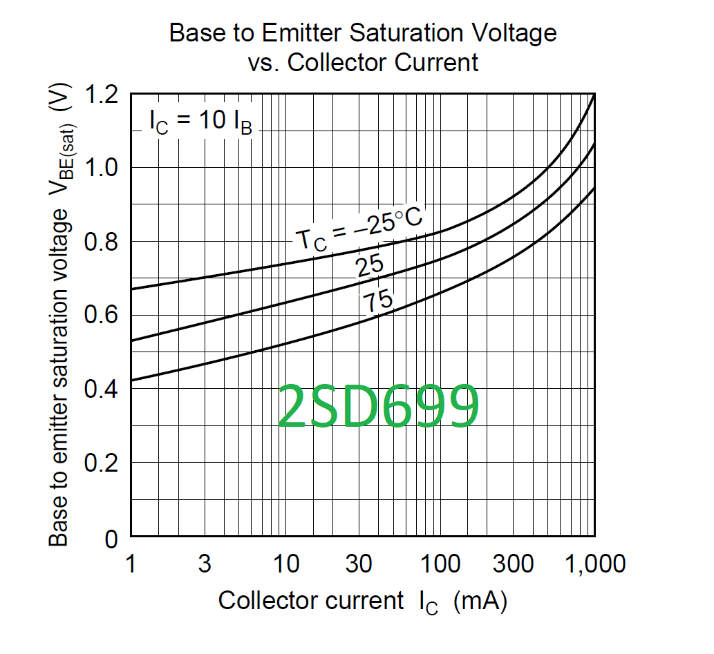

I do not understand what is strange in the TTC004 looks to be as good as 2SD699 to me, here is the Ic/Vbe curve cut out from datasheets of TTC004, 2SD699 and BD139, BD139 looks worst to me.
H
HAYK
The TTA curve is saturation curve, the figure 7.6 Ic Ib is to look at. Same for D669, it is also sat curve.
I find the concept very interesting: it is extremely simple and highly effective, unlike many similar "keep-alive" schemes.
Those schemes are either purely decorative, or worse, they add nasty artifacts of their own.
Two remarks:
I don't see why the CFP allows smaller emitter resistors: 1mV mismatch between the base-spreader and the junctions to compensate will result in the same current; OK, the number of junctions is different etc., but it doesn't seem to justify the 100 factor.
It would be nice to have the complement: this fix addresses the conduction issues, but the turnoff can also be problematic especially with BJT's. With a darlington output, a coupling of the bases with a 1µF heelps the turnoff, but in a CFP it is more complicated.
I have even tried small transformers to cross-couple the bases, but it didn't work satisfactorily.
Anyway, your scheme is a worthwhile innovation, bravo for that!
