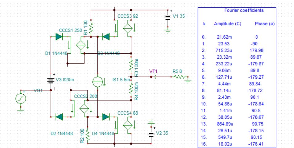

I made a piece wise model using diode and current amplifier. I adjusted the Hfe according to my measurements. Although it is dissymetrical I don't get even order harmonics at ALL.
I get odd harmonics of opposite phase. How strange!

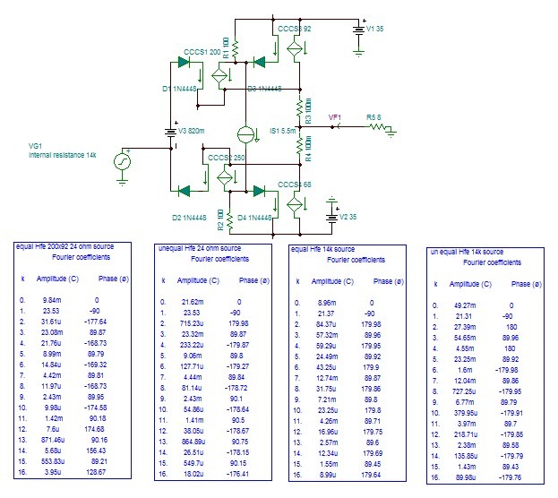

The driving impedance is 24 ohms was determined on post 67. The nested feedback by 2Mohm is the reason.
The Hfe curves on 21193_4 DS shows pnp 90 and npn 60.
Hayk,
I think even harmonics are suppressed because each half's transfer function is predominately determined by D1 and R3 (top half) and D2.R4 (bottom half). These 4 components are perfectly matched in your sim.
So the differences between CCS1xCCS3 and CCS2xCCS4 get squashed down by the high loop gains of the CFP.
If you want to model the transistors more realistically then set the 'IS' for D1 to the driver tr models 'IS' parameter divided by the Hfe. Likewise D2 for the other driver. Repeat for the power transistor diodes.

You are right, the feedback is reducing considerably the dissymetrical Hfe. I simulated for 24 ohms and 14k sources with equal and unequal Hfe shown bellow. Indeed, the even harmonics get increased but remains unsignifacant compared to odd ones. It is not the case with 14k.

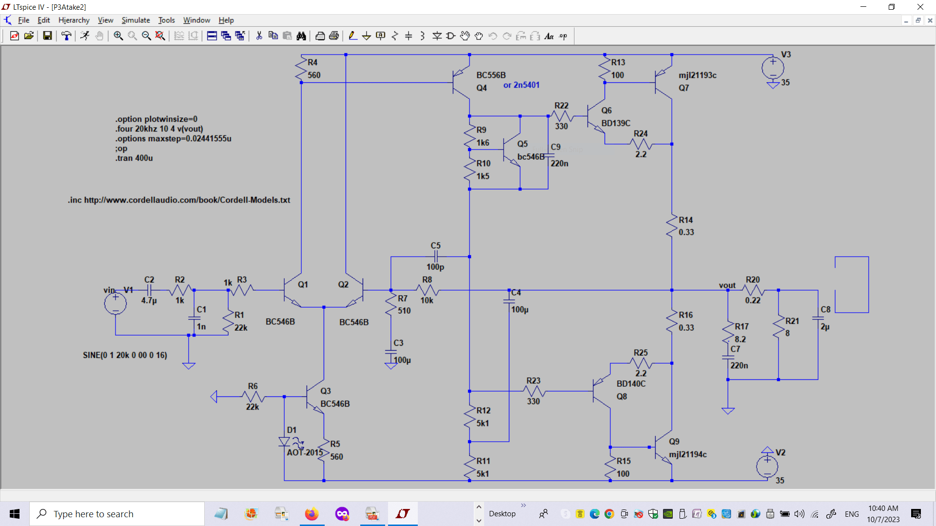

I have looked at a minimal changes version of the circuit same components with different values and a few additions.
These can be changed to suit - some of mine are arbritary I am as peckled potato (spectator) on the sideline so I will let the main players get on with the game. This should be capable of handling capacitive loads up to 2uF THD is reasonable without C8 in circuit but the FFT pattern might not be pleasing to all.. As a passing thought I had considered making this a full compound emitter follower by increasing R24 and R25 additions to 100R as this would make setting the standing current easier to do.
