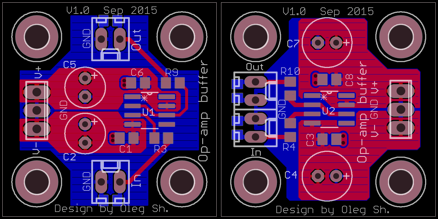

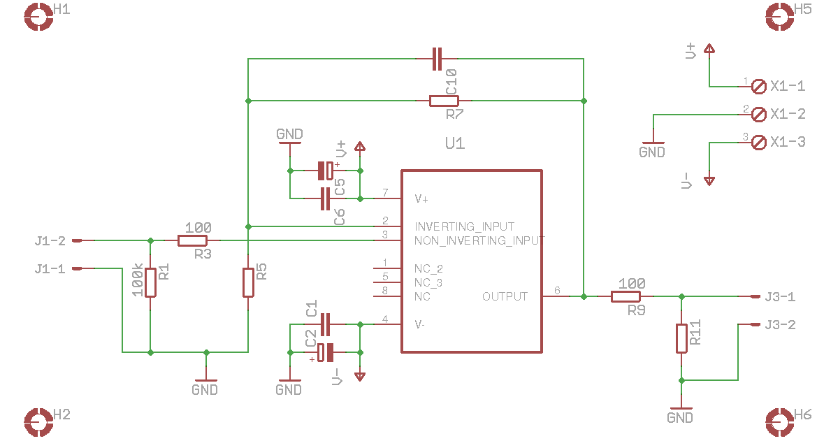

I am back with redesigned PCB. Please see attached. Please let me know if this version is at least closer to what it should look like?
Oleg

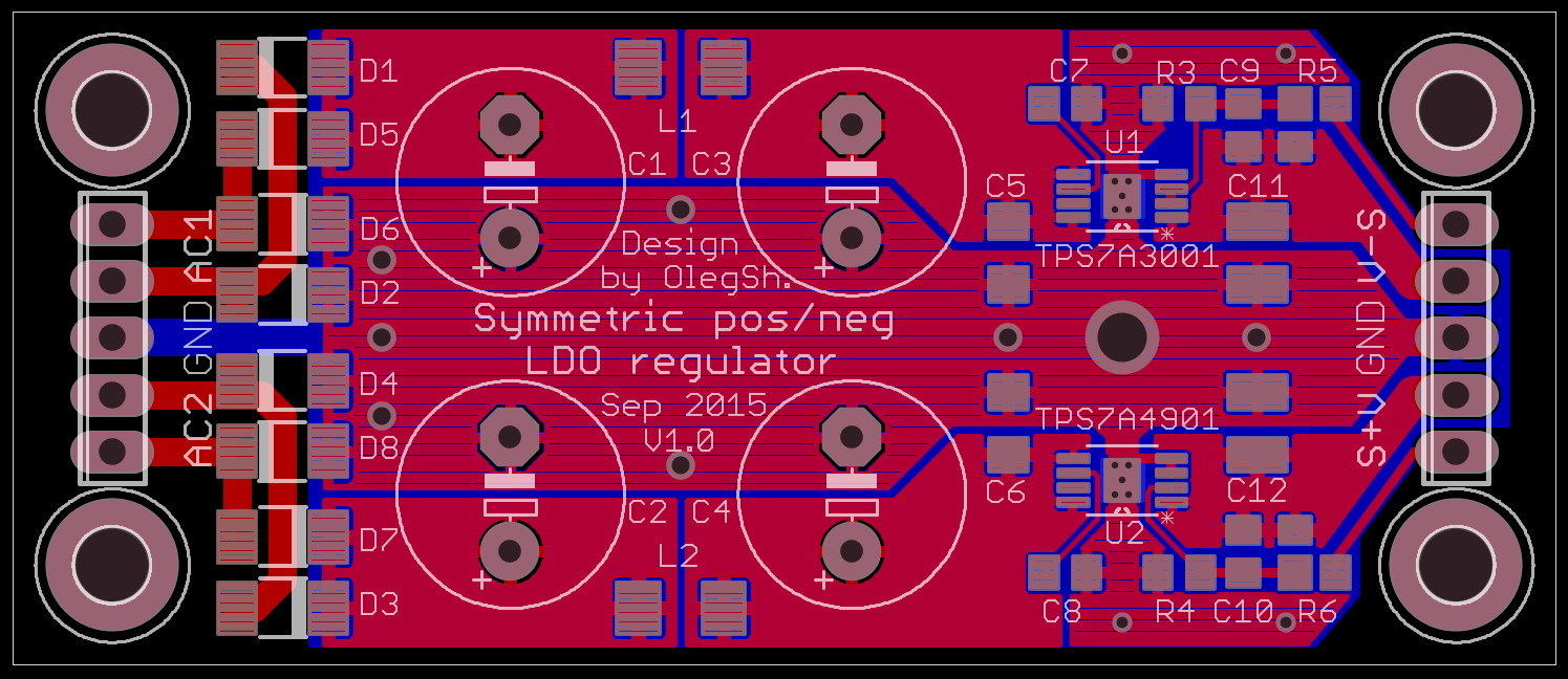

I also updated the regulator PCB (see attached). I replaced the CRC with CLC filter as suggested. The coil would have around 4.7 Ohm DCR so at low frequencies it still acts as CRC filter.
Oleg

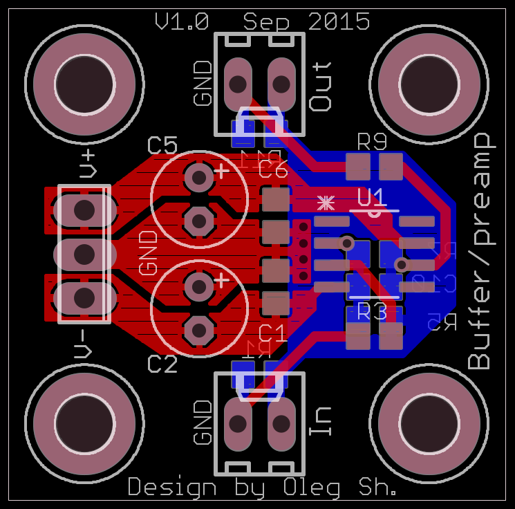

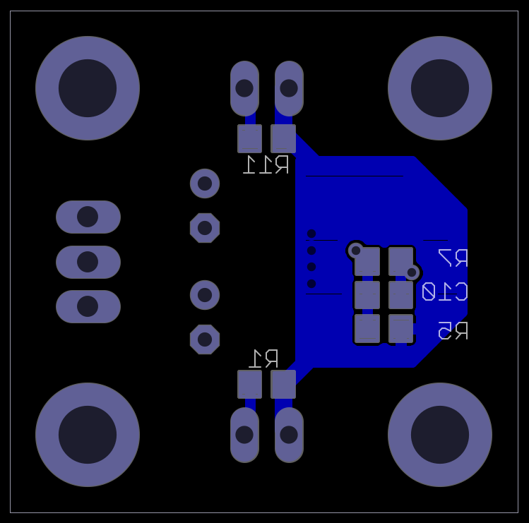

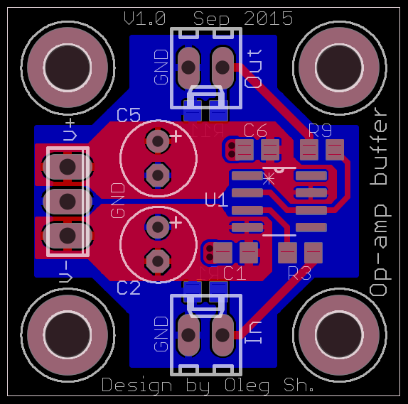

I have finally dropped the idea of extra gain and stopped at a unity gain buffer configuration. It simplified the matter a lot. Now I can use a complete ground plane. The new (and I hope the final) version of the buffer PCB is attached.
Please comment!
Oleg

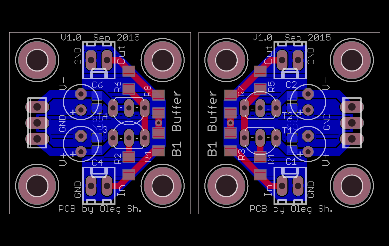

No, I did not. That is why I'm trying to complete my project. I also have designed a small B1 buffer PCB (attached) which can be used with the PSU shown in above posts but I doubt that my listening tests (assuming that all works at all) will be conclusive... but who knows!? So I have same problem as you.

Hi Oleg,
Heat is the enemy of all things, semiconductors are sensitive to heat. If you don't need to run at 18V, then don't. 15 VDC is reasonable, but if everything else is running from 5 VDC rails you could even drop it to 10 VDC without losing performance. Check the data sheet for the LME49990 to see where the performance starts to drop off and hang just above that point as long as your signal will not get close to your supplies.
-Chris
Thanks a lot Chris,
If I understood the datasheet right, the LME49990 does not show performance degradation regardless of supply voltage. So I'll probably aim at 10~12VDC, thus same supply settings will also suit B1 buffer should I decide to experiment.
Oleg

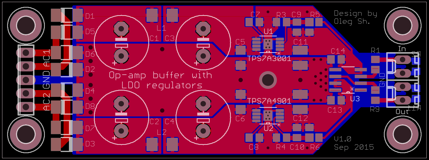

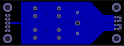

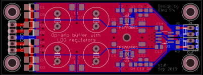

Just Married!

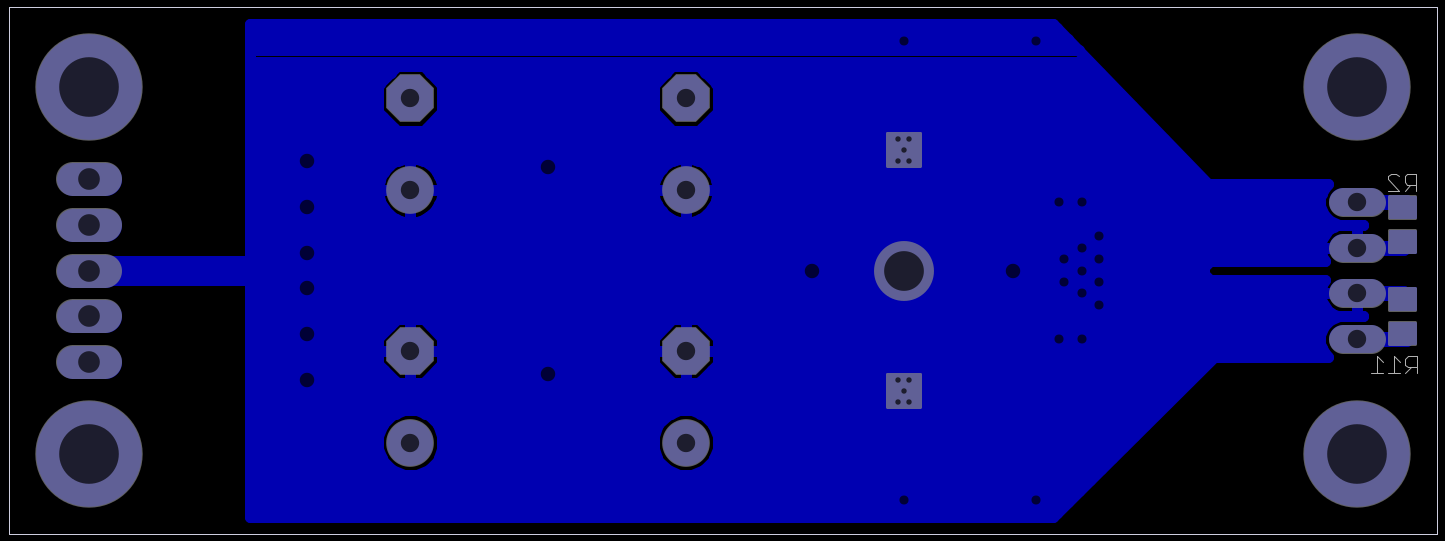

After a lot of doubts I have finally combined the PSU and the buffer together. I really like what it looks like now but it is mostly from aesthetic point of view🙂 I have no idea what kind of performance to expect from this combination but soon I'll have a chance to try it.
If someone sees obvious mistakes/problems with the PCB please let me know.
Oleg
