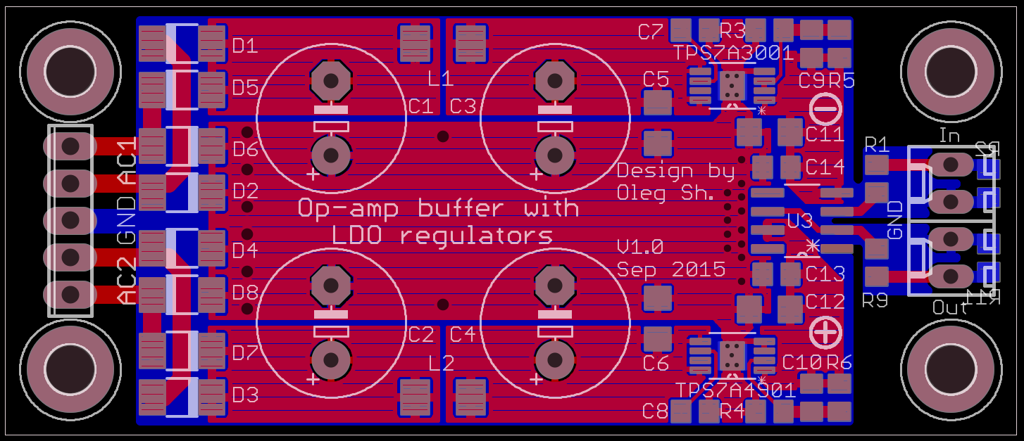

Your Power Zero Volts plane is under all the smoothing capacitors. That will keep the HF components of any fast changing currents in very low loop areas and minimise interference emanating out into the Buffer.
The Buffer has a Signal Ground plane under all the components. That too allows all the HF signals to maintain low loop areas.
I see only one cut in this plane and there are no components, nor traces, passing across the cut. That is good.
Now, since I know very little about ground and power planes, I have to ask a question:
Q, do we need to introduce a cut, or two, between the power zero volts plane and the Signal Plane, to force current flowing from PSU to Buffer to follow a preferred route?
Or do we get a good route by leaving the plane uncut?
Hi Andrew,
I asked this question to myself too. My intention was to create a sort of "star" ground under the op-amp. I initially wanted to introduce more cuts into the ground plane separating signal in/out returns and the power returns but this would shrink the connection between power ground and signal ground under the op-amp. I guess that the cut I made would force the return currents to pass under the IC and do not wander around especially at low frequencies. May be someone more skilled in the art can help to make it clear.
Oleg
Oleg

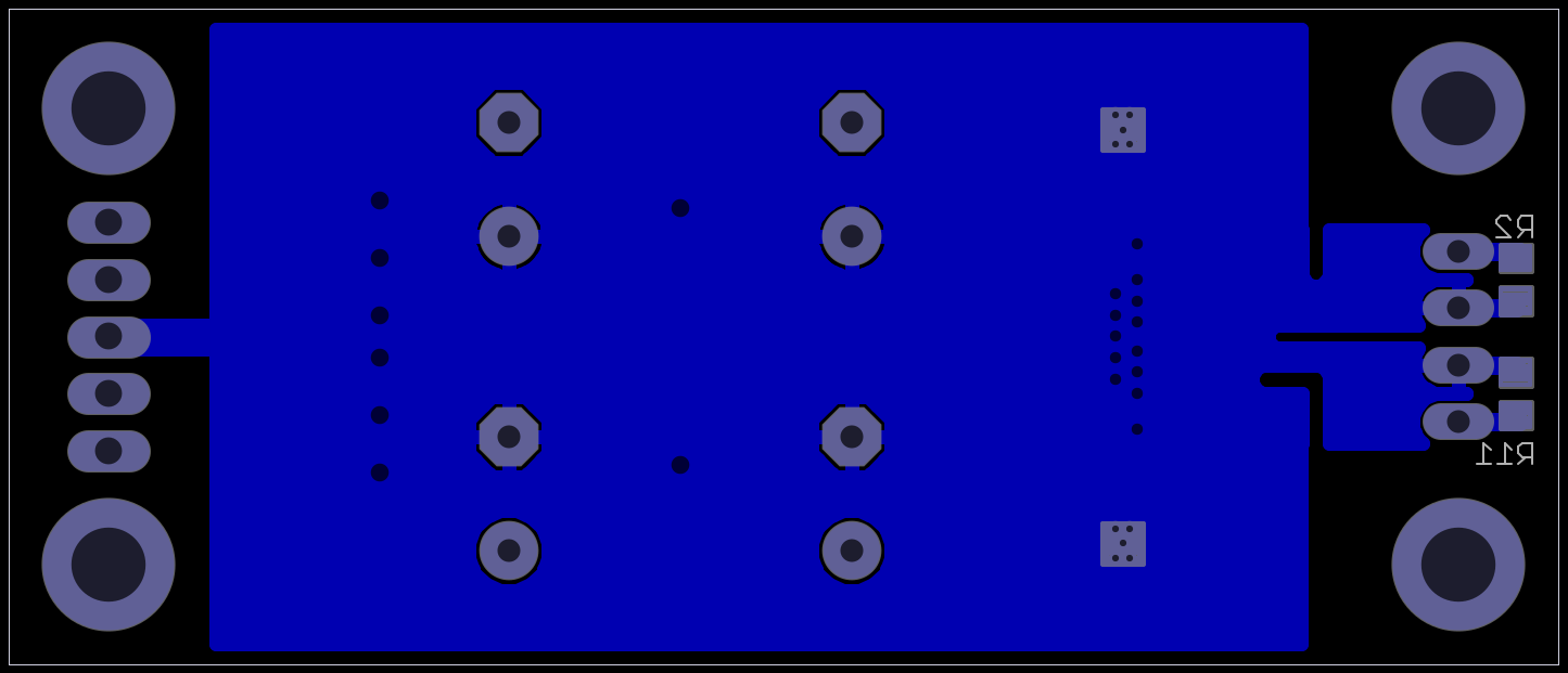

Hi Oleg,
I would extend the bottom layer ground plane to the whole surface.
Diode bridge traces will radiate much less if on a ground plane.
I would remove the upper layer ground plane, particularly in the left half of the board, it's pretty useless, IMHO.
Also I will make some cutouts on the groundplane between smoothing caps.
I will post later some examples from commercial gear.
In the right area I will, instead, create a signal ground plane and join it to the main ground via a resistor or a ferrite bead.

Hi Dario,
Thanks a lot for the tips.
I will extend the ground plane under the rectifier diodes as you suggest.
As for the top ground plane I think it should be there because of SMD parts on top which connect to it. I would not like using via for each SMD cap. The through hole filter caps effectively connect to both sides of course. I would say it should not harm having it.
The cut outs in the ground plane are not so clear to me. I'll wait for your examples.
Connecting signal and power grounds using a resistor does not sounds right to me. Ferrite bead - may be, but both increase an impedance of the current return path which as I read here and there is a bad idea. Could you please give an argument why it is good and what benefit should I have from doing it? In principle in my naive thinking ferrite beads belong to power lines, IMHO.
The last argument is a bit confusing. The board size is relatively small (3x8 cm) and the distance from the 10uF ceramic cap (at the output of each reg) to the op-amp is around 1 cm and there is another pair of 0u47 caps at the power pins of the op-amp. Is it still too far?
Also using power traces instead of power pours/planes would increase the power lines inductance and reduce the extra capacitance. The extra capacitance between power and ground planes is typically attributed as positive while lower inductance makes the 10uF caps "closer" to the op-amp, IMHO.
But I'll think on moving the op-amp closer/between the regs anyway. It should in principle fit without making the board wider and it can also make the board shorter which is a plus.
You're welcome.
Fine, use the whole surface of the board.
I'm not suggestig to necessarily remove thee whole upper ground plane but the part on the left area of the PCB.

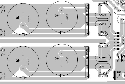

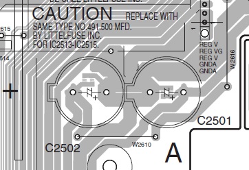

These examples are not a ground plane but they illustrate what I'm referring to.
Note that you can't implement them without the removal of the upper ground plane in the smoothing caps area.

I modified the PCB. Thanks to Dario's suggestion it is 1 cm shorter now.
The capacitors C11 and C12 can be tantalums (1206 size).
I guess the design is approaching its final version for now.
Oleg

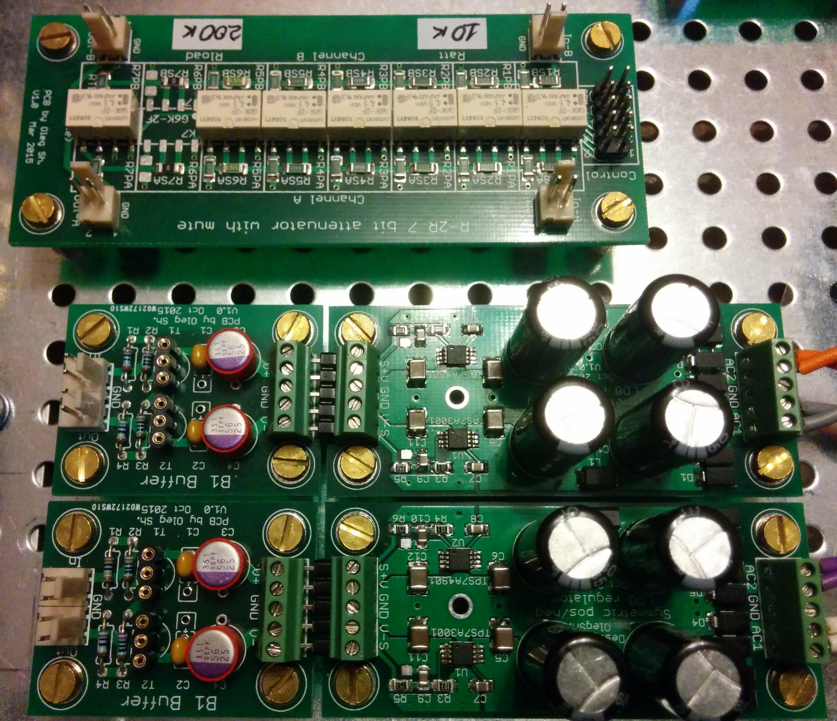

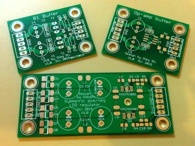

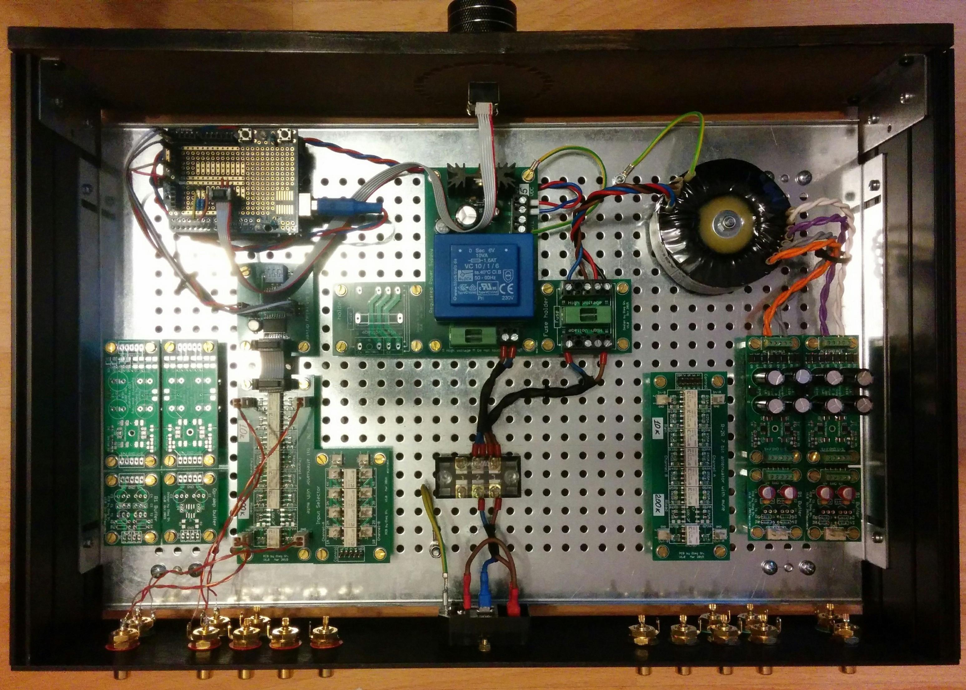

Slow progress...
I have finally found the time to assemble some of the boards.
Burned one PSU board with regs while learning how to use solder
paste and hot air re-flow station. Thermal pads are a bit tricky
to solder. Let's see if the one which seems OK is working.
The K170BL's are matched pretty well. Got them from e-bay as
a matched octet with Idss ~ 7.41mA (+-1/%), retested by myself
and one appeared to be a true outlier. Still have enough good pairs
for 2 buffers.
Next comes the PSU test and LME49990 boards...
Oleg

Progress
My formerly passive preamp is slowly going active...
The regs are working. Can't say if they are as "silent" as they should be. The voltages are set to +10V - 0 - (-10)V and I get +10.00V - 0 - (-10.04)V on the output. The difference is probably due to the slightly different Vref for the neg and pos regulators and I used the same voltage setting resistors for both. I guess it should not be a problem. Next is to stuff the K170BL's into the sockets and listen. The left side of the preamp is currently in use in my system as the passive volume control. Will see how the active side using B1's would compare... Then LME's... then final decision and then the front panel design🙂
Oleg
