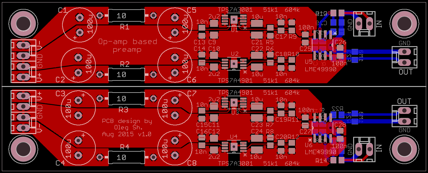

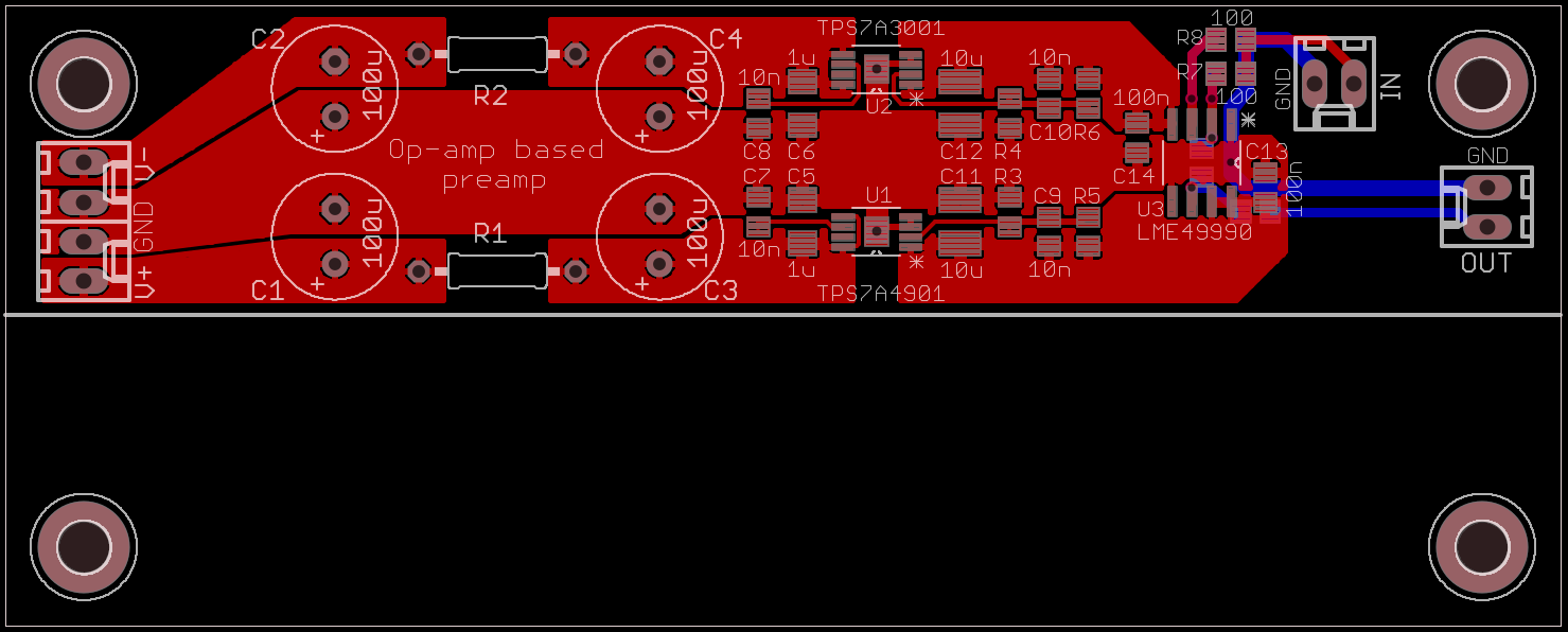

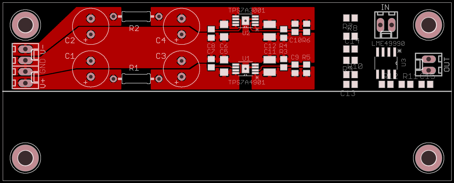

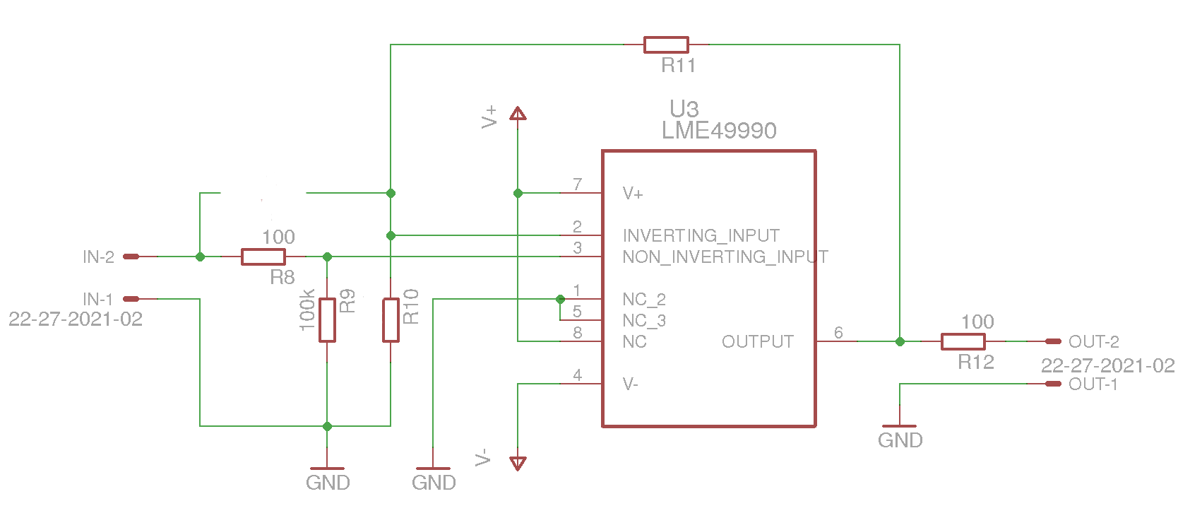

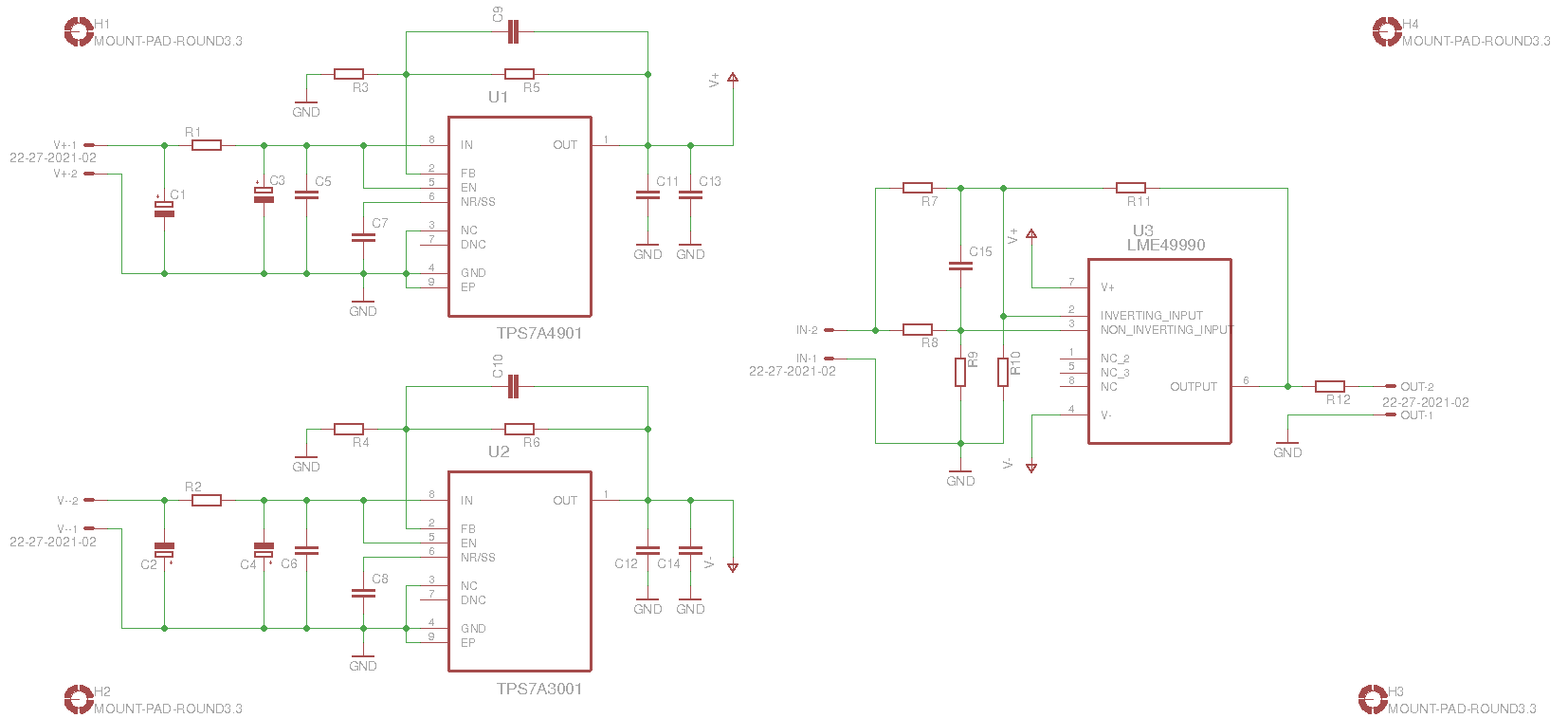

First PCB draft
I have played with the schematic and the PCB layout. So far only the PSU section is routed (see attached). I have followed the evaluation board layout for the TPS regulators. The resistors R1 and R2 are just placeholders. Most probably I'll place there the common mode filters or the ordinary inductors.
The pre-regulators will be off board.
The entire PCB is 10x4 cm and has the footprint of my R-2R attenuator PCB (mount holes, IN and OUT location). The plan is to make it dual mono. So far only one channel is in progress. The other will follow. Don't be confused by the amount of resistors around the op-amp in the schematic. Not all will be used at once.
If someone sees an obvious or not so obvious problem with the regulators layout please let me know.
Oleg
Hi Keruskerfuerst,
Most probably the layout that you see made you think I need an education in the PCB design... which is 100% true. But could you please be more specific? So far I did not do anything fancy, just more or less copied the layout from the TPS7A49/30 evaluation board from TI. I followed their suggestion not to use vias and place components on one side of the PCB. The op-amp is not even routed yet. So the local decoupling etc is not there. May be in the schematic I should have placed C13/14 next to the op-amp supply pins but I will just do it on the PCB... Anyways, I am learning by doing and I do read about the subject... but may be not enough. I do not try to pretend to know the thing... and I am trying to follow advice as good as I can.
Any suggestion which helps to improve the design?
Thanks,
Oleg

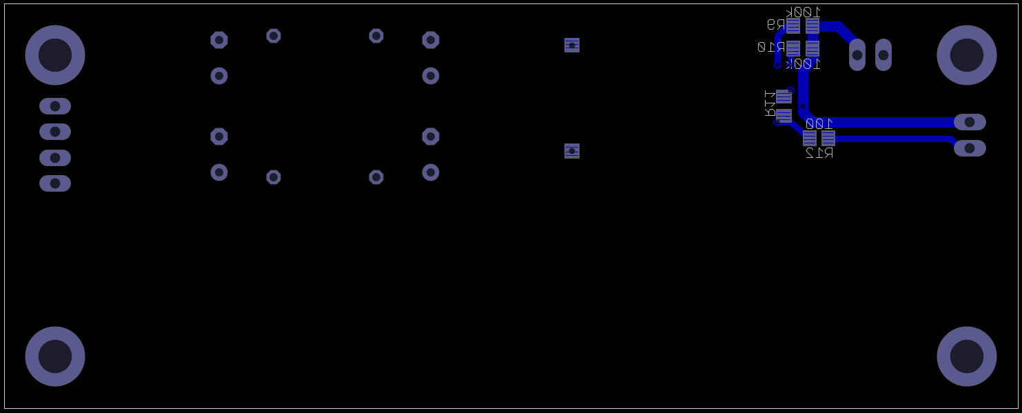

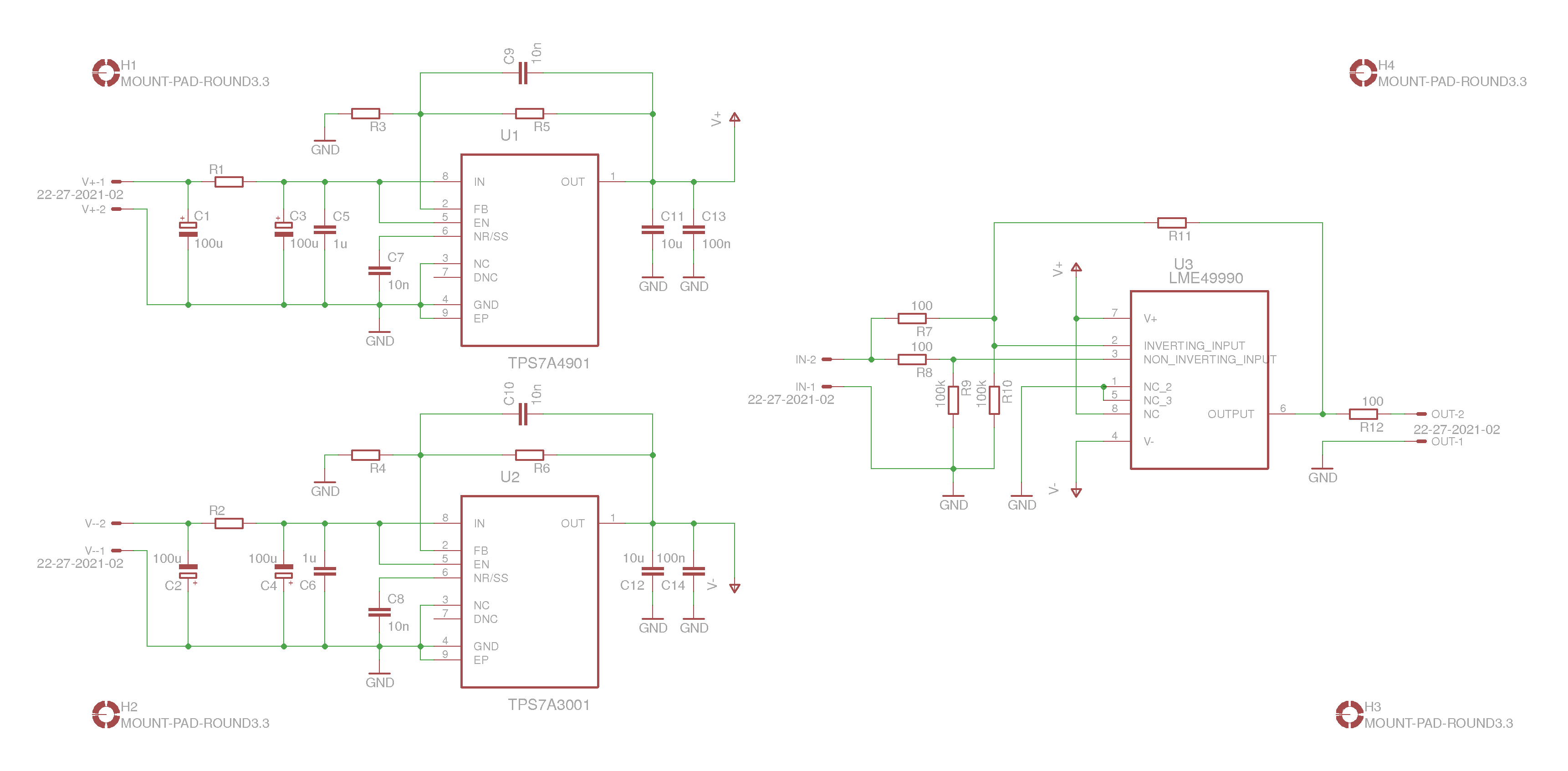

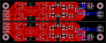

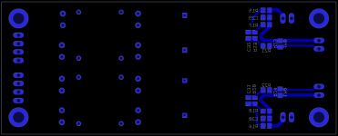

PCB design progress
Half of the PCB is done (see attached). Slightly updated the schematic with some components values. The other half of the PCB (second channel) will be symmetric.
Just to remind you, the intention is to allow using the board in the inverting or non-inverting configuration with or without the gain. So not all resistors around the op-amp will be populated. Some will be jumpers or empty depending on the situation.
Please let me know if I missed something or may be if something is totally wrong. May be there are missing important components... or other problems. I'm still learning. So please comment!
Oleg

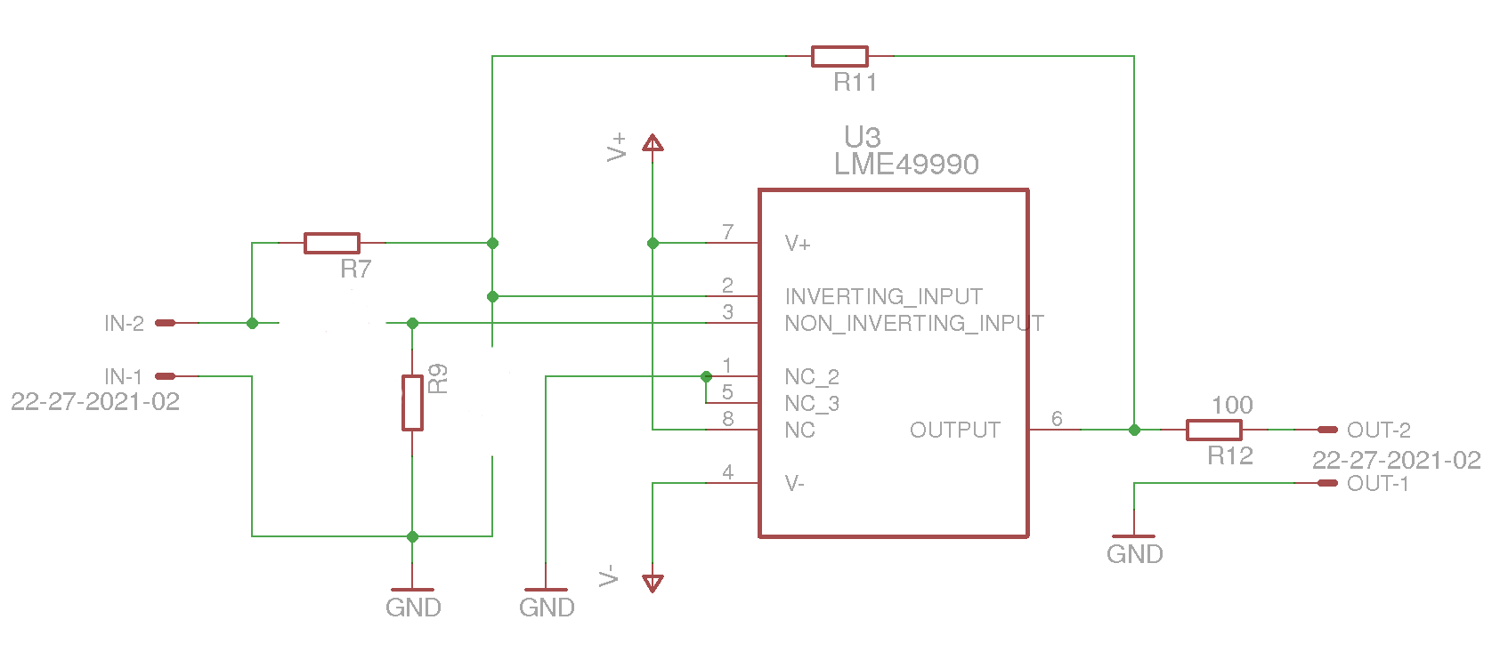

Hi George,
I agree that it would make the PCB even more versatile but it would require a lot of extra traces length because dip sockets do not aligne with the smd pads and need to be rotated by 90 degrees to fit without overlap. This would "disturb" the layout a lot.
OlegSh,
To pick it up where Kuersterfuerst left it.
Some things would make it better:
* Why did you include R7? This is highly unconventional and this kind of connection between the two inputs of an op amp is normally only made to increase noise gain in order to get measure distortion that would normaly be below the measuring instruments limit. Better drop it.
* It is good custom to put a small capacitor over the feedback resistor to limit gain at high frequencies. This increases stability.
* On the input side, you want to put a small cap after the 100Ohm input resistor to filter out radio frequencies.
Your regulator side looks good to me, and the RC filter at the input is a nice feature.

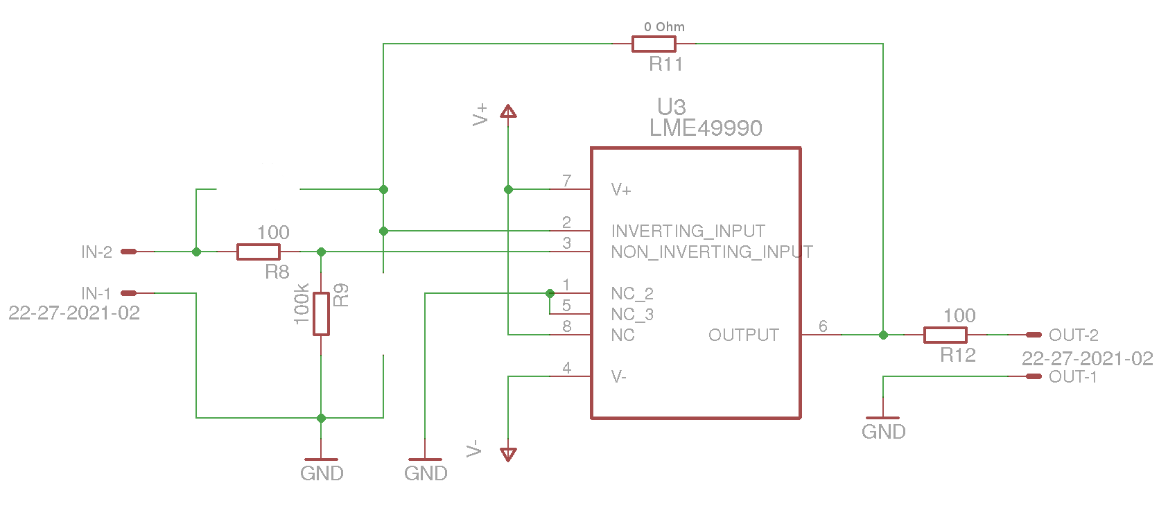

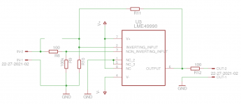

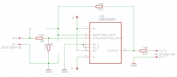

Hi vacuphile!
Thanks a lot for the hints! This is really helpful!
I'll add a capacitor after R8 to ground for RF attenuation. Also will add a capacitor across the feedback resistor. Should these capacitors be in the range of tens of pF? I guess the RC value combinations should give me some hundreds of kHz limit or what value should I design for?
The R7 is there for the inverting configuration (the value indicated on the schematic is the result of copy/paste, please ignore). I may as well drop the entire inverting configuration part. Haven't decided yet. It is always easy to leave the pads not populated. It makes no harm and takes little space.
Please see below the reduced schematics showing only necessary parts for each configuration.
From left to right: non-inverting unity gain; non-inverting with gain set by 1+R11/R10; inverting with gain set by -R11/R7, and if I understood it right R9 should be equal to R7//R11 for minimum output offset but everywhere I see it, it is just a 0 Ohm link. I will have to read more to understand what to do with it. Suggested capacitors are still missing, but I'll add them ...
Please let me know if missed something.
Oleg
OlegSh,
Opinions differ, but if you calculate a - 3dB point @ 100 KHz for the feedback cap, I think you can't go wrong. In case of unity configeration with Rf=0 Ohm, a cap would make no sense as you rightly suppose.
About R7, now I understand you did this to keep flexibility to use it in an inverting setup, that makes sense. Op amp distortion in the non-inverting setup gets higher with unmatched source impedances, so inverting is technically better. However, since in the inverting setup the source resistance of the gear you connect to the preamp will influence the gain, it is not very practical. But to have the option won't hurt.
Thanks vacuphile!
So in the end my ideas were not too bad. I just had a moment of frustration before your previous post... thanks for giving me confidence. It is my first op-amp based circuit so I wasn't sure if I got it right. Also I apologize for removing the stupid question from my previous post about the capacitor parallel to the wire (R11=0) which you answered. Should have thought of it before doubting🙂
Thanks again for your help!
Oleg

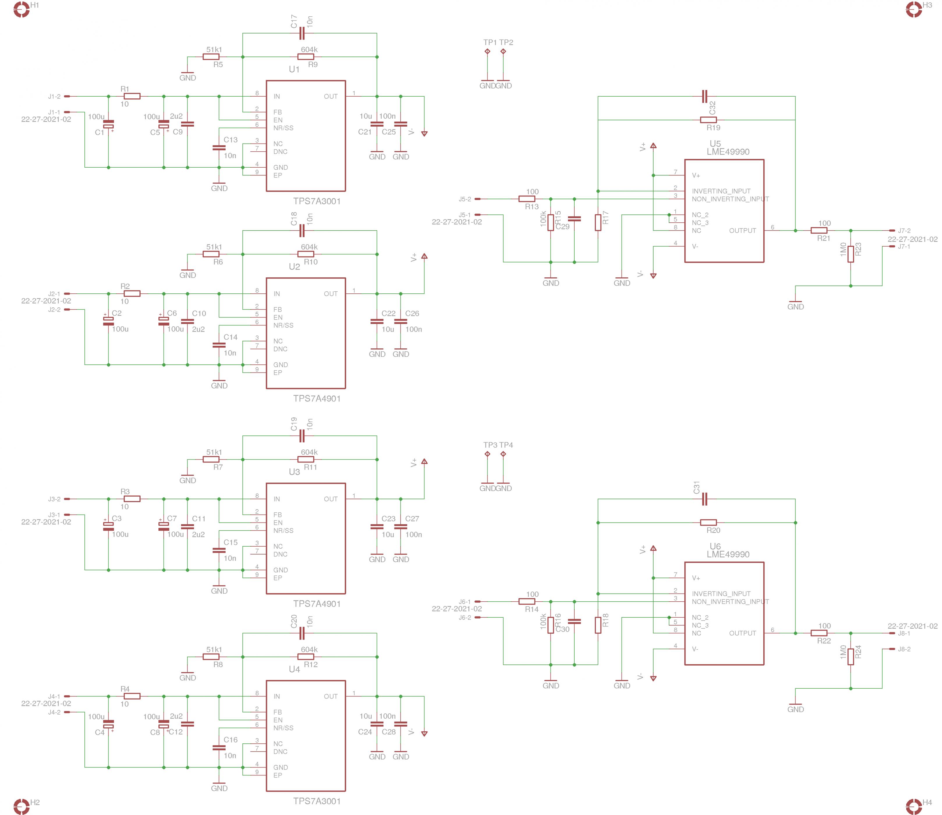

I've finally finished the PCB layout. I dropped the idea of inverting/non-inverting possibility and went with non-inverting only. The updated schematic and the PCB layout are attached below. I'll wait a bit just in case any kind of optimization will come to mind and then order the PCBs.
Thanks everyone who contributed!
Oleg

While playing with the PSU design I've got a question if it is really necessary to have CRC filter before the regulators? I understand that in high current PSU with lots of capacitance it is a good thing (CLC being even better) but what about PSU delivering ~50mA / 12VDC for most of its life?
Thanks,
