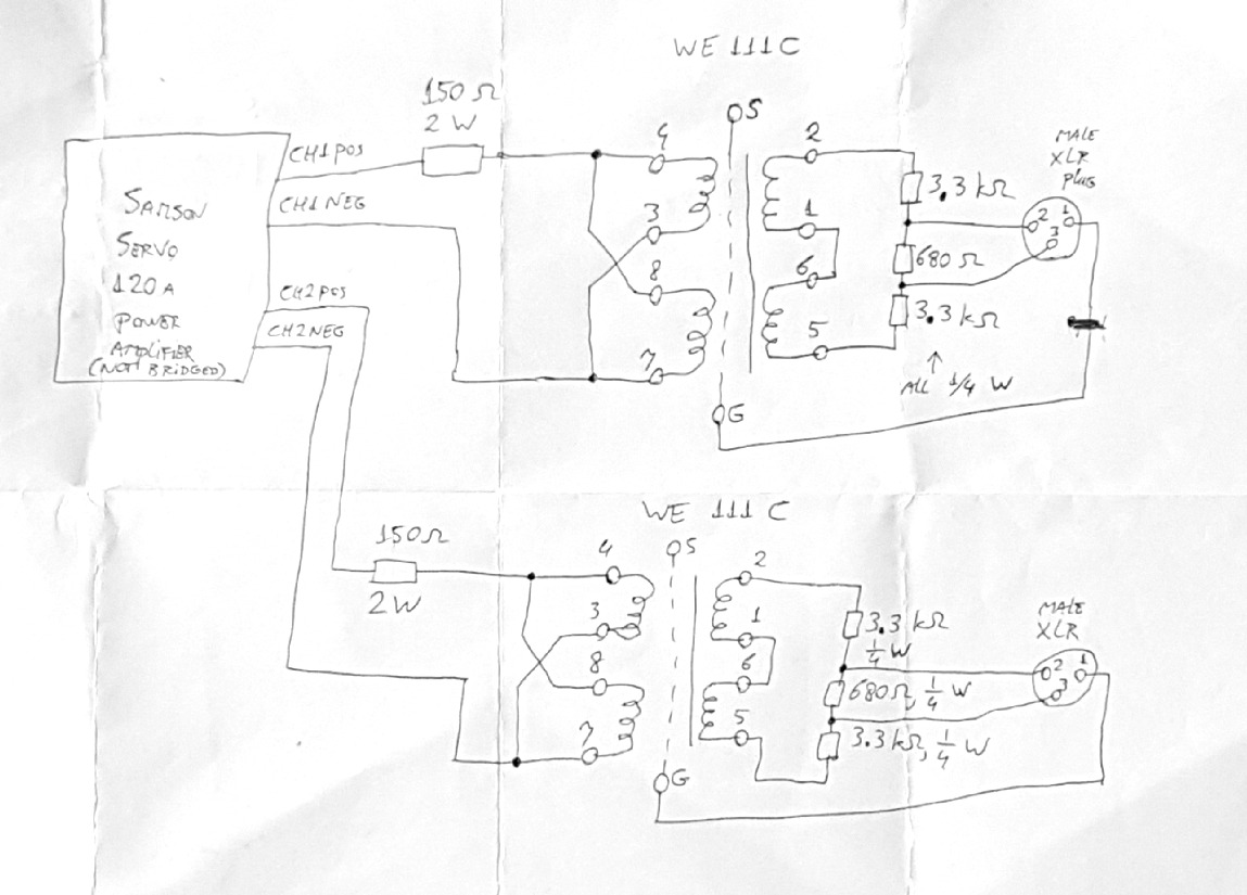

Assuming you don't need an RC network, the schematic would be like this. I included attenuators to get the output level back to something reasonable.

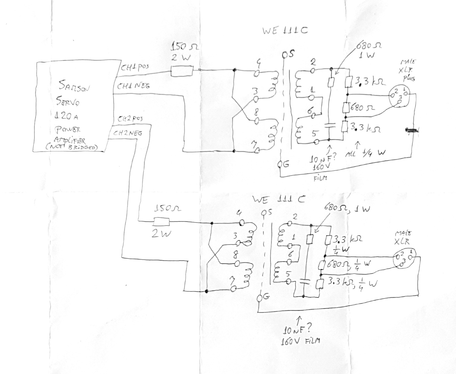

If RC networks should be required, it would become something like this. The values of the extra resistors and capacitors may then have to be determined experimentally.
I would drop the 150 ohm resistor to a pair of 33 ohm ones to make a lower impedance balanced source. 1/2 watt carbon composition ones should be fine.
As to the output load capacitors, .022 uF should provide the load at the upper frequencies to prevent ringing. You don’t need to load the secondary across the entire bandwidth to accomplish that. Although trying.01 uF might show more of what is wanted. Switching in a second .01 or even larger across the first one might give a flavor switch to see what is preferred.

Why lower impedance? The lower the source impedance, the less you notice the distortion of the transformer (which is why transformer distortion is often specified with 0 or even slightly negative source impedance).
Does the dB loss by terminating the transformer with 600R even matter when the point here is to drive the 111C to saturation? Isn't that just determined by the input voltage?
Since I'm still learning about transformers, I was reading that the source impedance has an effect on low end distortion. Maybe a 1-2k rheostat could be used on the input to help "tune" things?

The load resistance will drop the voltage to the transformer as there is a source resistance.
True, but not much more when the secondary winding sees a high load impedance.Lower resistance more voltage. It is one of those optimization curve thingies.

I had mentioned the 60w into 4ohm (peak) thing and asked if that was overlooked and no one answered me. If so, I presume that could change the recommendations by Marcel and Simon.He doesn't need to load the transformer output with a capacitor. It's unnecessary in this application. Most 111C transformers in the world were never loaded with a cap.
You do realize that saturation is a curve, right? Level vs Frequency. And a rather steep one. I posted that curve for a Jensen 123, and the 111C is similar in shape. The target was +30dBu, but frankly, that's way too low if you want to saturate mid-band. Going back to Post #45, if you really want transformer "color", use a different transformer that will saturate at a sane level.

I don't disagree that the 111C could be wired for 150/600, and the termination resistor could be left off. And that's why you can also forget about the RC compensation net. This is now an "effects" box. All options are open. I'd even suggest a pair of back-to-back diodes and a couple of resistors, if you want so extra crunch.

Thank you for taking the time to draw these schematics. I appreciate the time and effort.If RC networks should be required, it would become something like this. The values of the extra resistors and capacitors may then have to be determined experimentally.
I think my plan A will be to go with the simple setup Jaddie suggested as it will not take long at all to put together. I'll rig it up and see how much I can get out of it. If it's not enough, I will start working on the above schematic.
