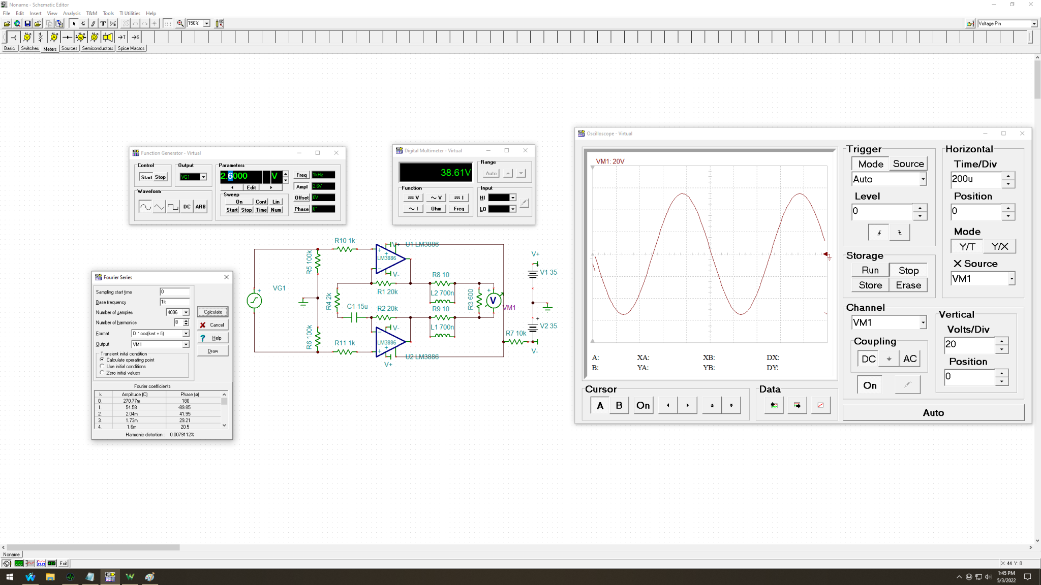

Hey I'm totally down for a less expensive solution. I am a deer in headlights with this stuff so far. I'm trying to find someone that can help me design/build this, for a fee. Nobody here has shown any interest, and I'm not surprised... People have lives and barely time to do their own projects let alone help a stranger build theirs, so I'm trying to find people that do it for a living.Why not try something super simple and relatively cheap like using OPA552 instead of investing hundreds if not thousands of dollars just to see if you like the results.
I'm sure the attached circuit isn't optimal since I barely know what I'm doing, but it looks like it should be able to do around +34dBu with a +10.5dBu input, which leaves room to adjust things with your compressor.
I reached out to Jim Williams whos somewhat of a legend in the pro Audio world for modifying peo gear. He's too busy though. Gotta call some more people.
Great suggestion. Thanks for helping out.OPA551 / 552 is a great suggestion. You can get another +7 dBu by using the LTC6091 instead, since its max total supply is 140V instead of 60V.

Check the continuous output current rating. Consider what you need to drive +36dBu into 600 ohms. (Hint: 32 watts). So now you need an output buffer, and more complexity the OP probably won't want to deal with. 600 ohms because you'd want to terminate the 111C.OPA551 / 552 is a great suggestion. You can get another +7 dBu by using the LTC6091 instead, since its max total supply is 140V instead of 60V.

That's an excellent point about the current output needed. I completely overlooked that; I was too focused on getting the voltage swing.Check the continuous output current rating. Consider what you need to drive +36dBu into 600 ohms. (Hint: 32 watts). So now you need an output buffer, and more complexity the OP probably won't want to deal with.

Oops, should have double checked and not assumed. 38.6Vrms into a 600R load is only a little over 64mA. Well within the limits of the OPA552.That's an excellent point about the current output needed. I completely overlooked that; I was too focused on getting the voltage swing.

Good suggestion.Even if the current drive of a power amp was needed, something like the LM3886 could be used just as easily as the OPA552.
I would point out that the OP has no design experience, but has soldered cables and is looking for a "kit". Making an LM3886 work without oscillating isn't exactly entry-level. Mounting SMDs like an OPA552 is also not at all basic soldering.
A packaged solid-state power amp would work though. Something sitting around like a Crown D75, or D60, if it's still functioning, is a good 111C driver, if you run it bridged it can go over +31dBu, with no issues driving a 600 ohm load.
Remember that +20-21 is the max for any sigle ended stage with +/-15V power supply. Upgrading would be difficult. You'd have either put in a differential output amp (gain 6dB) or and/or add a higher voltage PSU just for the output buffer or go to a different output transformer. It's not pretty any way you look at it.I actually was looking at those. The SSL compressor clone I have has 1:1 600ohm Jensen transformers with a max output of +22dbu. I thought that was the bottleneck in my system because the output gain the SSL was only at 10db of 20db max going into the 111C. So I bypassed the Jensens and went straight into the 111C from the SSL and the signal still crapped out at the same level as with the Jensens. I know it's not the 111C busting up too because I removed the 111C from the path and the signal still broke up at the same point. I had a -30dbu pad before the ADC so I know it wasn't the input converters clipping either.

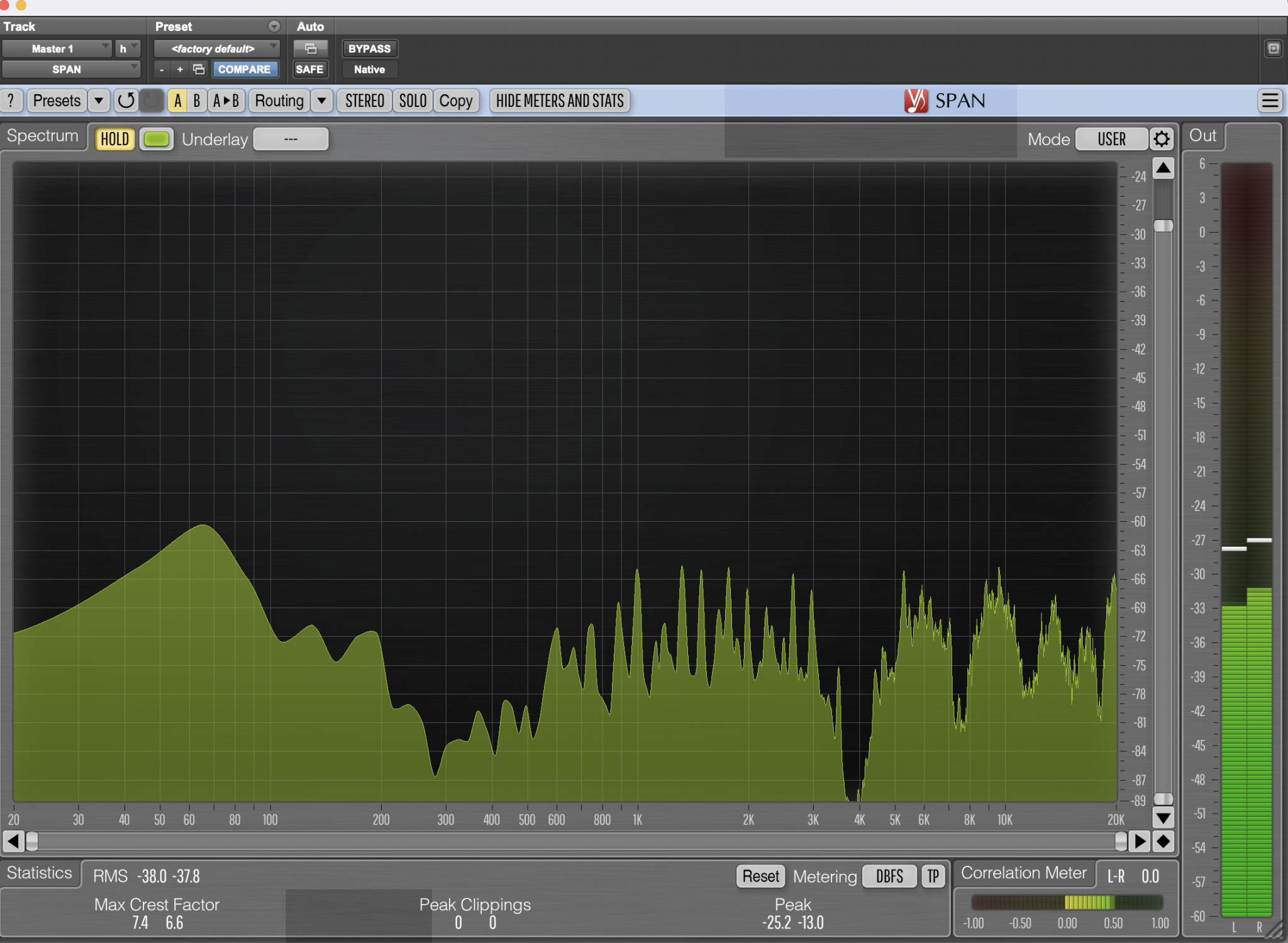

I wanted to run the null test to shore up this point, and short answer is yes, there is a clear difference between using the 111C and not.People build these 111C color boxes and swear they round off the top end, mellow the middle, etc., blah blah blah. But they also went to a bit of effort to make the box, and all testing is fully sighted and biased. There's no telling if they really do anything audible. Measurements strongly suggest otherwise. But hey, if it makes them feel good, that's fine. But I'd also put a nice fresh coat of paint on those 111C coils to make them look and sound pretty.
I printed a section of a mix I am working on, bare. I made sure the signal did not clip the output converter. Then I ran that printed signal through the 111C. After that I brought back in both prints, and put a time alignment plugin on both tracks, since adding plugins increases the delay compensation (which could affect the null test if it was only on one track).
I inverted the phase of one of the tracks (via the time align plugin) 180 degrees and started adding delay to the bare track (using the smallest denomination possible, us) until the two signals got as quiet as they possibly could be. Then I adjusted the gain on the bare track to account for any signal loss from the 111C.
The resulting adjustment values are that I reduced the bare track by -0.38db, and delayed the bare signal by 1.13 samples. These are extremely small values in terms of delay and level. If the files were exactly the same, then the combined signal would be silent. What actually happened is there was a full frequency spectrum range of signal difference. This is quite unusual, as these tests almost always ONLY leave mid and high range frequencies since low frequency waves are so large (they are much easier to reduce in level with phase cancellation). There was about -60dbfs peak level of different audio information across the frequency spectrum, between the two files. I attached a screenshot of the response.
One strange thing I noticed was the Prominent lack of 4k cycles information in the resulting null response. That means that the 111C that I have is stunningly accurate in that narrow band. I do see a big null centered in the 300hz region but it is wide and that is just because the song is deficient in that region, and not a result of transformer affect.
This transformer absolutely has a sound. Now maybe that's because its 80 years old and is not operating as intended. I don't know. But I assure you it's doing something. I want to see what this thing does when REALLY pushed.
Any active differential/balanced output will get you that 6dB too. The transformer would be a step-up.That ssl clone like the original has +/- 15v rails so that's the max it will put out (thats the max of a lot of line level devices because of the opamps) and that's almost always enough. That xformer will double your voltage (+6dbu ) Don't know if that will be enough.

We need to scale the results to reality though. A null to -60 is really an excellent null, not much audible difference there at all, if any. But also realize that the frequency responpse of a 111C is not perfectly flat, nor is the phase response, both of which will strongly limit the null depth. The phase response is way below audibility, and the frequency response is in the "highly questionable" range. Nothing shown is validation of any "transformer sound", though.I wanted to run the null test to shore up this point, and short answer is yes, there is a clear difference between using the 111C and not.

What did you use for the test signal? Music? Or a flat chirp? Music alone would display that erratic null response. To see the null you need to test with a sweep, 20Hz to 20KHz, at some level a tad below 0dBFS, so the test signal is equal at all frequencies. Only then would you see a good picture of the null response.
Even more important, you need to start testing using a double-blind methodology or your results will definitely be skewed. That form of testing eliminates many uncontrolled biases, which unfortunately will strongly affect your results.I'd like to reiterate that I don't have a particular sound I'm after... I actually already like what the 111C does at the current levels. But knowing that it can accept more gain, and that more gain means a different affect, I just want to hear for myself what that affect is. I'm a a very curious and experimental person, and will spend time and effort just to satisfy that curiosity.

The concept is to present choice A, and compare to choice B without knowing which choice has the transformers. Then, compare each to choice C, which will be either A or B, and see if you can determine if it matches A or B. Choice C should be randomly assigned to A or B. It's not easy, and the simpler switching methods require the help of an assistant to remain fully blind, but just comparing the known transformer path to non-transformer path is loaded with expectation bias. Once you really clobber the 111C with hot levels, you'll no doubt pick it out correctly. But at normal, reasonable levels, the differences are very small and influenced by biases.
This is one rason the whole transformer color thing is a mess. Nobody tests it right.
