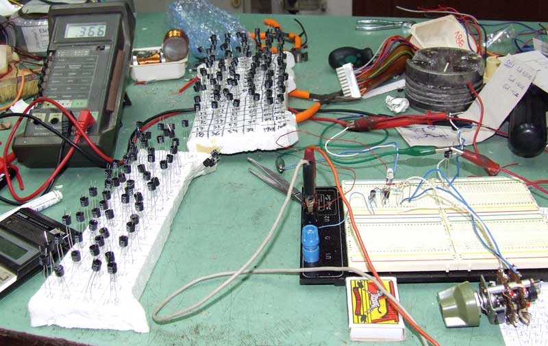

Hey that looks like my work bench, even down to the old piston for ashtray, two years ago. I gave up got, fatter and still love the smell of a freshly lit one.

so - besides that what's shown in your avatar , seems that we have few more common things 😉

ZenMod,
just how many LDRs did you get - it looks like a couple of hundred!
And I see you've measured them one by one, too - is it a Zen thing?!

172 , precisely ;
that was mucho of manual work , not counting needed concentration ....
certainly Zen thing

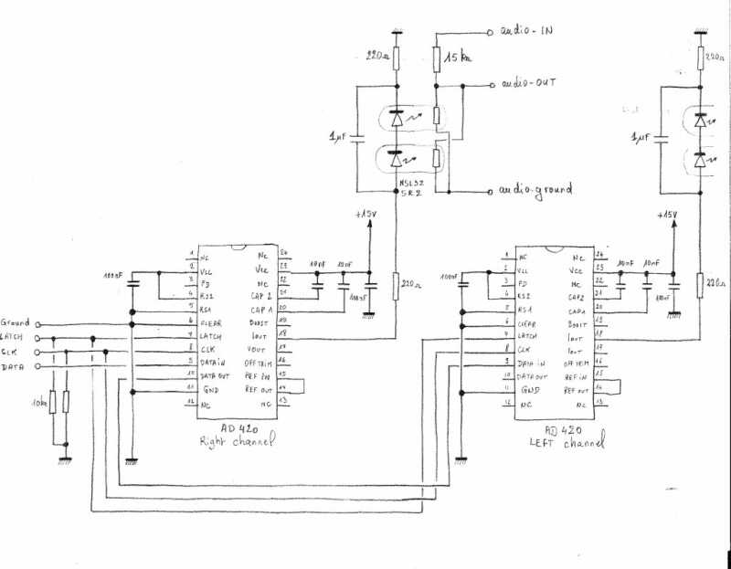

Here's my first go with those LDRs. My thanks to George for making me discover this component and to Barry who pointed out the use of an AD420 DAC as current source.
I'm using a 16F628 PIC wich has control over an infra-red receiver, two push buttons, two AD420 DACs, an LCD display and some I/O ports to drive relays. I recently found some mercury wetted models in an old stock at work and will test them in this project. The attenuator is an R-LDR one, followed by a complementary JFET buffer (K170/J74). I run two LDRs in // to keep the serial resistor as low as 15K. That gives me 57dB of attenuation with an 1dB step wich cover my needs. It was a pain to set given the temperature behaviour of those LDRs.
I'm happy because the whole thing is now working very well. Dead quiet at idle whatever the setting, neutral and well detailed during my first listening. It's better than my PGA2311 pre, more airy is the first thing that comes to mind.
The program has some weaknesses like no self learning of the remote control codes, no 'in situ' setting for the dac words of the lookup table given the lack of eeprom data memory in the PIC I choosed. Next step should be an LDR-LDR attenuator.
But usually, when something I build perform so good, I become somewhat lazzy...
