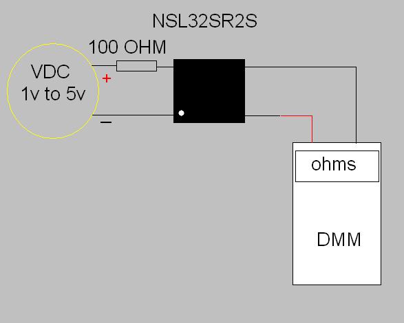

Well, I tried to match my 20 NSLSR2S but it seems not so easy in practice...
Has somebody 5 minutes to explain how to do this match in a very simple way...

If James's way doesn't register.
Use a multimeter and write down the 5 resistance readings of the LDR's at the 5 different vdc 1, 2, 3, 4 & 5 volts.
The resistance readings should be within 10% for all 4 LDR's at each of the 5 voltage settings, this is the simplest way.
Then you'll have 4 matched LDR's
Wait 1 min warm up for each reading
Cheers George

Thank you James and George !...
I'll try again ASAP since my firsts attempts were unsuccessful !...
Hi everybody,
I finally did the job ! I found 2 groups very close from each other with resistances ranging from 35 to 110 ohms for 2 to 5 Volts. The third group had a larger dispersion (from 20 ohms for the lowest value to 140 ohms for the highest) and some mismatches in the range...

Reducing the maximum current through the LEDs does shift the operating impedance but it is not a severe change. I am driving the gate capacitance of an IXYS IXTH 20N50D directly from the LDR’s in my system without noticeable loss of the audible highs.
Check out Nelson’s tables for the various resistance levels at a selection of operating currents to get an idea of the range. The four current setting resistors in the VCCSs can be chosen to set the current scale where you want, to suit your system. In theory the LF347 quad opamp that I use can supply up to 20ma per opamp and only two will be any where near full drive at any on time.
You could certainly fit a buffer circuit after the Lightspeed circuit. I am reluctant to add bits to the VCCS board as it will add to the cost. The whole idea of this was to find an easy to apply low cost modular solution for constructors. Also I do not wish to infringe Nelson Pass's copyright by adding his suggested complementary buffer to the board.
I haven’t tried adding a parallel resistor across the LDRs as I am happy with the performance in my system.
Regards
Paul
