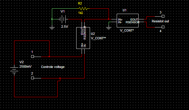

NSL-OPTOCUPLER
.subckt NSL_32SR3S 1 2 3 4
**NSL_32SR3S
* Electronics Workbench
* This file was created by:
* multiSIM to SPICE netlist routine
* Generated by: Dubmaster
* 5/2/2003 5:30:12 PM

D1 1 A LED_mod
V K 1 DC 0.0005
.MODEL LED_mod D(Is=1e-14 Rs=0 Cjo=0 Vj=1 Tt=0 M=500m n=1e-6 )
.ENDS
xU1 18 0 4 3 V_CONT__RES__2__28
xU2 7 9 18 16 V_CONT__RES__2__23
rR2 0 18 1k resR2
.model resR2
+r(
vV1 16 0 dc 2.5
.SUBCKT V_CONT__RES__2__28 1 2 4 5
RIN 1 2 1G
EOUT 4 6 POLY(2) (1,2) (3,0) 0 0 0 0 1
FCOPY 0 3 VSENSE 1
RSENSOR 3 0 959K
* CURRENT SENSE
VSENSE 6 5 0
.ENDS
.SUBCKT V_CONT__RES__2__23 1 2 4 5
RIN 1 2 1G
FCOPY 0 3 VSENSE 1
RSENSOR 3 0 959K
* CURRENT SENSE
VSENSE 6 5 0
.ENDS
.ENDShttp://www.dubmusic.com/
**NSL_32SR3S
*!!!BEGIN-INTERACT
* : Ion ++++f2 ;
* ( Internal state variables )
* 0.0 VARIABLE r1Cur
* .( Loading the led form ... ) cr
* :BEGIN_PLOT
* 0 ==>_*animation_state
* :OUT_DATA
* GET_INSTANCE Vsource ::V V i ==>_*r1Cur
* Ion *r1Cur 0.00004999 f.- f.<= if
* 1 ==>_*animation_state
* else
* endif
* : BEGIN_ANALYSIS UPDATE_SETTINGS ;
* !!!END-INTERACT
xLED2 9 2 LED_yellowLED2
.SUBCKT LED_yellowLED2 K A
D1 1 A LED_mod
V K 1 DC 0.0005
.ENDS
*!!!BEGIN-INTERACT
* : Ion ++++f2 ;
* :BEGIN_PLOT
* :OUT_DATA
* else
* endif
* !!!END-INTERACT
xLED1 1 7 LED_yellowLED1
.SUBCKT LED_yellowLED1 K A
D1 1 A LED_mod
V K 1 DC 0.0005
.ENDS
rR2 0 18 1k resR2
.model resR2
+r(
vV1 16 0 dc 2.5
RIN 1 2 1G
FCOPY 0 3 VSENSE 1
RSENSOR 3 0 959K
* CURRENT SENSE
VSENSE 6 5 0
.ENDS
RIN 1 2 1G
FCOPY 0 3 VSENSE 1
RSENSOR 3 0 959K
* CURRENT SENSE
VSENSE 6 5 0
.ENDS
