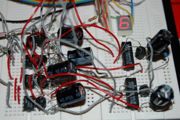

LDR bypass caps
Tried some bypass caps last night on the legs of the LDRs (PSU side) as described in prior posts:
Vishay MKP1837 0.1uf 160v
Wima 0.22uf (the little red ones)
Black Gate NH 150uf 350v (a bit cumbersome for this circuit)
Elna Silmic II 1000uf 16v
Elna Silmic II 1000uf 16v + Vishay MKP1837 0.1uf
Whether or not they changed it for the better I can;t tell. Problem is I'm terrible at evaluating incremental improvements... and wouldn't trust my ears and brain to be immune to placebo, given that there was a five minute listening gap between each cap... none of them seemed to ruin anything. Still, I thought that perhaps the 1000uf bypassed with the 0.1uf may have sounded slightly better... so all subjective and I have no measuring equipment...
I did notice a difference between using an SMPS and linear supply for the 12v part of the PSU, however (the linear being better). And of course a very clear difference between the lightspeed and my alps pots. Maybe I should try and train my ears a bit more for the tweaking.
Would be nice if anyone with thoughts on caps could share their findings... 🙂

I don't think that anyone of us can hear a sonic difference between a Black Gate 150µF and a Elna 1000µF at the position you used it. 😉 Don't visit the audio doctor!
The difference between SMPS and linear PS is more obvious.
That's a relief, thought I had cloth ears and may need to see one of the local ear cleaners..
