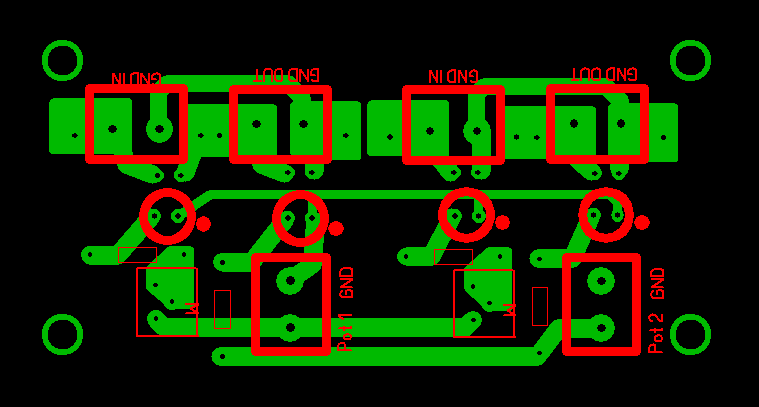

Made up a board layout while I am running tests. Here is a GIF. I will probably etch a few of these today. Comments are welcome.
The board uses terminal blocks which could just as easily be removed and wires soldered directly in. On the side of each block is a hole which is no longer used but I figured leave it as its doing no harm and could be used for putting a cap across the resistor.

edit: There are two trim pots but if I want only one or none I can just short the connection. The terminal blocks for the main pots each contain a ground which is overkill but I didnt want to use a 3 terminal block.

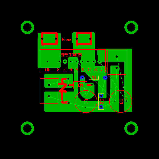

Well, the first PCB for the lightspeed is goofed up. Notice that one of the resistor legs goes to ground when it should go to the neighboring resistor. I fixed that before trying it out.
My supply works well. I get 4.96VDC with no transformer and powering the supply from mains power. Nice and easy. When I connect this supply to the potentiometer I get 5.06VDC out of the potentiometer for some reason. Odd. I hooked an LED with 100ohm in series to the power supply to test it. It does vary the intensity of the LED. Not super smoothly though, it seems nice most of the way but some places have a quick increase in brightness.
Something went wrong though and its not making sense. Hope you guys can help out although after watching this thread the last week it seems no one is home. Anyway, If you check out the datasheet for my power supply you will see how I made it. Its exactly as on the sheet :

So, I hooked this up to the pot and then put the DMM on the resistor part of the LDR. I get nothing. Never registers that there is a resistor in there at all as I am varying the current with the pot.
The Silonex datasheet says max 2.5V but we are putting in 5V is this right? Must be.
If somone could look at my layout and figure why the resistors are not getting any light or why the LEDs might not be turning on let me know. I have tested and I do have 5V coming to them. GROUND is actually COMMON/NEUTRAL but 5V is 5V dont think that is the problem.
Uriah

Well, I had polarity reversed. So now the LDRs are varying their resistance while I turn my potentiometer. Sweet 🙂 I was worried something bad had happened.

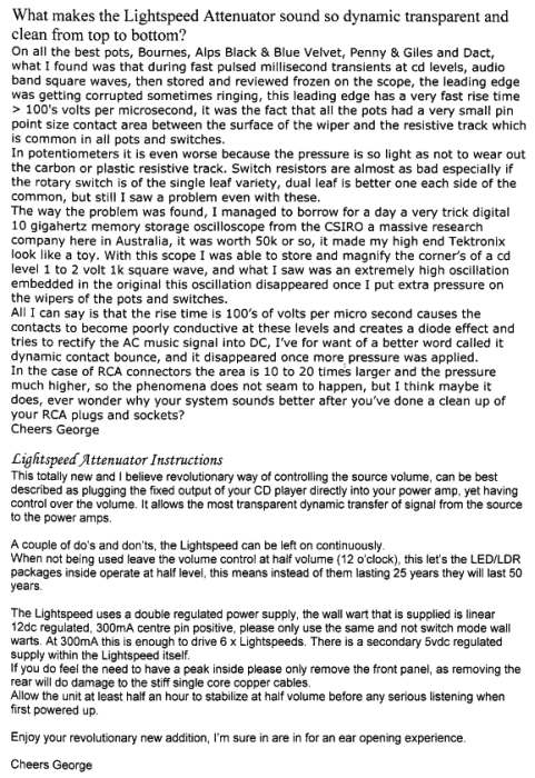

Good to see you finally reached Nirvana Uriah, I've been watching your progress building your own Lightspeed and you have truly diy'ed it, on your own. It's great to reap the benefits of battling through the unknown and reaching a height of sound quality as you have expressed.
Below is what I have found over 30 years and why it sounds the way it does, it was posted before but is buried way back in this thread somewhere so here it is again, these two docs get sent out with every Lightspeed Attenuator I produce for customers who purchase them.

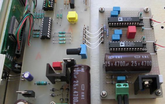

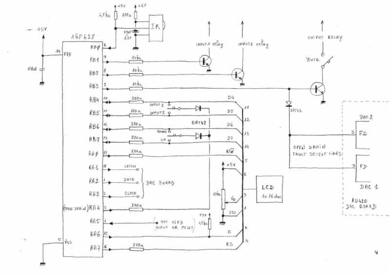

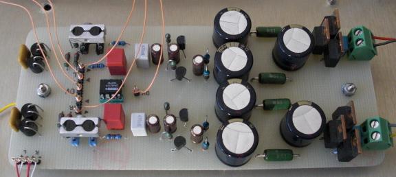

Lightspeed remote control
Hi Folks,
So far only 10 people have expressed interest in the VCCS remote control board/module for the Lightspeed. I can't believe that, like George, you are all sitting next to your volume control and would not therefore find a remote control for volume/balance of the Lightspeed useful. I need to see another 10 interested persons before I instigate a printed circuit board order.
I can report that there have been no operational anomalies occuring since installation in my system. The system is in use daily and the LDR's are burning in nicely.
This is, without doubt the finest volume control I have crossed paths with. It's uncanily adept at resolving subtle information even during large dynamic signal swings and the image remains stable as well.
