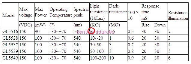

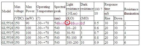

As for using the GL5516 ldr, I tried just about everything but may not this one, if it can get down to 40ohms min resistance like the NSL32SR2S then it will work, if not your minium volume will be too loud for most, essecially owers with high gain sytems and or >100db speakers.
To me from the data specs (attached) it can only do 5kohm min to 500kohm max. This is not low enough.

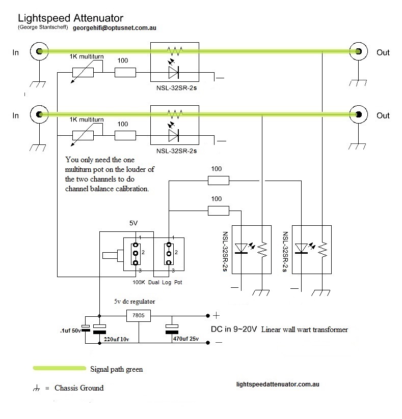

One more question.
Maybe go slightly above 5V?
(By George! Nice abstract drawing. I understand this! Yes the two grounds are of different circuits alltogether and don't combine, a different symbol is better for the left part.)
Think about it, could use a 4.8 NiMh volt battery. You claim good results.
With batteries, voltage would differ a bit, e.g. from a nominal 5.1 to 4.4 V.

- Can I just parallel four extra LEDs for two extra channels. It must have been discussed before.
- Is there any impact on the 100R and 100K?

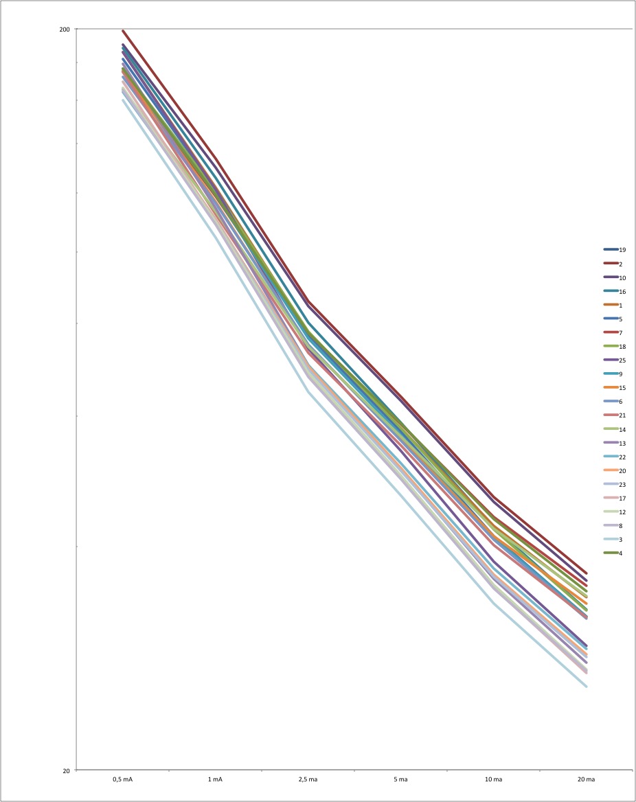

This are the resistance measurements I got using the Kemo tester:
I took the trouble to map these.
I choose a logarithmic scale, but because the MA values should but do not go stepwise on the tester, they create an irregularity in the curve.
Anyway, I see two main groups that behave quite similarly and where I expect that a small matching resistor on the LED will do wonders;
- the whole with only three outliers (25, 10, 2) while I discarded the obvoius wrong ones.
Based on this "review" (spreadsheet soldering comes to mind like spreadsheet management🙄) there would be more rather good matches than just a few pairs.
For example: looking at the bottom end, the No. 3 with only 16 mA max would have the same resistance as no. 22 . . . and that could imply just a small extra resiatance value on the LED.
nice to see that a LED/LDR that is low stays low all the way through the range. Similarly all the others generally stay within that group range, i.e. they track similarly.
There are two obvious exceptions, one high that slopes towards the middle and one low that slopes towards the middle. These two would make bad matches to any others near them.
It looks like you can get many pairs by selecting those that stay near each other. Maybe even get triples or quads if needed.
