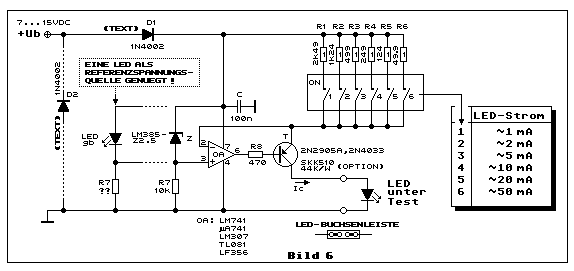

Yes this is the later model with even finer values, still cheap $12, for what's inside. Don't use the 35mA or 50mA you may blow the led.

I have ordered the LED tester. Waiting for the item to arrive so that I can give it a try.
