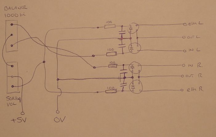

I realize it is counter intuitive. After all the LED should isolate the PS. But it does not. It is great just as George builds it. But is can be improved and the difference is not subtle.
The lightspeed circuit I use is more or less per the diagram posted back in spring 2008 when a bunch of people experimented with a variety of caps on the pins of the optocoupler.
I have played around with various power supplies. Walwort, battery and linear. I believe a low noise diy voltage regulator and the caps on the pins are the most important elements. I still prefer linear power supply in front, but with the caps and the low noise reg, not sure if the supply is all that important. For the record I use a 12v toroid, bridge rectifier, CLCLC filter. The last couple of filter caps are Black Gate F. Toroid and first filter element are in a separate chassis.
Sound? Sublime!

Adding caps and getting better sound does not indicate a problem with the power supply. The caps ARE part of the power supply, as is everything before the LDRs. He now has a better power supply. Caps directly on the pins of an opamp and chipamps are well known ways to get better sound and it works for LDRs as well. Recently experimented with film vs ceramic .1uf's. No difference. I use this parallel with a 10uf-100uf electrolytic. I doubt brand has anything to do with the sound here but I use Nichicon FW, KW and those green bipolars depending on whats in stock. I'm sure any old electrolytic would sound the same but I think people expect a higher quality cap in their kits. I would NOT encourage higher values of caps after the potentiometer as you can hurt the wiper by forcing it to pass higher currents. If you have that 100R current limiting resistor in place you are much more safe using higher values of caps but I dont think you will benefit from higher than 100uf.

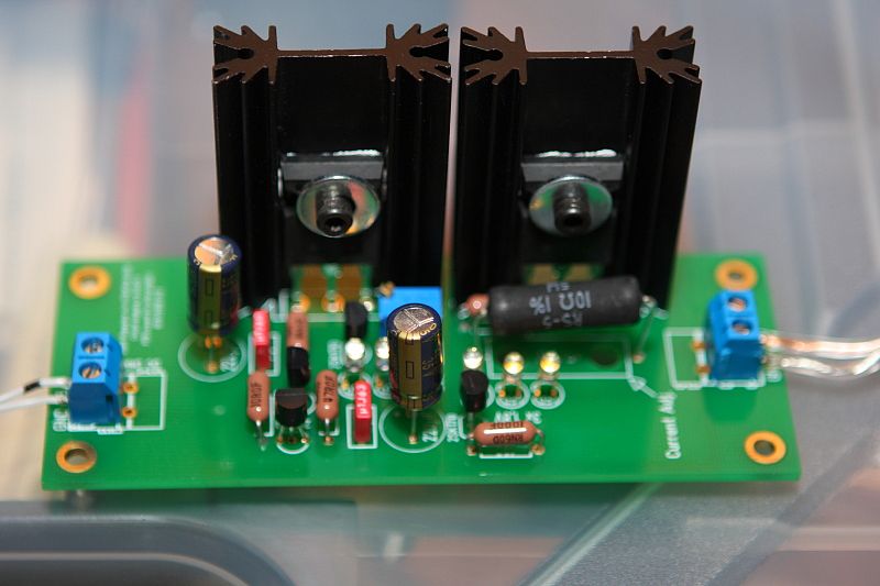

I just finished my DCB1 build with LDR attenuation. It still needs a chassis and I haven't had the chance to listen yet - that comes tonight!
The LDRs are mounted directly to the DCB1 board and are powered by Salas' 5V shunt regulator.

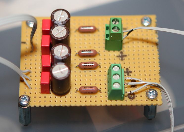

I built George's LDR control on perf board and have the 100k log pot on a tether for some flexibility.
The power supply to the LDR control board is a perfect 5.00VDC. With 100ohm resistors and a 100uF caps followed by 0.47uF caps, I get a voltage range of 1.62v to 2.18v for the LDRs. This allows the audio resistance provided by the LDRs to vary from 22R ohms to about 6k7 ohms.

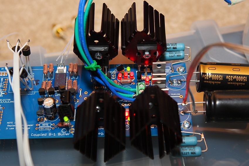

It still needs a nice chassis and bigger sinks so I can push the bias on the DCB1. I can't wait to give it a listen tonight with my AudioGD DAC and Pass a40 amp.
