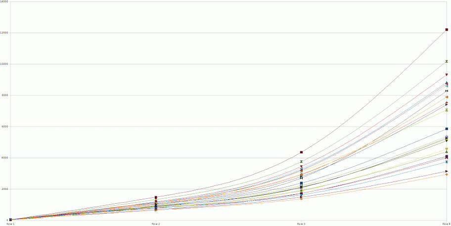

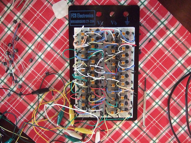

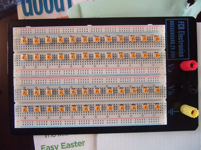

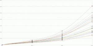

I made these curves when I started matching LDRs and i used massive quantities of pots all dialed into the exact same value to test LDRs. I used values from 1k up to 100k to replicate being controlled as they are in a Lightspeed. So we get this slope. This is how a shunt LDR resistance would look as you turn up the volume on your 100k dual pot. Now simply reverse that picture and think of whats the total resistance of this voltage divider I've made with series and shunt LDRs controlled by a 100k pot? Its not static. Its dynamic. Its the shape of a smile and it sounds freaking fantastic and the total resistance is not at all the same at mid volume as it is at min or max. Quad matched isnt going to change this. If you use a set of LDRs that are hitting about 12k at 100k you can bet your total resistance at half volume is going to be around 70% of that and in fact the easiest way to make the total resistance to stay about the same in a usable working range is to use a handpicked pair that nowhere near resembles the other pair when being controlled with identical voltage and current. This way you can slide the resistance curves around til you find a pair that actually give you a near static total resistance in a band of useable volume. I have done that but I certainly dont make an effort to do this as I dont mind max and min volumes having much higher total resistance than my main listening volume which I like to be more around 6k. Thats what sounds good to my ears in my system.
The Audio Precision tells me that the lower the total resistance then the lower the THD+N and also that the lower the input voltage the lower the distortion.
I dont recommend over a 2.5V input voltage because the THD does start to get silly only a bit higher than 2.5V. I love my AudioGD DAC and it gives me 2.5V just like our buddy a few posts up. So I think his problem has nothing to do with quad matching and fairly little to do with his input voltage.
The other two pics are how I used to do matching. Now I use another method because its just to fiddly to adjust dozens or hundreds of pots for each and every measurement.

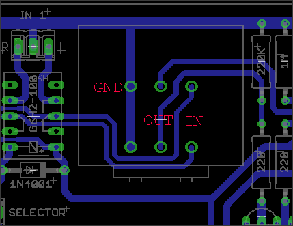

I took some voltage readings from the LED side of my LDRs as installed on the DCB1 board - perhaps this will provide some insights. I also double checked the input and output wiring. They don't appear to be mixed up...
On the DCB1 board, the holes on the left of where the pot goes lead to ground, the middle holes are the signal out, and the holes on the right are the signal in.
From the two sets of matched LDRs, the first matched pair connects across the In and Out mounting holes. The second matched pair connects across the In and Ground mounting holes.
With no resistor in series with the pot (as per George's diagram), when the 100k log pot is rotated for minimum volume, I get 1.48v on the legs of the LED that sits across In to Out and 2.00v on the legs of the LED that sits across In to Ground. When I rotate the pot for maximum volume, I get 1.98v on the LED that sits across In to Out and 1.48v on the LED that sits across In to Ground.
As I rotate the pot from min to max volume, the voltage across the In to Ground LED falls more quickly than the voltage across the In to Out LED increases, until I hit the half way mark of the pot's rotation. Then the behavior reverses.
Also, the change in volume exhibits a several second "delay" from when I adjust the pot. I suspect this is a result of the 100uF caps charging and discharging as the pot changes. Is this normal?
Have I connected the LDRs in the proper manner?

At minimum volume, my series resistance is about 22k ohm and shunt is about 18 ohms. At maximum volume, series is about 24 ohms and shunt is about 22k ohm.
So, it appears to me that the LDRs and their control circuit are functioning properly. The problem must be somewhere else...
Andrew & George: This is a DCB1 build with no output caps. My plan is to put this in front of a new F4 that I am building.
I was thinking it was my wiring of the LDRs that was in error... I'll make the switch and let you know how it turns out. I suspect we already know the outcome!
