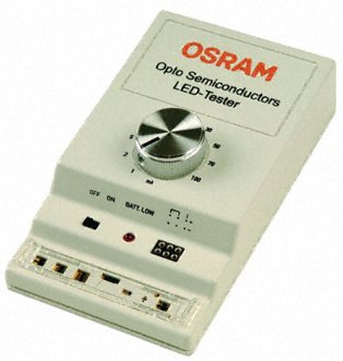

Or if you diyer's want to go a little more sexy and not have to pull the led's in and out of holes, this one has a switch for the different mA setting.
Before my own much more complex one I built, I used a regulated 9v wall wart insted of the battery to power these simple testers from Kemo and Osram.
The Osram one for memory was available from RS Components also cheap around $10
Cheers George

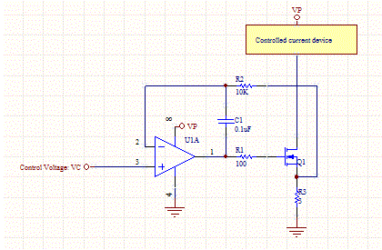

OK, thanks. FYI the VCCS circuit I use for matching LED/LDRs, and for control, is similar to the one shown here
Voltage Controlled Current Source - Current Servo
You put the LED above the mosfet. I use BS170 mosfets. You also need to use rail to rail op-amps.

I confess some confusion. I started a rather extensive post in response to the constant current schematic which BFNY has just posted, but backed out because I wondered if perhaps it was getting too far into constant current and this is the Lightspeed thread, and there have been rumblings about this problem for a long time now.
It's a conundrum. The Lightspeed is a very simple yet very musical (so I'm told, anyway, I've never heard one) circuit. So the value of the LDR is proven. But future development will invariably move in the direction of constant current because of the nature of the LED side of the LDR, and because of the desire for more precision and control over how the LDR functions in the circuit. What I'm not sure about is whether this thread is for the maintenance of the Lightspeed circuit, or whether it is about LDRs and the continuing evolution of the use of LDRs in audio.
The constant current circuit that BFNY posted is the foundation for constant current control of LDRs. While there are a lot of nuances and devil-in-the-details issues that are not addressed in that circuit, that's the basic idea. Those of us who are seriously pursuing constant-current circuits are dealing with those nuances that require a lot of serious study and testing which put our projects out of the mainstream and, in my case at least, my project requires PIC programming expertise as well as audio expertise. No one seems to be working on a dead simple constant current circuit like the one BFNY posted that would be within easy reach of DIY audiophiles -- something that is easily and inexpensively reproducible, but delivering superior results. Maybe a combination of constant current circuitry and UDaily's matched LDRs would be an ideal compromise.
Someone needs to start a thread centering around a dead simple constant current circuit controlling four legs of LDRs using the principles shown in BFNY's circuit, and produce a viable circuit card with regulated power on board. And, if the Lightspeed folks wish it, we need to do it somewhere else. I would like to participate, but don't feel comfortable doing it here unless/until it is made clear that this thread is about expanding our understanding of LDRs and that constant current discussion is welcome.

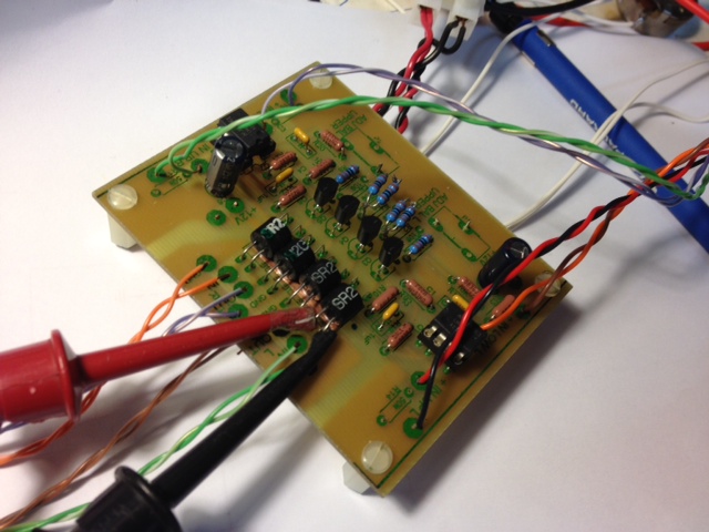

here's my proto board - as you see, this can be done in a very small space.
This uses dual rail to rail op-amps and 4 BS170s. The board is about 3" long
Mods can move this to a new thread if desired, or I can repost in a new one.
Good looking board! That looks like it could be what I was talking about earlier -- a board that lots of people could build and enjoy, and featuring tighter control of the LDR resistances.

BFNY, I'm glad a saw your board. I just realized that I'd added a lot of complexity to my design to solve a problem, and then solved the problem with a simple change to the circuit but then never went back to get rid of the unnecessary complexity I'd added! I need to test to verify, but I think my design just got a whole lot simpler thanks to seeing your board!
Still playing with the board layout and design. Will post in another thread when ready to go.
