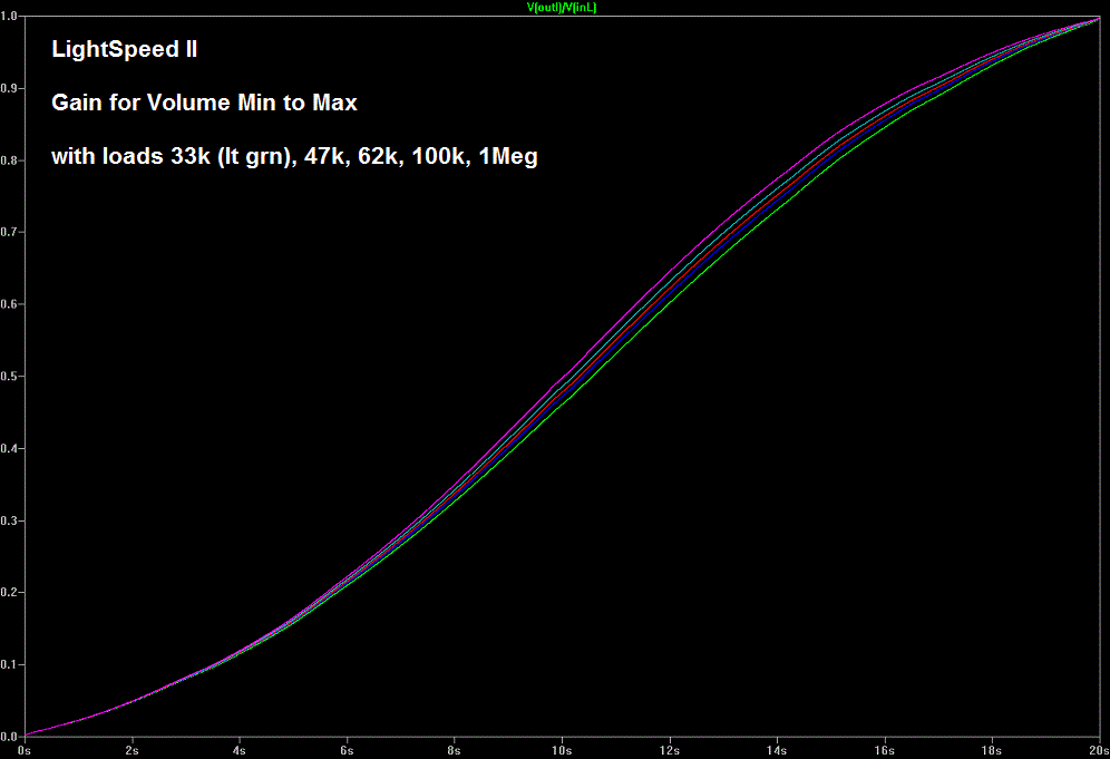

can you convert the seconds of pot rotation to attenuation for me?
eg. at 12seconds, what is the attenuation?
It would be easier to just plot the attenuation. I'll post the plot when the simulation finishes.
EDIT: I plotted the GAIN, instead (attached).

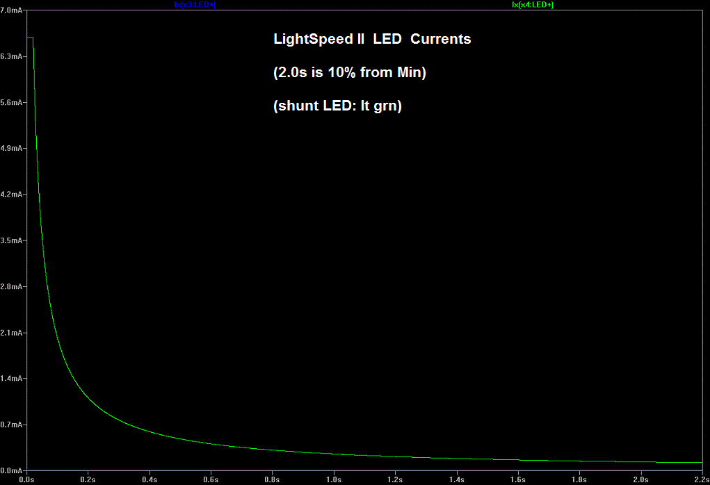

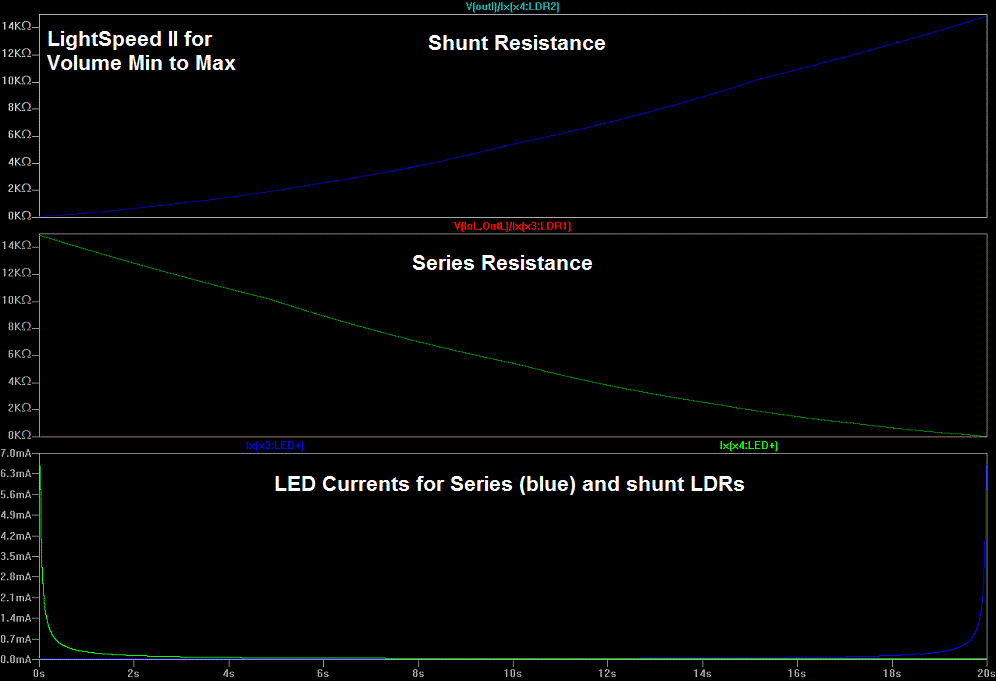

Just for fun, I also plotted the LDR resistances and the LED currents.
I included magnified views of the two areas of the shunt LDR's current, so the values could be read more easily.

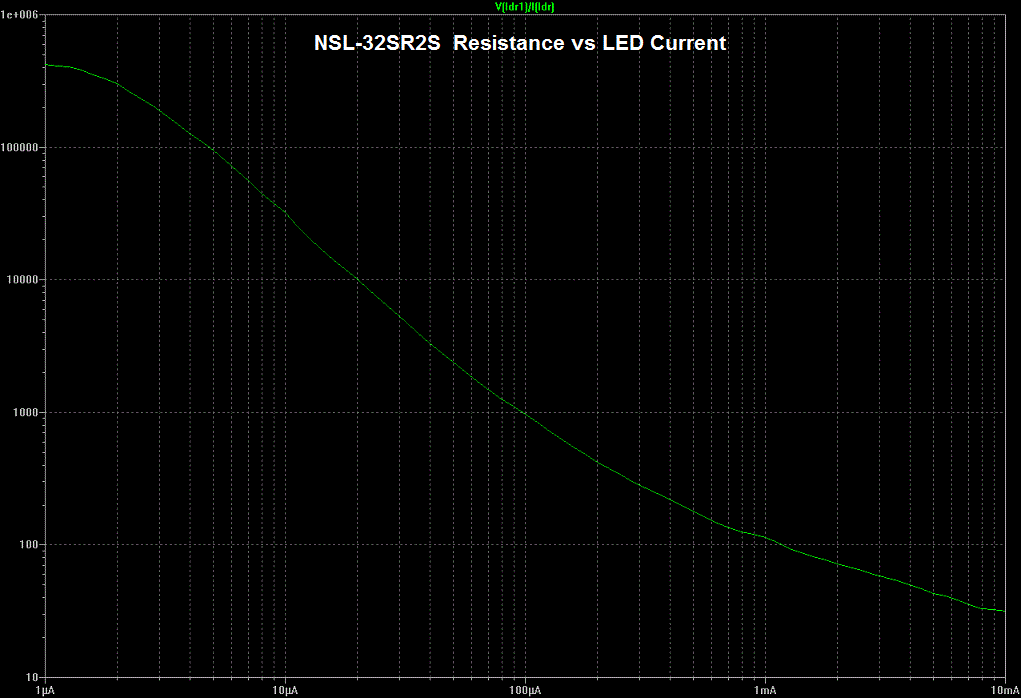

Edit: I added a plot of the NSL-32SR2S model's resistance vs current. You can see a couple of minor bumps where I apparently was slightly off when I measured the plot from the Silonex website.

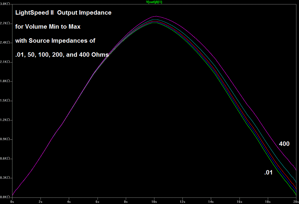

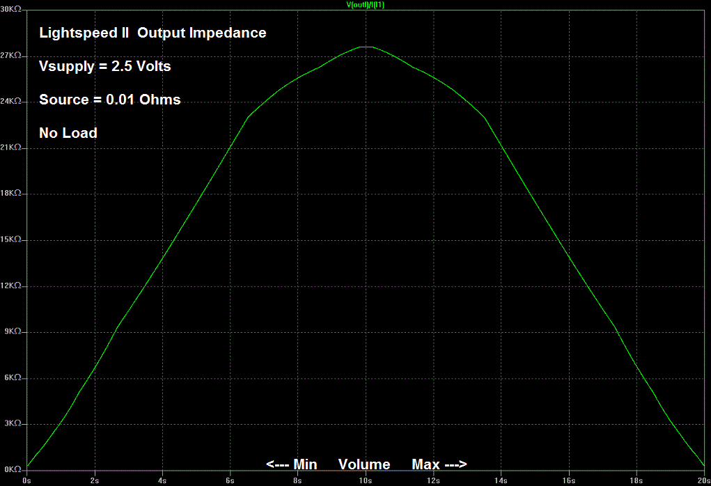

I took a crack at plotting the output impedance, for source impedances of .01, 50, 100, 200, and 400 Ohms. I put a resistor across each input for the source impedances and placed a DC current source from ground to each output. Load resistances were removed (opened). As the pot was varied linearly from min to max, I plotted one output voltage divided by its current source's current. The source resistances were stepped to the values in the list, for the plotted runs.

WOW!!!
Thanks for posting that Tom as it's way better than I measured 5 years ago, I must have had a DMM that was out of calibration, this result shows that it's no worse than the output impedance of most tube preamps. I knew it remained stable in the MKII version but had no idea that it was this low which is great, better change my sales pitch.
Cheers George
The attenuation vs rotation looks very similar to a lin vol pot with log faking resistor.
I am surprised at how little the volume/attenuation changes in the second half of rotation.
I also draw attention to how much of the volume control is using the very low LED current range from 15uA to 200uA.
The LED current >500uA is rarely required for normal system gain, normal listening volume.
This observation confirms that low current matching is critical to maintaining L/R balance at normal listening volumes.

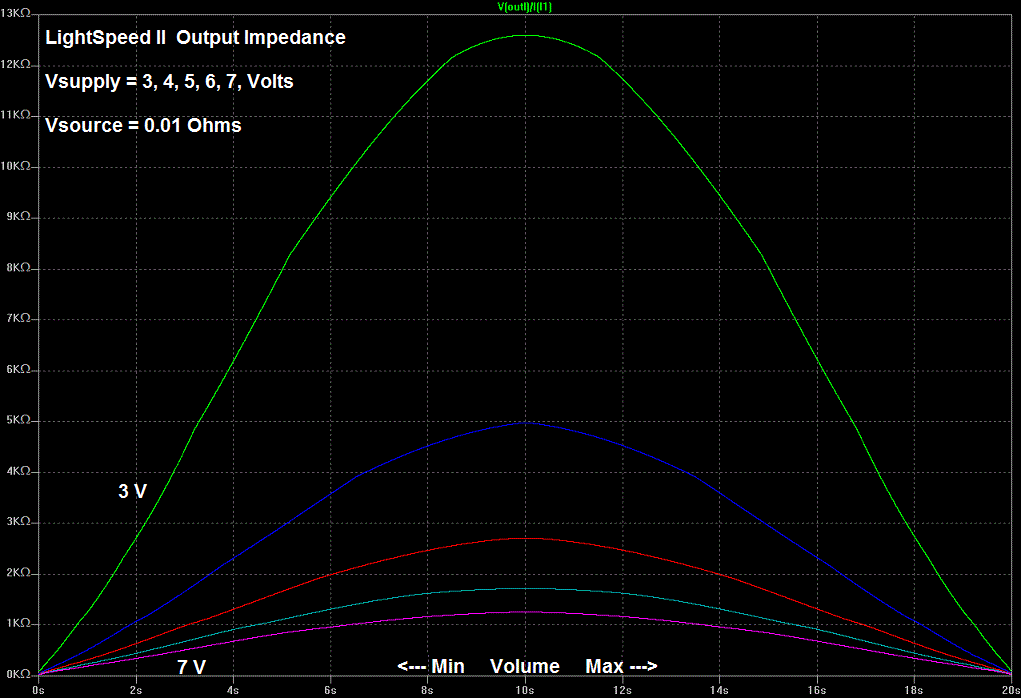

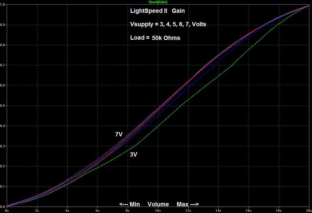

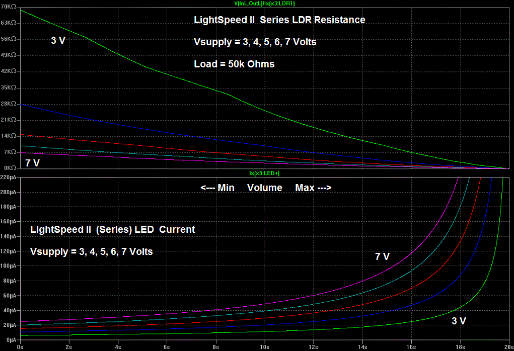

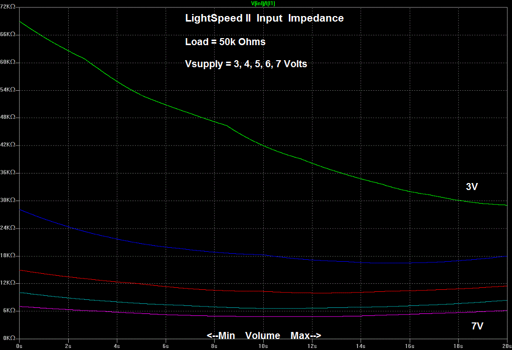

What about changing to different power supply voltages? Plots attached.
(For the LDR resistance and LED current, I only plotted the series LDR, since the shunt LDR's plots would be the same except mirrored left-to-right.)
Tom

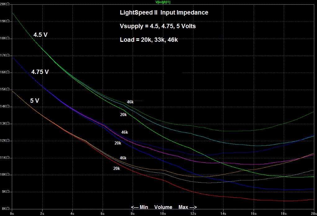

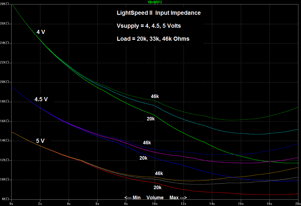

It looks like some people could consider lowering the supply voltage, slightly, if their load's input impedance is too low. See attached, which plots input impedance for loads of 20k, 33k, and 46k, with Vsupply of 4V, 4.5V, and 5V.
The peak output impedance goes higher as the supply voltage goes lower. But for 4.5 Volts the Zout peak only rises from about 2.7k (for 5.0V) to about 3.5k (for 4.5V).
EDIT: The second plot is the same thing but for 4.5V, 4.75V, and 5V. Note that the peak Output Impedances/Supply Voltages are 3.52k/4.5V, 3.06k/4.75V, and 2.72k/5V.

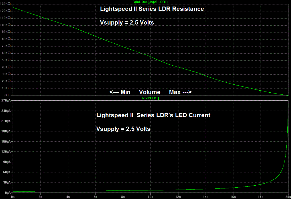

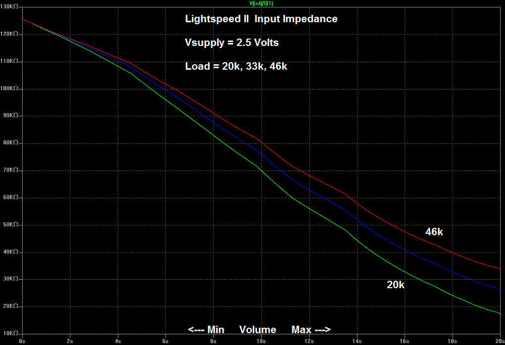

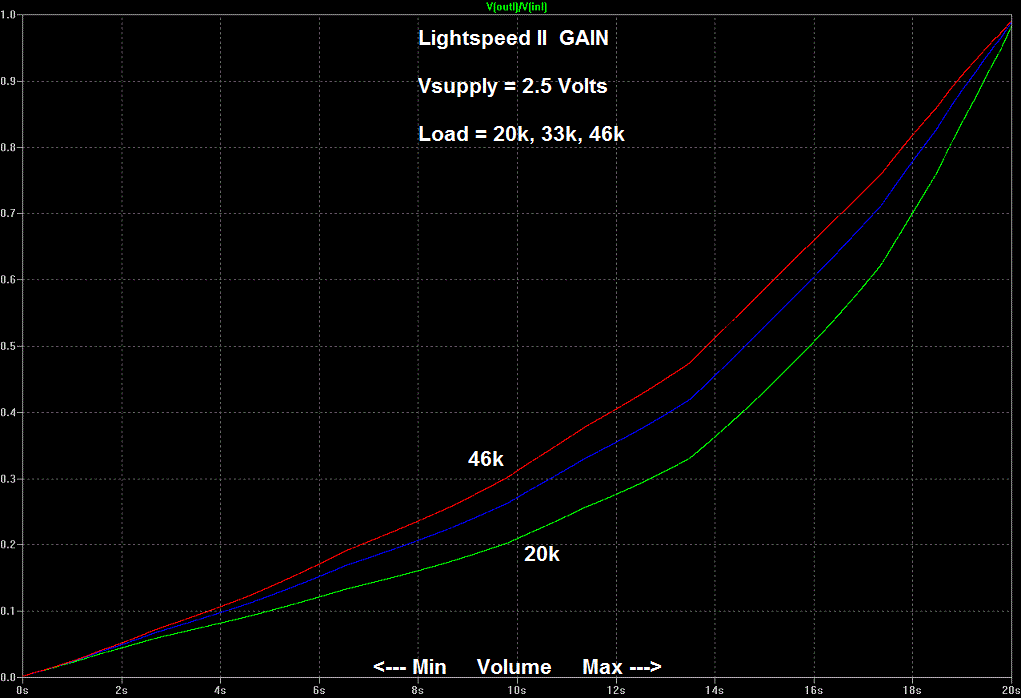

Tom,
Could you repeat the test but with a voltage of 2.5volts, and also put up the resultant current/volume setting plot?
jh,

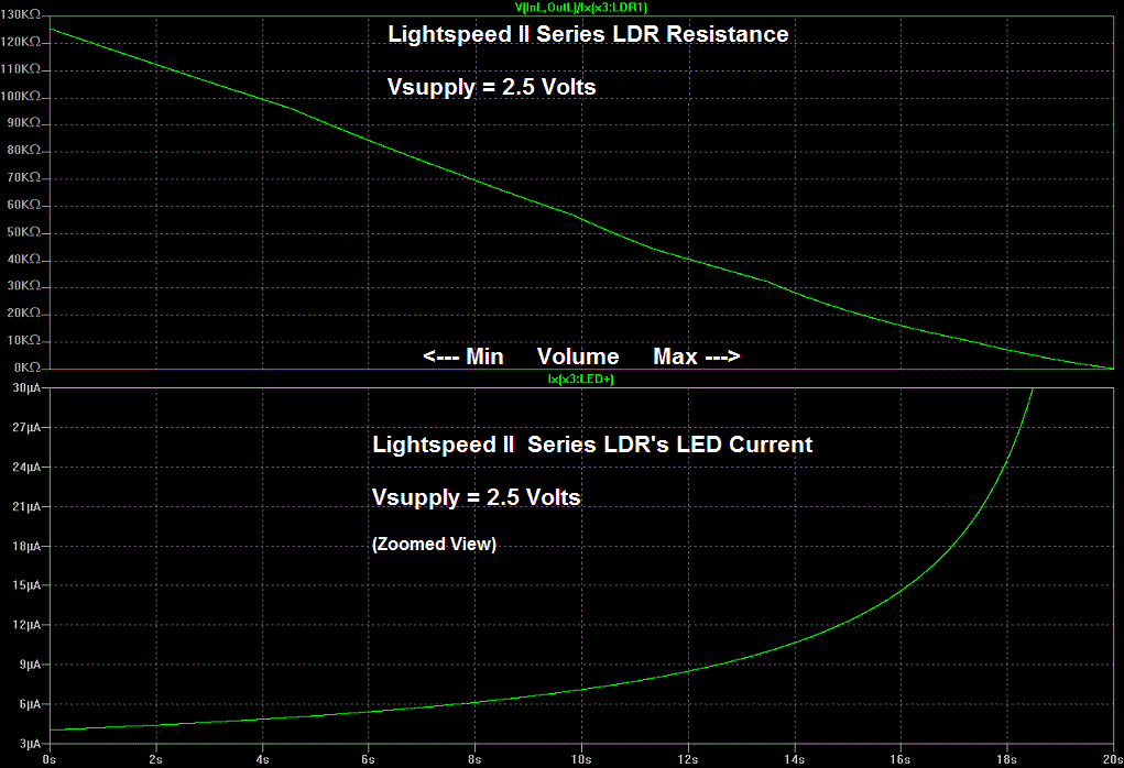

Sure. No problem. See attached plots vs volume setting for Vsupply = 2.5 Volts, showing Input Impedance for loads = 20k, 33k, 46k, the series LDR's R and Iled, the same with zoomed Iled, the Output Impedance, and the Gain for loads = 20k, 33k, and 46k.
This is interesting, Tom
- it seems that for up to about 95% of the rotation of the volume pot, the series LEDs are using less than 30uA current - what current is the shunt led using for the same setting?
The Mark II's input impedance ranges from 125kR down to about 30kR and extrapolating from the plots, it would seem that a 100kR load would nearly be linear and range from the same 125kR down to about 60kR - and, from the gain plot (last photo), a 100kR load would also be more linear - a wonder if we could use this somehow?
Could you extend your model to add another series LDR with the same properties as the first series one to give the classic T-pad and do the same measurement, particulkarly with attention to see if the humped o/p impedance also becomes more linear? Not sure if this is possible with your model as most T-pads have different series/shunt coefficients/ratios but ....
Didn't you develop a simple low current control mechanism for the L/Speed somer years ago? Did it function okay?
Thanks for going to so much trouble, and it is quite interesting indeed.
