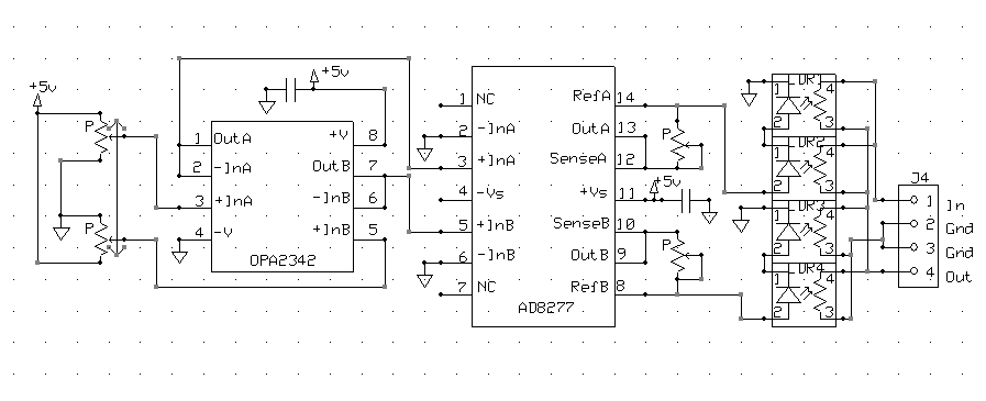

Here is a contribution to the ‘dead easy’ constant current LDR volume control discussion. I’m not trying to sell anything here. This circuit works well, and consists of only a dual ganged pot, two ICs, two multi-turn trimmer resistors, four LDRs in series/parallel, and a few bypass capacitors. I'm assuming that with a little thought, you could do a circuit for the op-amp that would take care of the "one-side goes up when the other side goes down" requirement which would allow you to do away with the dual ganged pot. In my circuit, I do it with software so haven't worked on a hardware solution.
Virtually no current flows through the volume control pot, so that is not a problem at any volume setting.
The constant current IC is internally current-limited to 15ma max per leg, and at that current through two series LEDs, it delivers an easy 25 ohm -- or better -- minimum resistance. Since you only draw max current through one side at a time, the total current through the IC is always 15ma or less, though the chip is capable of delivering 30 ma (15ma per side). You could do this circuit with only one LDR per leg, but you get a better attenuation range by using two at the same 15ma, and there is no downside other than cost.
The only downside to this circuit is that it uses SMT ICs. If anyone can find equivalent DIP ICs, I’d love to hear about them. In selecting alternatives however, beware, because you will find the devil in the details. I like these ICs because they are precision, and the CC chip uses precision laser-trimmed resistors for minimum temperature drift in operation. The math for calculating the values of the reference resistors on the output is simple and is included in this article.

With a single pot, wouldn't the supply just be connected to the wiper and the ends be connected to the current-limiting resistors of the series and shunt attenuator's two LED circuits?
Or, given a single variable voltage within a known range from zero to vmax, a one-opamp subtraction (difference) amplifier could be used to subtract the variable voltage from a vmax reference voltage, giving the reverse-varying voltage needed for the other LED in a series/shunt attenuator.
But the second case gives very different results, with a Lightspeed II-type attenuator.

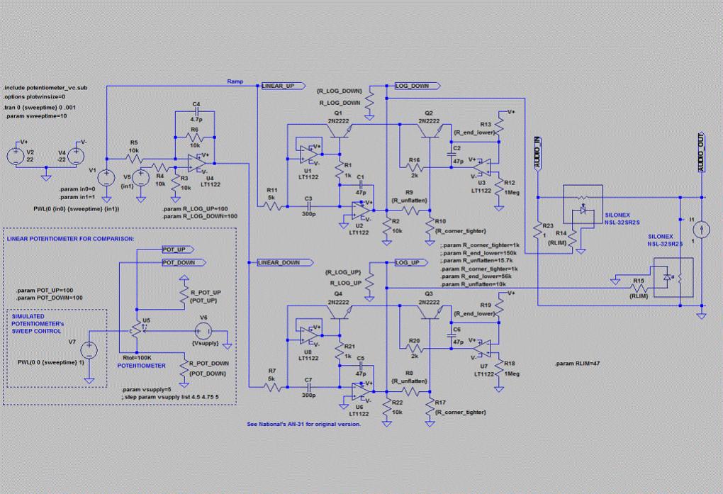

I don't know who Howland is, or know anything about his pump. I just found a circuit that I liked and wanted to share it. If you want to string up the authors, find a posse and have at it, but I won't be riding with you.
I like the AD integrated solution for multiple reasons:
One, it is very small -- the SMT chip is maybe half the size of a DIP with the same number of pins. When you add four external resistors to each discrete circuit -- eight per channel -- the fully integrated version becomes even more attractive.
Two, to avoid temperature instability, the resistors must be very close tolerance (better than 1%). On top of the extra space external precision resistors would take, I don't want to pay for that kind of quality.
Three, the AD device is current limited to 15ma -- perfect for running two LEDs in series to achieve 20~25 ohms resistance. I don't have to worry about limiting current.
Regarding your questions 1,2, and 3, I don't have an analog answer for you because I don't have to deal with it. Instead, I use a PIC to custom program each LDR leg any way I want it to respond. The PIC has 1023 linear steps which is really not enough to properly control the LDR across the full spectrum from 25 ohms to, say, 20K ohms; however, by using two Vrefs, I can change the PIC behavior to give not only 1023 steps across the entire current range of 15ma to .002ma, but also a separate 1023 steps from .2ma to .002ma, and that really does cover the waterfront quite well.
I think that in my own project I've been spinning my wheels trying for a degree of precision control that the LDR simply will not support due to the sloppiness of it's response to changes in current and whether the change is either up or down. I can precision-control the current, but the LDRs don't want to cooperate at that level! The LDR is what it is, and it won't get any more manageable.

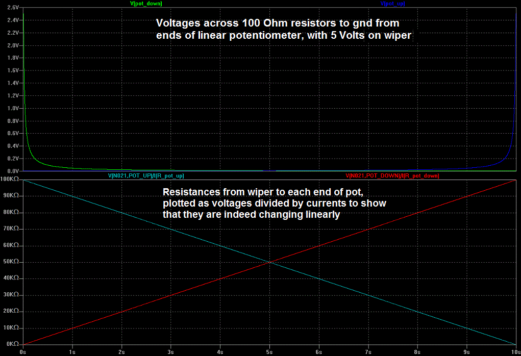

Yeah, string 'em up! <smile> I haven't looked at it but it sounds like an egregious transgression on their part.
Re Q1: Are you talking about the "reversed" (not really "inverse") version, for the other LED? If you have a ramp then you just subtract it from its maximum value and you get the opposite-going ramp. But for the log-like voltages that are produced by a linear pot, you have to put the ramp and the created opposite-going ramp each into their own log-response circuit. But maybe it should be a 1/x circuit, because I'm having trouble getting the shapes to match, using log.
Re Q2: National's AN-31 (among others) has a temperature-compensated log circuit or two. I've actually got the whole thing running in LTspice, with both LED currents being derived from a single voltage source (e.g. a ramp, for testing). Using software instead of analog would probably be a lot easier, for the designer at least.
Re Q3: We could, for example, change the log circuit's resistors (I actually have three of the resistors in my log-generator labeled, in my sim, as "corner tighter", "end lower", and "unflatten"). But I have to say it's been a pain trying to tweak them "by hand", to more-or-less match a potentiometer's responses.
However, the basic problem of getting a lower output impedance and a higher input impedance remains a problem.
