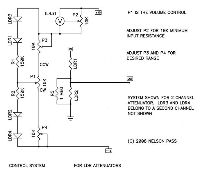

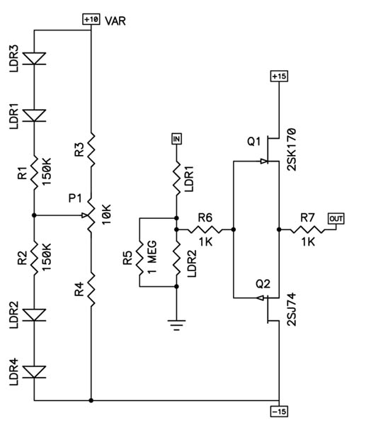

If anyone wants to try a different way of doing things, Nelson Pass spent a bit of time doing different things for the Lightspeed Attenuator a few years ago with no though of monitory gains and had my thanks and others as well.
Here are two ways he did things both had a buffer, I omitted it one of the diagrams.
Please feel free to use them personally, but remember they are protected and do not try to make them a financial going concern, as from what I've read and seen Nelson Pass does not like cloners who try make money on his designs, and he has the legal people to back it up.
Cheers George

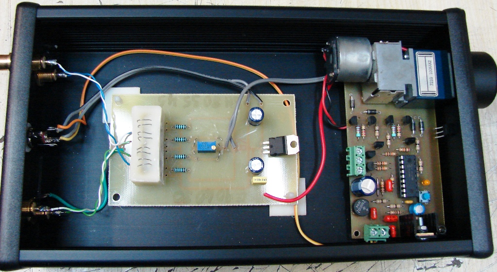

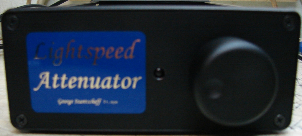

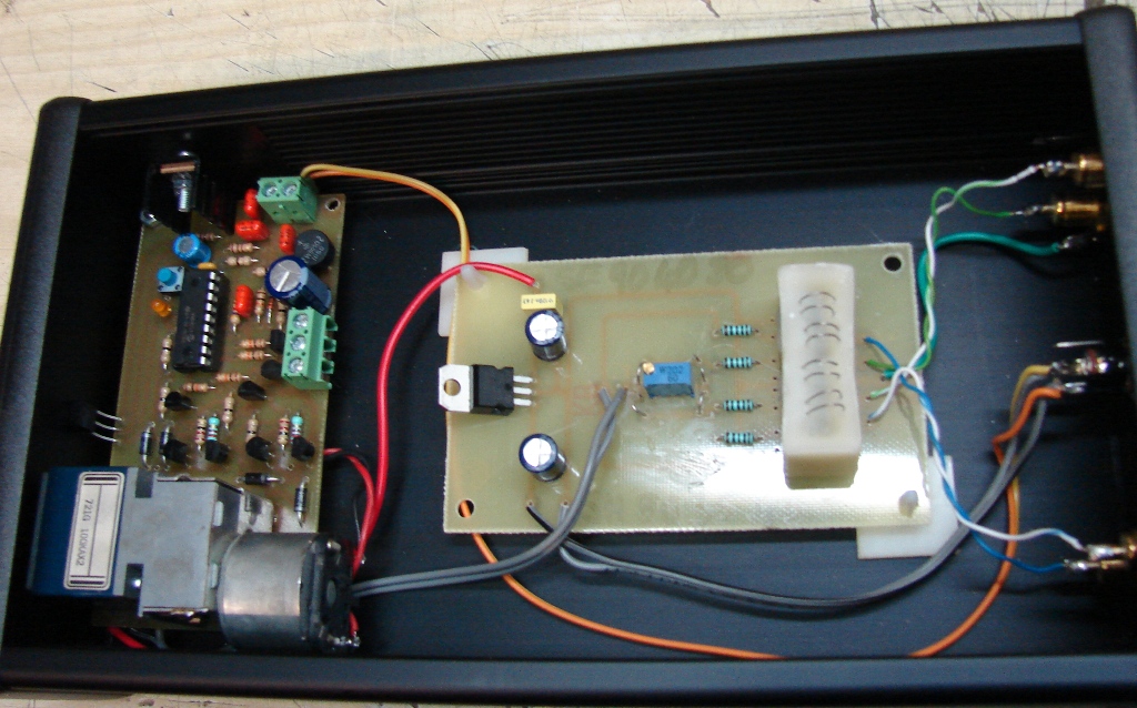

LIGHTSPEED attenuator conversion to remotely controllable unit. A quite easy work, just one 4.5mm hole on the front panel for the IR receiver.
PCB compatible with less expensive motorized potentiometer: BOURNS (Mouser price: 9.5 Euro).
Here the link for a detailed description of remote control unit: http://www.diyaudio.com/forums/analog-line-level/207419-remotely-controlled-motorized-volume-pot.html
Please don't take it as advertisement, schematics and PCB drawings and above all the program code in hex format (to be compatible with any type programmer) are offered FOR FREE.
Thank you!

I think its pretty great and nice for you to provide the code for those that would like to build it themselves. This should work on any Lightspeed, original or DIY, that takes a 100k pot.
Good for me, much better for you! 🙂 The program code and the circuit are of professional level - tried and tested on actual devices 6 months so far without any problem - and may well be used in any commercial product. Anyway, since it was shared free, the code is "burned" IMHO. Despite all this, can be used in any project where the 4 basic remotely controlled functions (VOL+, VOL-, MUTE, STBY) are applicable. The brand and the value of potentiometer does not matters. Here the direct link to the project description and code in HEX:

Thank you George. Oz to Greece distance is just 9 days. Parcel dispatched at 19 March and i received it at 28 March. And i live in north Greece, 600km far away from Athens. I did the modification with each respect to your work as you can see in pictures. I asked the LightSpeed to pass from my hands (it was a good oportunity, Greece is located at the middle of the travel from Oz to Norway) because i needed the case dimensions to draw the PCB to fit exactly inside Lightspeed.
Now the PCB layout is available for any DIYer.
Please feel free to contact directly with me in my e-mail address.
The same of course, for everyone else.
