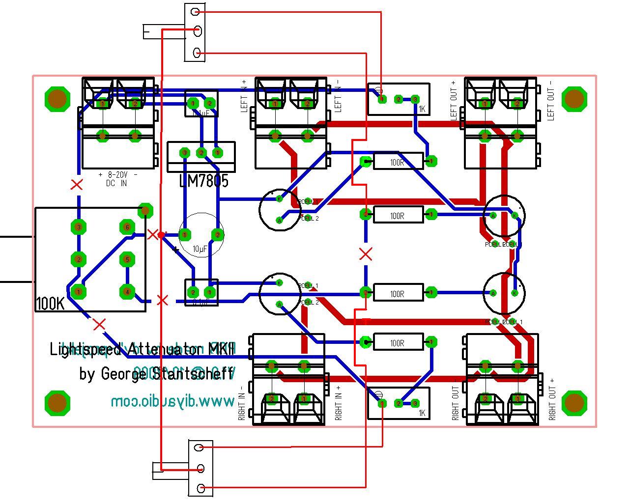

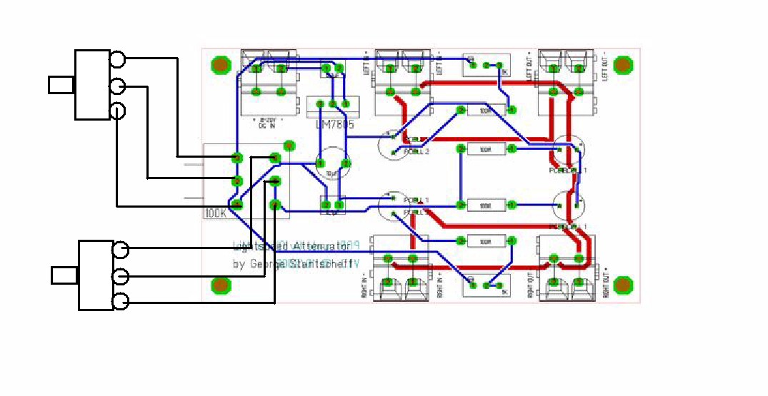

This is much more confusing than just a doing stereo version.
So there is no way of using the single board in a dual mono configuration ?
I believe that is what BFNY was trying to explain to me previously.

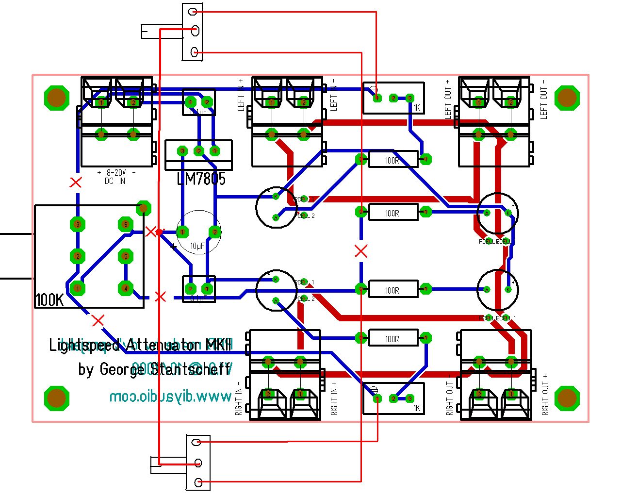

Yes you can but you'll have to look at it closely and cut some tracks. If you post the circuit board only up track side, I will nut it out for you and put on the 2 x single 100k log pots. And post it back up.
Cheers George

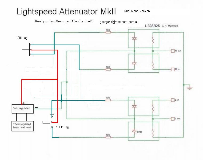

Here it is done quicky, there are 5 cuts to make, and your calibration trimpots are still in the circuit should you need them, if the ldr's are properly quad matched you should bridge them out now that you have L&R volume controls. Like I said I did this quickly so shoot me if there are any mistakes.
Cheers George
