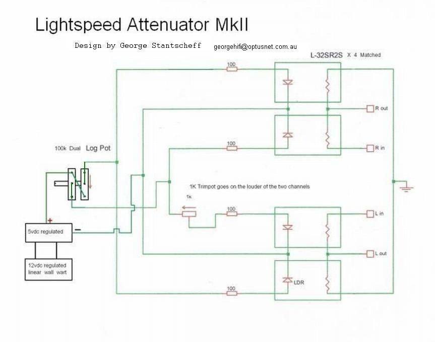

Hi All, I am building a passive pre and heard the lightspeed and was VERY impressed. I am a good and creative builder, but a little lame on the workings of electronics....please forgive. I have heard that the lightspeed needs a certain range of impedance both coming and going. SO, it will be going into a Pete Millete Low Mu preamp then on to 3 amps. For inputs, I have a CD player that goes into a tube DAC, an octal phono pre, music server that goes into the same DAC as my CD, and FM tuner (at some point in time) The tube DAC is the Maverick D1.
So, will the lightspeed work with these inputs and the tube preamp?
Hi djn, the Lightspeed Attenuator in it's purest form, with no buffers or extra series or shunt components, as I have attached, using quad matched NSL32SR2S led/ldr packages.
1: like to have sources (cdp,tuners,dacs, phono stages etc) of less than 200ohms output impedance (which most are theses days)
2: The input impedance of the poweramp should be higher than 47k (which most are) as 47kohms is the industry standard, tube amps are generally higher which is great. Many customers of mine have still had great results down to 33k poweramp inputs.
3: interconnects from the Lightspeed Attenuator to the poweramp should be 1.5mts or shorter and of low capacitance 100pf per foot or less which most good quality one's are.

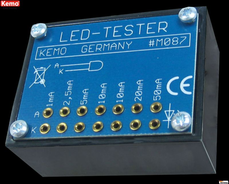

And you can use one of these led testers (attached) and your DMM on the ldr to do the quad matching, $5 at your local Rat Shack or similar.
