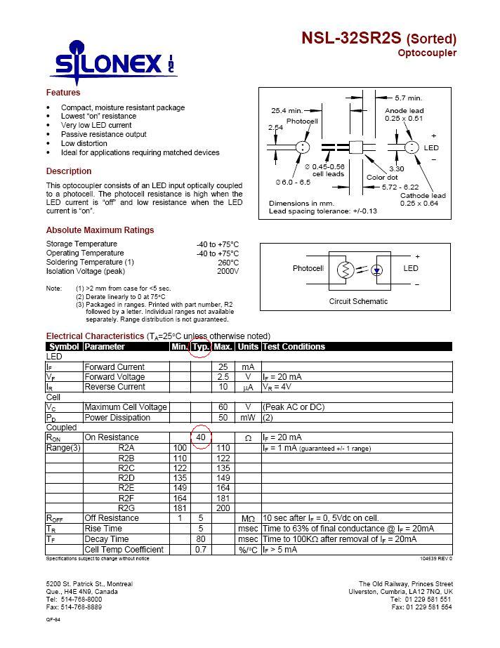

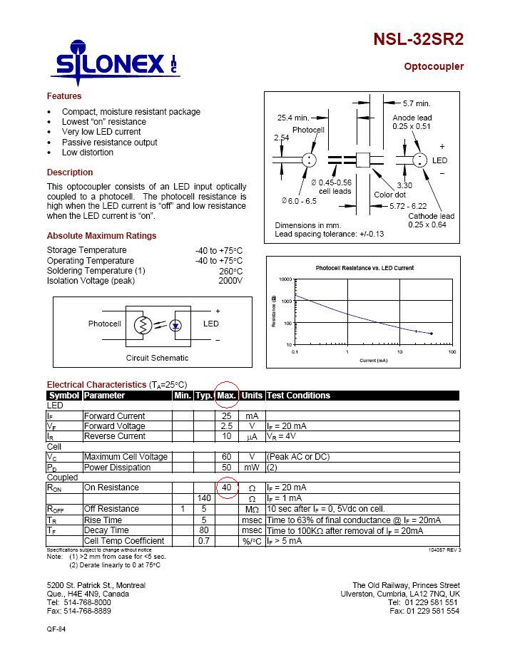

NSL32SR2 needs nowhere near 20mA to hit lower than 40. Did it 12 times today with 12 different NSL32SR2 and only 10mA. The SR2 and SR2S are in fact the same device. After manufacturing some are bagged and some are matched at around 100R to 200R and if they are within 10% of each other they are given an 'S' badge and a letter indicating into which 10% between 100 and 200 they fell into. Also all on the datasheet. However my information does not come to me via the datasheet but from several discussions with the vice president of silonex and their quality control engineer. Obviously I have performed my own experiments on many of these devices. Around 9000 of them now.
Believe what you will, but these are the facts below, and are verified to me by Fred P. Rohrbacher V.P. & General Manager of Silonex a Casco Company, with who I've had many a email disscussion with over the last 6-7 years.

Like I have said all along more times than I care too now (to put it less diplomatically), you will get better lower levels if you use the NSL32SR2S, and when quad matched you will also get better logarithmic feel to the volume instead of nothing at the start till you get to 12 o'clock or too much at the start and can't get passed 8 o'clock. And also more stable impedances which I believe gives a better more consistant sound at different levels also, over the NSL32SR2 or the NSL32SR3. As you have typically 40ohms min value with the NSL32SR2S where the others have well over 100ohms and if anyone pushes these harder than 20mA you will over time end up with a dead led/ldr and that's a given.

Andrew stop trying to twist things, you must have a serious weed up your ****. I stated in post 4358. "This is why I use quad matched sets of the NSL32SR2S, to get lower min volume to get better logarithmic feel to the volume and better channel balance."
The data shows the NSL32SR2S has a far lower typical impedance (40ohm) at 20mA led current than the NSL32SR2 or the NSL32SR3 which are over 100ohms typically.
