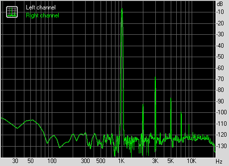

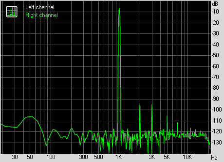

This is your second accusation that I not deserved ... Thus, for the second time here are distortion figures that, finally even without any AP, you could derive by YOURSELF with a good quality sound board... Firstly for the MKI (i. e. R-LDR model) and then for the MKII (i. e. the series-shunt LDR).
As you can see and that it seems to be well known at least by George himself : the distortion of the MKII model is much higher than for the MKI with lot of odd harmonics ! This is probably the reason of the "detailed sound" of this setup...
Please notice the value of 0.255 % THD i. e. the same that I and other (Mr. Pass) had already reported.

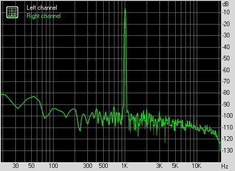

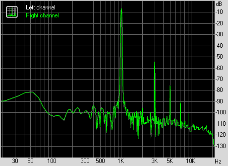

Now the MKII LS model same conditions for the measurements : who must stop "the spit war" now ?...
On the attached pdf, the "Testing Chain" consists of "LDRmkII/7k pot/1.5Vrms in/Att=-24dB"...why is there a 7k pot on the signal chain? Was that pot used to attenuate the 1.5Vrms input signal to about -8dB as shown on the attached screen shot? If so remove that pot and try again...
And at what R values are the series-shunt LDRs set?

I think you gave a wrong explanation of a subjective fact. Me and other think that the subjective improvement of the series-shunt setup is almost only due to the odd harmonics and, moreover, we know where are coming from, these odd harmonics...
I add two other distortion curves at 0dB showing that the MKI clearly generates more even harmonics and the MKII generates odd harmonics... And, again, we know why this is that way !... And this have nothing to do with any "contact issue"!
