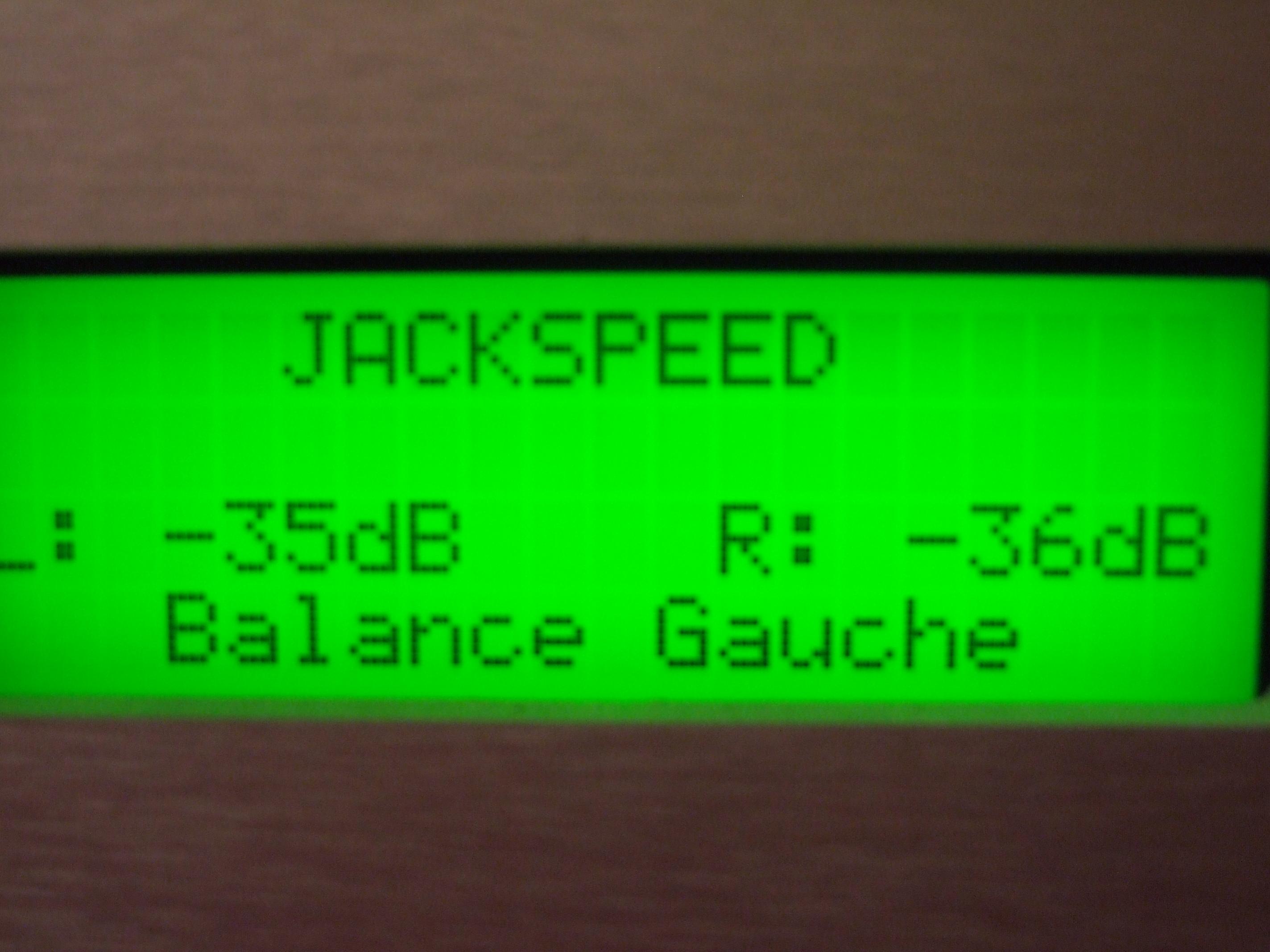

Well, you forget to mention two important things... First the dates of these posts and secondly several other posts not originating from me. I personally think that you aways must go further and not stop on the way. I first listen to the LDRs and then I tried to improve the schematics with another guy. After this second step, we did measurements...
Then again, but I think I'm waisting my time to try to explain one more time this point, the sound of the LDR isn't "bad" definitely, please check my lasts posts. But, for scientific reasons as explained, I think the distortion results obtained by this preamp and the lack of a good buffer are, again in my opinion, not at acceptable levels to derive a high quality device...

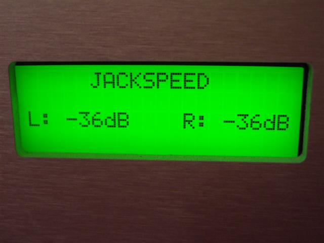

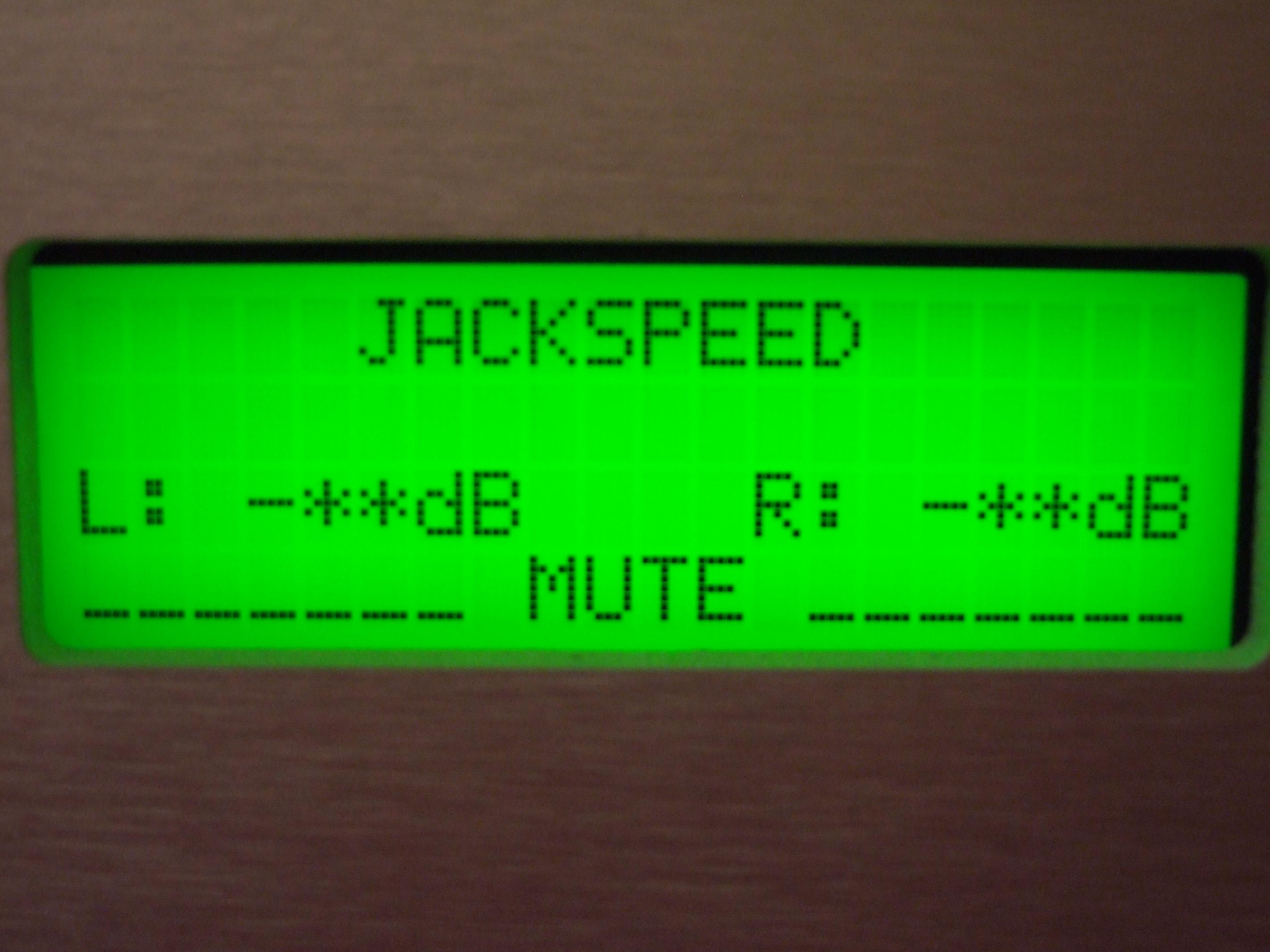

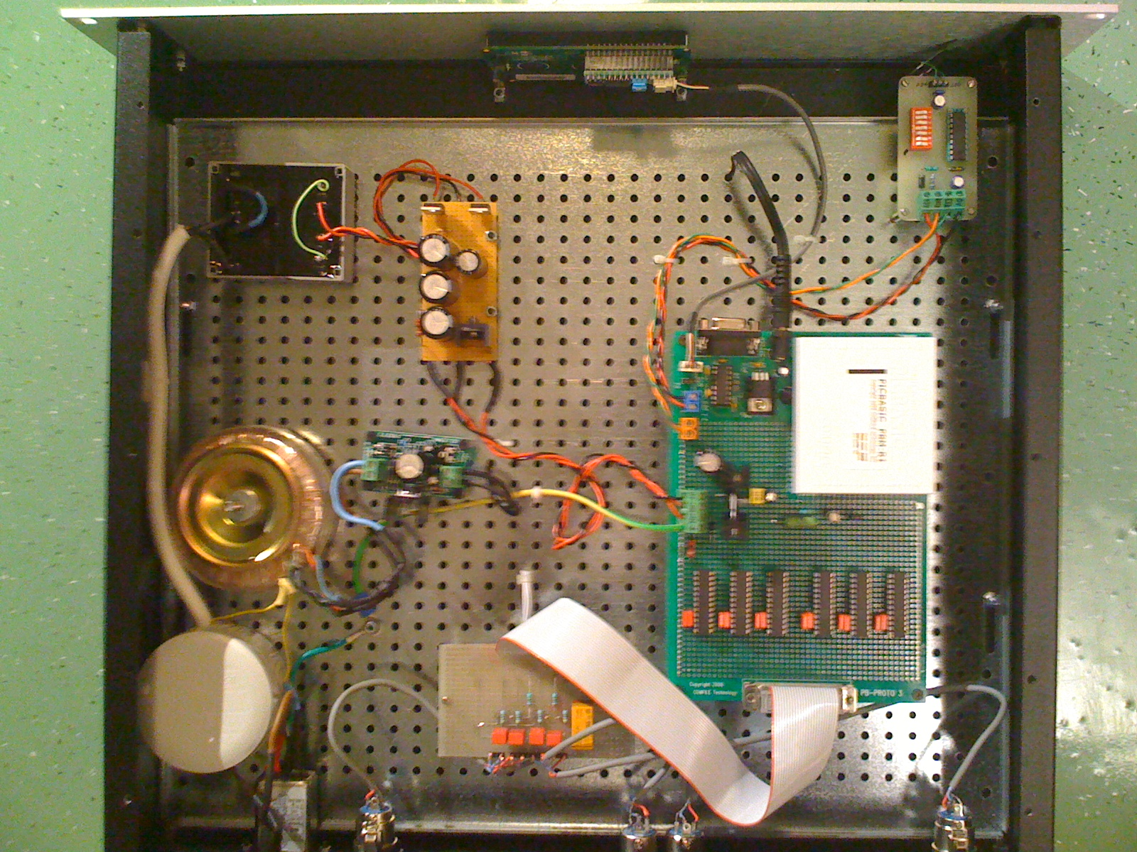

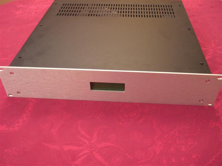

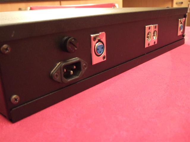

Here some picts of my own design !...

This balanced preamp is of course totally remote controlled with all the functions of such a device (volume, balance, mute, etc.). The control window was opened by a "very high precision water jet cutting system"...
The calibration in this model is totally hand made. In another single-ended version we developed an automatic calibration of the ADCs with different timing selection for the procedure for an hour to... a day !...
As you can see for a 25 dB attenuation, the values of distortion are definitely too high... But it seems others found the same results (M. Pass for example).
I hope I have given enough evidences of our personal work on this project...

I don't understand "ondesx" you asked me many questions on how to match, calibrate etc on your diy Lightspeed like a virgin on her first night.
Yet you know how to drive an "Audio Precision" analyser and measure your results, something does not gel here.

Here are some additional AP curves... The other are too big to be posted. You "don't believe" I have AP measurements... You "Believe" in what your ears tell to you... Believe, don't believe... Where is science here ?...
What do you want now : the serial number of the device ? Some blood sample of the guy who build it ?

I think there are several things you don't understand. But it's the same for me. And it doesn't matter at least. Everybody can learn. And I learn a lot from the time of the first questions. Do you improve your own knowledge on the behavior of these components from the beginning ? Do you made measurements to try to understand what is going on ? I and several other did it. We report here our results. There is no personal attack in these posts. If you just open a thread to hear people saying good things about the project, please write somewhere that on this forum it is not allowed to criticize or report divergent results...
Hope you are smart enough to understand that these are just scientific results. Forget any personal intention. I'm sure this will profit to everyone... I mean even to you !

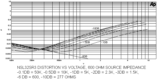

Real Audio Precision measurements you can trust;
Here are proper Audio Precision measurements done by Nelson Pass, which are at worst .1% at full cd output of 2v rms.
Typicaly from a cd source you will get 500mV to 1volt playing cd's and at that level it's down to only .01 to .05% and these are 2nd harmonic which are pleasing to the ear like so many tube pre and power amps, which can give over 1%. And then there's the speakers which are even worse.
Then there's Jackinni's real AP measurments http://www.diyaudio.com/forums/analog-line-level/177332-comparison-light-dependent-resistors.html

Pass LDR distortion results
Does the -0dB plot show that at high signal levels that the added distortion from the LDR is essentially zero%?
Looking at the top -10dB plot. Where it passes 2V, it shows 0.1% distortion. Is this input voltage or output voltage?
