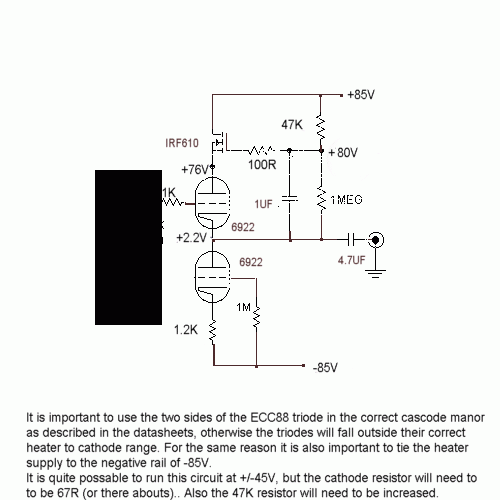

Below is a very low (100ohm) output z for a tube output (Developed by Allen Wright SLCF).
Cheers George
You will know if it is loading up your phono stage too much if the gain comes down in comparision to the line level inputs, which by the way will sound far better than they used to. If it does reduce in gain then you can try some mods to bring the phono Z down to about 1-2k. Then all will be ok.
Cheers George
