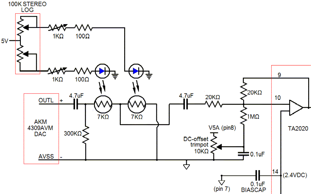

Do I need the buffer? Good question but I believe that this DAC rather high impedance and has 2.4VDC on the output anyway.
Trust me Sir, if I could do without the caps I would! but again, that T-amp has the same bias on it's inputs so I have to block it's path to ground somehow....
Maybe you geniuses (is that a word?) out there could come up with an alternative solution?...I would love to hear one that keeps it simple????😎

Lostcause said:Do I need the buffer? Good question but I believe that this DAC rather high impedance and has 2.4VDC on the output anyway.
What dac gives 2.4v offset, give details about it's ouut stage.
Maybe I should put two caps in there with the lightspeed instead of the buffer? I'll give it a try...I have lots of good quality caps.
The change in impedance may make a big difference, you never know?

It's a PS1 AKM DAC, you can see the name on the schematic. Let me see if I can obtain a shortcut to the PDF....There it is

I have not heard of this dac, but if it has 2.5v of dc offset on it's **** end, it is either a bad design or someone has done a bad mod job on it, or ripped out it's dc bocking cap.

Ah, looking at the PDF you must be missing the caps on pin 11 and 12 (left and right outputs) someone forgot to put them in?

That's the whole point George...I have ripped it out!!😀
They were pretty poor anyway.....
It's just that I am trying...very hard!...to eradicate all things unnecessary from the signal path and the current setup does work well. You do get some slight noise when adjusting the volume but nothing too bothersome as I tend to listen at low levels anyway……That's also why I want to get the impedance matched properly…

You really need to stop the dc offset from the source, otherwise you have a multiplicating effect all the way though with bigger uglier caps later on.
If this must be the way then I suggest.
AKM with good NX black gate on it's output, do'nt forget a say 300k resistor to ground after the cap.
Then the Lightspeed as I've made it.
Then your chip amp with Black gate NX on the input (omit the buffer).

Oh no something must be wrong u don't need the trimpot in the signal path. The trimpot is for ajusting the light level so the two channels track at an absolute level. also u don't need the 2o Kohm serial resistor. Also you can remove 1 of the 4.7 micro caps.

Sorry Michael, you can ignore the right hand side of the schematic as it shows the amplifier it is driving.

This looks good to me Lee, the only question is the drive strength of the AKM, if it is good enough all will sound at it's best using this configuration.
Hopfully the AKM has a low enough output impedence to drive the load that it's now looking at, it's probaly half of what it saw before, if the inbuilt output opamps are of decent quality you will hear a much improved sound, if not everything will sound better except the bass will sound a little weak. Worth a dig.
