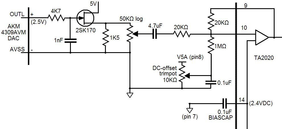

Hi chaps, been lurking for some time now whilst building my new amp and wondered if I could integrate one of these puppies?
From my schematic below you can see that I love to keep it simple (KIS as George puts it)!😀
I have put everything in one box to reduce the parts count and keep the amount of joints/connections to a minimum. That’s why I love the thought of using this idea.
Looking at the schematic of the ‘Lightspeed’ it appears to work in shunt mode, which will affect the gate resistor on my FET whenever the dial is turned. So, my question is… can it be used as a regular volume pot with a fixed grounding resistor and only the LDR’s on the signal line?
I don’t want another Cap in there before the attenuator as I’m just multiplying the number of parts and caps certainly have a sound. I can’t put the cap before the attenuator because the T-amp has 2.5V bias on the input.
I’m only a beginner here so if I’m talking complete hogwash then please correct me!😀

Using just a fixed shunt and variable series element will not give much range in attenuation. You need to vary both to keep impedance fairly constant.
A better place for the attenuator is in front of the jfet buffer. And use it close to the design GeorgeHIFI has kindly posted. This works, and works real well.

Hi George, thanks for the reply although I'm not sure that I can put it in front of the buffer due to it using the 2.5V offset from the PS1 DAC as it's input bias.?
To get rid of the turn on pop I implimented Nick's soft start circuit:

Not knowing this chip amp, but looking at your circuit I would just sub the 50k pot (which is series shunt anyway) for the Lightspeed as I've designed it, the only thing is how much dc offset is present on the output of your buffer? if over say 10mv then i would have another 4.7uf before the lightspeed, with it's input of around 7k this then will give a -3db point of 4.8hz which is fine, use a good polypropylyne or Blackgate NX though. same for your existing 4.7uf after the Lightspeed.

georgehifi said:Not knowing this chip amp, but looking at your circuit I would just sub the 50k pot (which is series shunt anyway) for the Lightspeed as I've designed it, the only thing is how much dc offset is present on the output of your buffer? if over say 10mv then i would have another 4.7uf before the lightspeed, with it's input of around 7k this then will give a -3db point of 4.8hz which is fine, use a good polypropylyne or Blackgate NX though. same for your existing 4.7uf after the Lightspeed.
Cheers George
Thanks for the reply George, the LDR's don't like DC then?
No issues on the caps, I have some very nice polys😉
