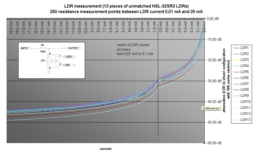

I have developed a µC circiut to digitaly control a current source and to measure the resistance of LDRs for matching purposes. See measurement details in the attached file. The Pot-Solution (100K log) to adjust the current of the LDR's is not very comfortablemm, because it is to sensitive. So I will do that at a later point with a µC including remote control and fixed steps for attenuation.
Conclusion of measurement: to match the LDR's 2 or 3 measurement points are enough, because the progression is always near the same. If you are comfortable with channel accuracy of arround 1-1,5 dB you only need a few LDR's to match them. For multichannel purposes or accuracy of 0.5 dB you have to measure much more pieces to find matching pairs.
Arne
Arne

I have done a similar measurement for 25 unsorted SR3s, using a triangular wave function generator through a BUF634 buffer to drive the LED in series with a 560R resistor. One channel of the digital scope was connected across the 560R resistor, to measure LED current, the other channel across the LDR itself, which is connected in series with a 10k Caddock MK132 to a 5V battery supply, to measure attenuation (voltage).
Results are similar to yours.
The good news is, the resistance goes down to about 60 ohm, as stated on the datasheet.
The bad news is, if you want 0.5dB match over a range of say 5k ohm to 100 ohm, we only managed to find 4 good pairs, no 3's, quad's, ...... So for a set of 5, I would recommend measuring at least 200 (Similar experience with MOSFETs).

> I agree with you that you have to measure a lot to have 0,5 dB pairs, but 200?
My experience with MOSFETS -- 25 pcs and you are lucky to get 2 sets of 4. 200 pcs I got 4 sets of 12, many sets of 8s & 6s. Only need to throw out 4 (out of 200) for regulators and what not.
LDRs are similar, in a way.
If you want say 2 sets of 5 matched to better than 0.5dB over range, I would not take less than 100. Of course you might well end up with many more 4s and 3s and 2s to offer here on the Forum.
Microprocessor is the best way out, in my opinion. You can match to 0dB, or resolution of your measurement equipment.
Auto-calibration is not as simple as it sounds, as the ADC in the uP limits your resolution at high attenuation. I personally would still stick to a high precision miltimeter.

> so the cpu can switch itself off when not changing the volume, which would make less noise.
No, that is not what I meant. To do autocalibration, I was thinking that you would send a number of discrete voltage from the uP out to drive the LED in the LDR (via a resistor), and then measure the resistances of the LDR in order to map the characteristic curve automatically by using the ADC of the uP. The problem is that while your attenuator wants to be a log device (say 0 to -50dB), the DACs and the ADCs of your uP is linear (say 8 bit). So at the low current or low resistances end, you have poor resolution, and hence low accuracy due to quantisation. A multimeter with autorange, on the other hand, would have little problem covering say 50 ohm to 5kohm with 4 digit resolution. But once you have mapped, you could store the transfer function in a look up map, and then you know how much voltage would would need to drive the LED (with serial resistance) to achieve what resistance at the LDR.
So you see why I said for some, it is easier to match 200.
But I am sure one of you guys can knock up some Atmel Assembler codes in no time. So I am awaiting with great interest.
> About the sound quality : have you tried with a high quality buffer after the LDR stage ?
Not that far yet, but we never intend to use them purely passive. Either with a gain stage, or a complementary JFET follower, a la Curl. Or simply a BUF634 if you are lazy.
Patrick
uc's aren't that hard and you can program them in C using free open source gcc and the atmel IDE is also free.
I agree you need more than 8 bits precision which is why I suggested a cheap 16-bit sigma-delta type ADC.
You could also build the ADC in software using a comparator and counting the time it takes to charge a RC network. By wiring it in the right way you can linearize the log characteristic. It would be megacheap.
Autocalibration will compensate aging.
Also I don't like passive preamps because amplifiers like to have their input stages well balanced, which means the impedances on the + and - inputs should be equal, which is very difficult to do without buffering.
