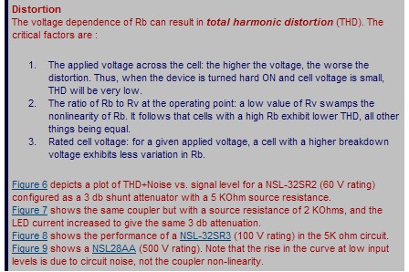

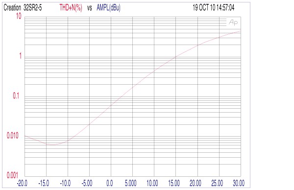

In these figures and graphs that are posted they are talking about input voltages of 60 and 100 volts, for the distortion figures to become significant, the higher the volts the higher the distortion and this is only happens when the LDR's have been turned on at their hardest, either at max volume or at zero volume, and it's second harmonic in nature which as we all know with Triode SET amps can be very pleasing to the ear, sometimes giving 3% second harmonic.
It's all a mute point as most of us are feeding CD level at 1 to 2 volts and the volume will hardly be at max or min, and even if it were, a little second harmonic is very nice to the ear.

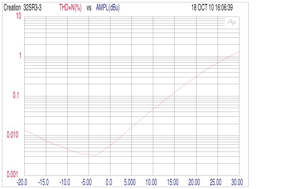

I'm not trying to turn you guys away from bulk buying the NSL32SR3S instead of the NSL32SR2S, it's that I think you need to sample them before outlaying big bucks on a bulk buy on ones that haven't been tried yet, you see the off resistance is 25megohm for the 32SR3 and only 5megohm for the 32SR2, this itself looks to me like it could be disaster to be able to match and get both channels to track. As well as the on resistance is is also higher (worst case 3 x higher) and may not go down to an exceptable minimum level.

I think we can agree that the region of interest is between 0.2V to 2V, which converts to -15dBu to +6dBu (?).
Even in the case of a passive preamp without buffer, if your power amp has a JFET balanced input with lowish capacitance, you can live with 22k input impedance without problem, IMHO.

Patrick, do some serious looking at the dark and light max and min resistances, you will have trouble getting even close to your wanted .5db channel match.
I would hate to see you and others on this thread get burnt bulk buying these, and find you cannot channel match them. I,ve played around with the Lightspeed now for some 30 years i know what to expect, imagine the same dual stereo potentiometer thats log at 25megohm, then you'll have an idea about channel maching with these, it's hard enough with the 5meg NSL32SR2S let alone 25meg. I've said enough, and leave you to your own peril.
