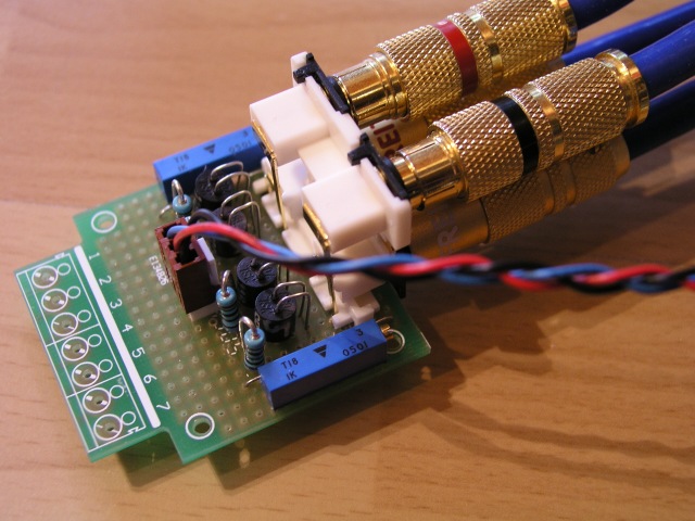

finished my Lightspeed Pre yesterday. Im am also very satisfied with the results. Very good detail resulation and absolute noiseless. As far as I can say after short testing: Better than my 24 step attenuator.
G o o d w o r k G e o r g e !!! THX!

WOAH! looks pretty small i was totally expecting say larger. Humm Now i should order parts i think to test one out.
Nice work there Arne, very compact, should fit into a matchbox nicely, hope your going to box it up with a power supply, as some of them the ends are not 100% light tight.
If you shine a torch on them some can read the torch light. When you've had some more listening give us a bit more critique on the sound?

Also. pics of mine are shown on post 100 and 101.
