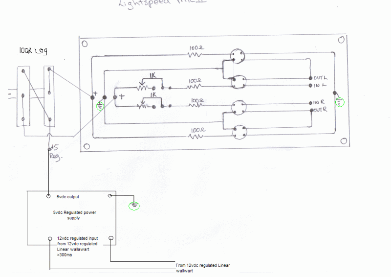

Hi George,
Connected the schematic as shown using a 100k volume pot, but the it appeared not to work.
Some symptoms:
1. I'm using a 5.39V source, which when the volume pot was at either extreme, dropped to 5.36V. I sort of expected that it would drop to 0V.
2. I did not connect the ground of the LDR's to anything in the circuit
3. The 1k pots were set at 400 ohms.
Any idea why this did not work?

Hi Dr H, you need to gound the - of the 4x LED's to ground and also the ground or - of the 5vdc/reg power supply and one side each of the shunt LDR's x2. I've quickly redone the circuit of it so it is a bit easier to follow, and marked the chassis/rca earth points, also make sure that each section of the dual pot is wired and works opposite to each other.

Still no luck. Even with the ground connected as shown.
Two questions:
1. When using 1mA current for matching LDR's, what sort of resistances do the LDR's give? In the megaohm range? I was expecting lower numbers.
2. The volume control is used to change the voltages to the LDR's. When the voltage from one gang on the pot reads 5V, what should the other read? 0V? In my case, I'm using 5.39V input and the lowest voltage I get is 5.36V, not zero.
Thanks for any input.
Ryan

Dr.H said:Still no luck. Even with the ground connected as shown.
Yes they work opposite to each other
That voltage is a bit high, are you using a 5v regulator?
If so
I'm afraid this saying to me that you have blown the LED's, I hope not for your sake, as this renders the 4 X ldr/led packages useless, the LED section in the LDR's are extremely delicate if abused in the slightest way. Are you sure it was wired exactly as per my diagram first time it was powered up? Are the 4 x 100ohm resistors in place?

Sounds to me like you have connected your pot's wrong or that they lack connection to ground. Try to measure the pots without the rest of the circuit
Edit: Sorry - just looked at the circuit again. Since you have very low difference from 0 ohm and 200k in series, then the path is surely broken somewhere. If not in the resistors, the wires, or the PCB then it must be the LEDs.
Check the resistors, PCB etc with an ohm-meter.

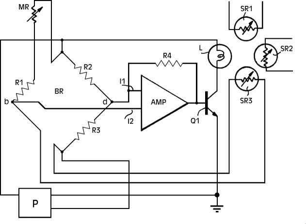

Matching LDRs
Interesting idea from Audio Asylum poster on how ensure close matching of LDRs in the passive:
http://www.AudioAsylum.com/forums/tubediy/messages/116896.html
Posted by Istanbul Wasconstantinople
Use a pair of LDRs and an opamp.
One LDR is for the volume control and the other is a reference. You feed a control voltage to the op-amp which measures the voltage drop across the reference LDR and adjusts the lamp voltage to both LDRs accordingly.
Provided the LDRs are in the same environment, this will compensate for temperature drift and nonlinear light response of the LDR. This should suffice even if the LDRs aren't perfectly matched.
Note, LDRs are not as linear as regular resistors. The impact on sound quality is unknown.
IIRC, this idea came from Melos.

Matching LDRs Post #357 Interesting idea from Audio Asylum poster on how ensure close matching of LDRs in the passive:
a bit like this
US Patent 3,983,421 Yogore
Sept 28 1976 Remote audio attenuator
Regards
James
