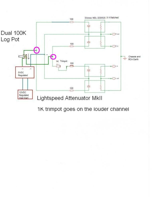

woodturner-fran said:Its been a looooonnng time coming, but tonight I soldered up my version of Georges lightspeed.
Well, the good news is there was no smoke!!!! The bad news is I think I have the pot laid out backwards. Can someone do a double check for me here.....
That has to be the wrong way around doesn't it?
Damn I double and treble checked that when I was doing the layout!!!

Good for you, if you have a backwards operation of the volume control just reverse the two conections circled in pink attatched.
Cheers George
Many thanks George.

Ok... its me back again for more help!
Got the pot sorted out, reversed it and ran wires back to the board. All works as it should now.

Okay guys.
AndrewT suggested that a single gang 1/2W pot might not cut it and could fry. With the circuit the way it is I think max power that could go through the pot is .5W but his argument is that only 7mA is allowed. Something about they are only designed for .25W at higher voltage lower current.
Well, my idea is to then remove all those 100Ohm resistors and put one 680R in series with 5VDC before the pot, not after. The LDRs really dont gain any noticeable resistance til about 1mA anyway so limiting the entire circuit after that resistor to ~7mA doesnt bother me.
Comments?
Uriah
Comments?
Uriah

Using two mono pots is fine. I did that with my first one. Its fiddly when you want the stereo image in the center but you do get used to it fast. Still fiddly though.
Each LDR uses up to 20mA then goes ffffftt! Thats what the spec sheet says. I have had customers who poofed theirs and while experimenting I have poofed a few but I have also given plenty of them more than 20mA, however its my opinion that this ends up changing their resistance curve. In general they are operating at under a milliamp. Way way way under.
Uriah
A 1/2 watt pot ought to be fine then 🙄

If I throw a 680Ohm in front of the main pot it wont overload. I dont think it ever will anyway especially since the minute I turn it up at all the current through either side is under a milliamp.
