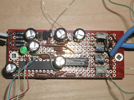

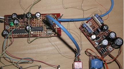

now built the VCCS
I used LM317L as CCS(8ma) instead of the JFET, and use LM336-5 instead of the middle TL431 for 5V reference. The balance control works great.
With SR3, Zout is around 2-4K. Zin is around 20K-100K when using -20 to -30db range of the DS1802. Probably need to put a serial resistor (1K) from DS1802 L0/L1 to 3.3V to better utilize the -50db to -30 db of the digital POT. Right now I have to click 30-40 times to the volume I need.
compaing the VCCS MKII and CCS MKI
VCCS is more vivid (bigger sound stage) and CCS MKI with TX2575 is more refined (sometime more details).
Both are great, it's better to keep both and switch between different music.
