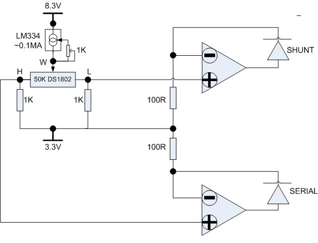

VCCS with constant Zin
Original VCCS has variable Zin, it reaches lowest Zin in the middle of the wipe and higher when moving away from middle.
Hopefully this design would work to get constant Zin.
Adjust CCS for Zin range, with 0.1ma, the current over LDR is around 0.02-1ma, so for SR2 it's aournd 5-7K, for SR3 around 20-30K.
Maximus, any comment? I think 0.1ma should be fine for DS1802 and 1ma output fine for OPAMP direct drive.

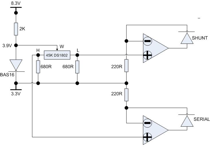

Diagram in #2262 is wrong, should use Volt ref instead of CCS, current range over LDR is 0.03-3ma.
The idea is to keep current over DS1802 wiper lower than 1ma, and use OPAMP to get 3X current output.
Say R is the resistance between W and L of DS1802, the current over LDR shunt is in ratio of 0.6V/(R+680) and over LDR serial is in ratio of 0.6V/(45000-R+680). Expect in certain range resistance/current over LDR is linear, so Zin should be in the ratio of (R+680)/0.6+(45000-R+680)/0.6 which is a constant value.
Any better idea to get a 0.6V or lower volt reference?
Have you tried this?
Here are my naive comments.
I get approx a 1.5V drop over the LED. I dont know how .6V would get the LED to flicker. Maybe though I havent tried it.
.03mA may be to high. I get them to work with .00001A and less but I cant measure lower. Anyway, sure it would work but you might not get as much resistance as you could. I have an odd batch of LDRs that are reacting to extremely low current and this is not the norm but my last batches were tested with .000125A which was only at 40k in series with the voltage.
What if you switched it around a bit and ran the current output of the opamps into the DS1802 instead of through the DS1802 first? You could get high and extremely low current.
Also, you get lowest distortion with 2.5V over the LED. Thats somewhere on the Silonex website. Distortion is low anyway though.
Just comments let me know if I am full of it.
Uriah

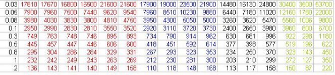

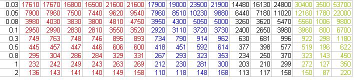

0.6V is to make current over DS1802 less than 1ma (maximum according to datasheet), the OPAMP control the current over LDR (amplify 3x times) by adjust the voltage over LDR, I am gonna use 0.03ma-3ma to get 20K pot with 40-50db.
By the way, I just got 3 pair match perfectly and another 2 pair matched in 10% from 16 SR3.
I am using CCS to test the LDR, with LM334 and 10K variable resistor.
Two of your pairs would be great, one of them would not make it into my pairs, but I am super picky and that is a great percentage out of 16. Well, if I wast testing out of 16 I would definitely take them all 🙂 Awesome percentages. I have to build an LM334 circuit when I get home. On vacation right now.
So are you testing one at a time or how many?
I have to build one with SR3 to hear the sound. I wonder if its the same resistive material as the SR2.
Uriah

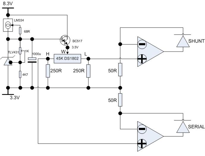

Combine VCCS and CCS version
I was testing 4 pairs at each time with 15V supply, 1K resistor in series to monitor the current (only get one DMM), should test 16 together as it's a pain. Have to pick up close pair from excel chart, then match together again as even 0.001ma can make pretty big difference.
Here is another diagram I am thinking, the 250R can be lowered to make the adjustment range bigger, with 250R it's around 44DB, with 680R it's 37DB. Adjust the 1K pot for Zin.
I am going to build the CCS version first then this one as it's more complicate. I like the DS1802 balance control so I can use those 10% pair (1db difference?) as well.
