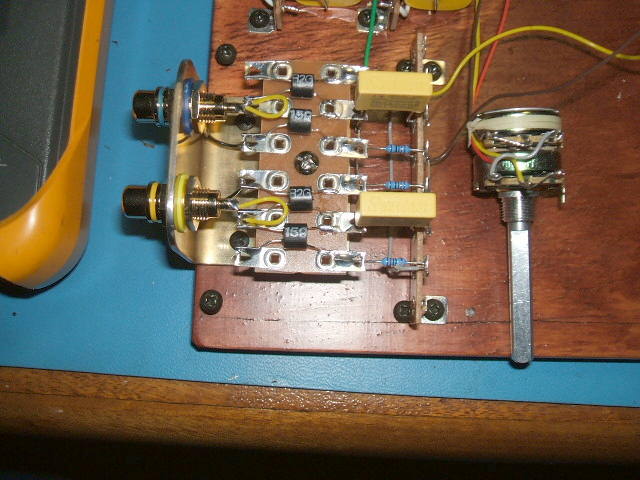

I would also like to thank George very much for sharing his work. I am in Australia and bought 10 LDR's (sorted) from Crest Components (Aus), cost AUD$70 delivered. There was an extra $20 charge because I didn't meet the minimum order, so cheaper for more, but I didn't want more. For initial matching I used one DMM on diode test function to get a Vf and another DMM to measure the resistance, then went from there using the 100K pot at 9, 12 and 3 o'clock, (as George advised) looking for close pairs for series positions and close pairs for shunt positions, then pick the higher resistance series and shunt for one channel and the lower resistance series and shunt for the other channel, aiming for the most consistent voltage divider basically. Then I built it without the trimpot, ran 5V DC through both attenuators to see which channel needed the trimpot, put the trimpot in, adjusted up very nice, the calibration came out much better than expected. (I have a scope and sig gen, but was time limited and hoped the DC test would be good enough, with 5.00VDC input the range of output was 2mV to 4.99V).
So yes, I agree guys they aren't really matched very well at all, but it doesn't have to be rocket science either. Of the 10 OC's I got, there was a group of 5 reasonably similar and another group of 3 reasonably similar and the other 2 just way out there on their own. George's circuit works great, which could have taken any one of us weeks and/or months of tearing our hair out to get right. I don't have any probs with sound not going to zero, I have to turn it up a bit, due to lowish output NOS DAC. I can't really comment on the sound improvement unfortunately since I built it up with minor power supply mods on the DAC, but the end result is the sound is now cleaner/clearer and with deeper bass.
Good luck guys. Thanks George! I owe you one! Do you still run George HiFi, that was around in the early 80's in Sydney city wasn't it? I remember that name but it was 25 years ago...
Ian.
A pic of a tagstrip version, no trimpot fitted yet.

Your use of solder lugs look very neat
But if you want absolute optimum result I think the solder lugs could be an issue 🙄
But may be placed with the "magic stones"
