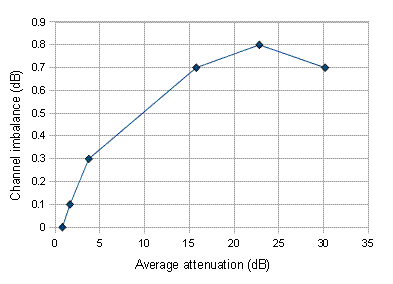

Collated results:
Low
Left: 30.5dB Right: 29.8dB
Low/Medium
Left: 23.2dB Right: 22.4dB
Below medium
Left: 16.1dB Right: 15.4dB
Medium
Left: 3.9dB Right: 3.6dB
Above medium
Left: 1.7dB Right: 1.6dB
High
Left: 0.8dB Right: 0.8dB
Interestingly, a bit of fooling around on a calculator shows that channel balance can be improved a lot just by adding a 100K resistor in parallel with the left series LDR. That obviously only applies for these specific LDRs, but it suggests that it may be possible to tweak individual attenuators very nicely if space is left on the PCB for a few optional resistors.
Pic below shows the raw results (without the 100K resistor).
Collated results:
Low
Low/Medium
Below medium
Medium
Above medium
High
Thank you, Cheers/ Chris

I wonder if this relatively good channel balance is the result of current driving or some other perchance good luck?
Or is it because we can't see the balance @ -40dB and -50dB and -60dB?
Is this another Turing test?
Not at all. I may be a little stoned right now as I was looking at one of BudP's threads last night and the effects tend to linger, but it does put one in a more appropriate state of mind to appreciate this sort of thing.
Alchemy and mysticism aside, no effort is being made here to equalize the LED currents between channels so luck and/or device matching, I guess. If I was building an LDR attenuator, I think I'd be happy if I could get 40dB control range without seriously compromising anything else.
