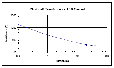

With Iccs set to 65mA, how high can the current go through either LED?
Hi Andrew,
The current is divided over the LED's. The amount of current flow trough the LED's is dependent on the setting of R6. If R6 is in it's middle position the current flow through the LED's would be Iccs/2. If R6 is at an end point one LED will get almost the full 65mA, and the other LED will receive 1.565uA (according to spice). In other words, one would be conducting fully and the other one would be switched completely off in that situation.
@ lechuck:
I think a fundamental problem with your circuit is that the sum of the LED currents is constant. When the volume pot is 1/2 way, they will each have 1/2 of the maximum current, resulting in both photocells having very low resistance.
A better approach may be to control the 2 currents separately, making use of the exponential nature of transistor's collector current vs base-emitter voltage. Then, for example, if it's set up for 0.1mA per LED when centered, then increasing Vbe on on side by 60mV and decreasing it on the other side by 60mV will result in currents of about 0.01mA and 1mA.
It should be possible to track quite accurately if a well matched transistor array is used (and opamps with low input offset voltage for the control circuitry).
