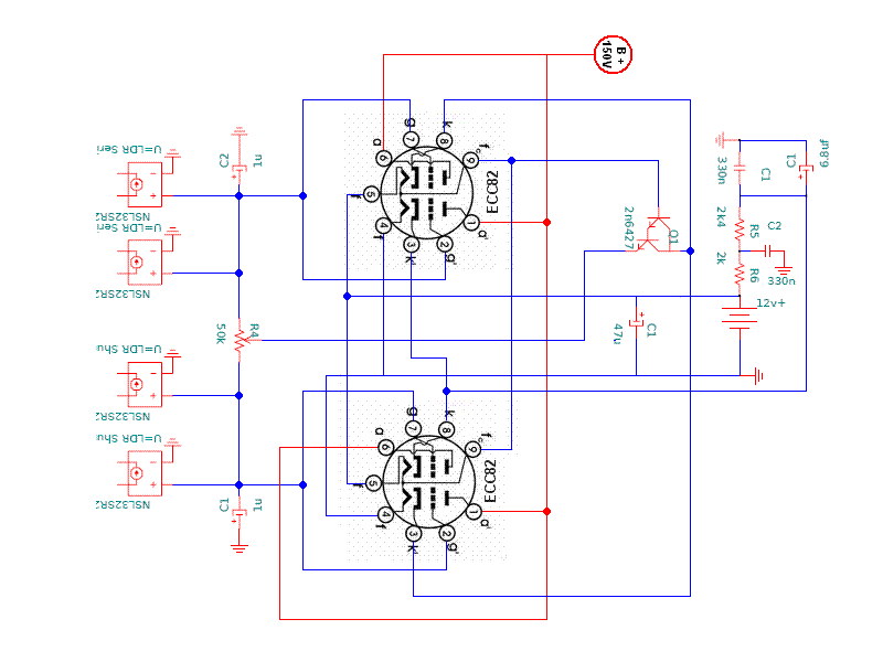

Sorry, but your circuit seems to be missing links or somethimg - can't figure out where the current from the strange C-muliplier (?) powers the circuit, and if the 50k pot distributes the current to the leds, what do the ICs actually do?
Also, could you turn the upside down parts of the circuit up the right way - might make it easier to understand it's operation.
There was a lot of heated discussion about his circuits earlier in the thread. Let's just say that Chris likes to use opamps in [ahem] highly unconventional ways.
This is actually the least bizarre circuit I've seen in this thread so far. If you think that's a wild claim, have a look at the circuit in post 3, for example.
Yeah Godfrey, seems like an exercise in a SIM program, like the guys used to do with those craziest series regulators that were never worked well in practice.
At least with Uriah's (LighterNote) , Paul's (CCS & remote), Alan's (W/speed), ZenMod's, etc, there is a clear current path to follow and each cct advantage can be seen -
Here, not sure how the ICs function - current buffers?, current sources?
What's the advantage/improvements of the extra components in the power supply? Something new?
The advantage of this method is to provided approx 2ma from the base of the darlington to the shunt op amp V+ that then controls the total current maximum varied by the potentiometer to the shunt and series LDR anodes.
Thats all the current that is needed in this configuration to then arrive at input impedance of 10- 15k.The small amount of current provided is much kinder on potentiometers.
The quest is simplicity with excellent L/R channel difference.
Cheers / Chris
"Providing current from the base of the Darlington"
On Planet Earth we take current from the collector or emitter of a Darlington, but on Chris's planet you can take output from the base of a Darlington? I guess this fits quite well with taking output from the input pins of opamps. Consistency is a good design principle!
It works well, delivering current to the shunt op amp, whereas the emitter feeds the series op amp. Current then is no more than 2ma. Try it and see.🙂
Cheers / Chris
What a great idea!!! You mean something like this?
Channel balance should be superb with the midpoints of the heaters tied together, and used to bias the Darlington. Current control to the Darlington is regulated by two of the cathodes, while the output of the other two is nicely smoothed by the RC filter.
It should sound wonderful, I can't wait to build it!
